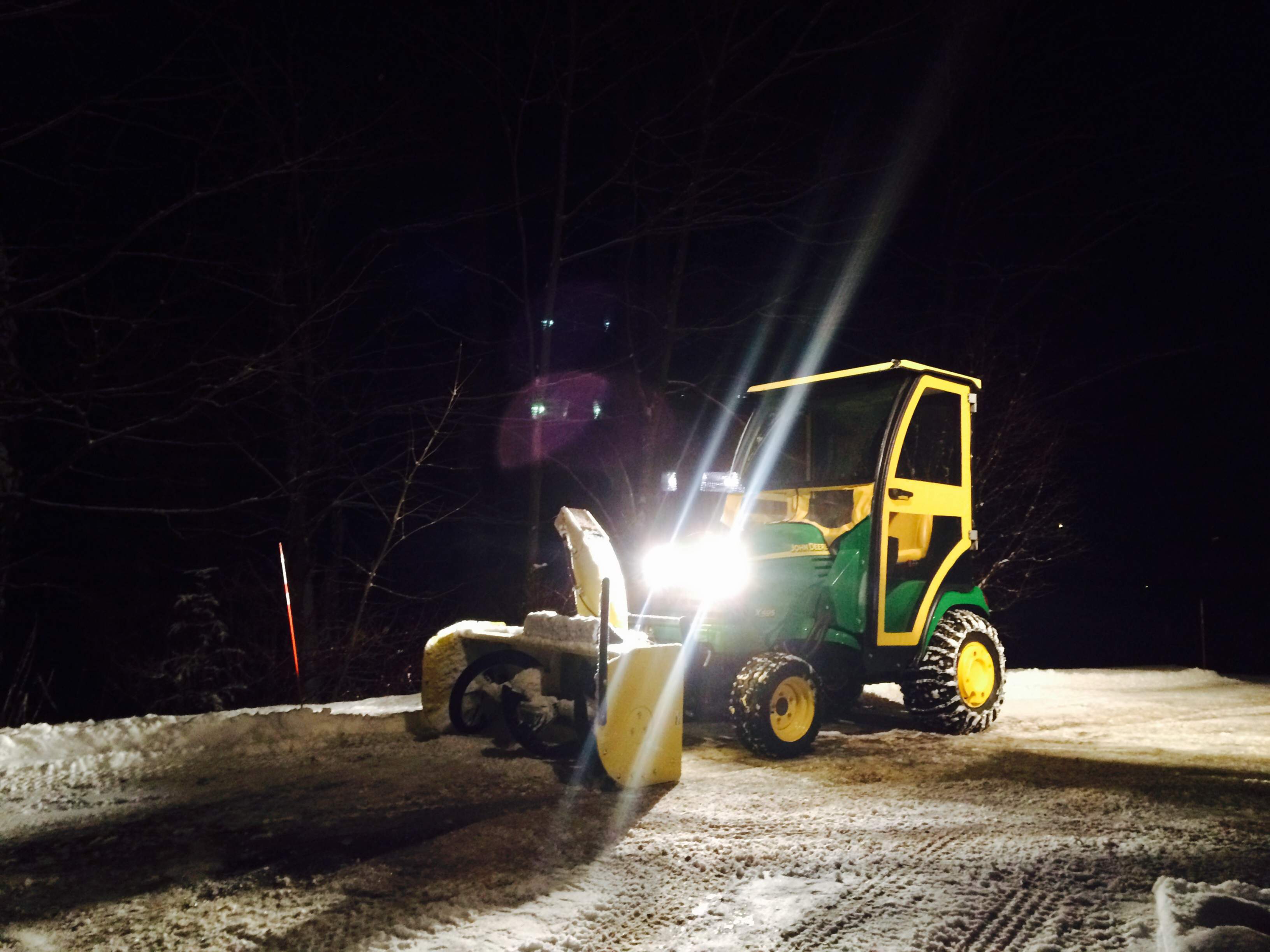

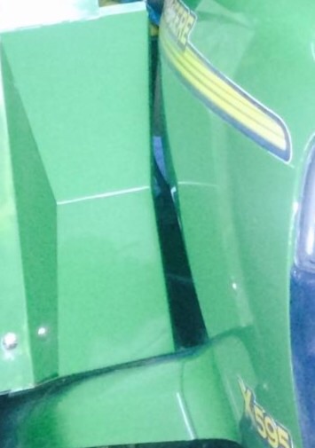

I purchased a 2003 Deere X595 this fall, and it came with a Curtis cab. The model numbers for the cab are BM21481 and BM21482...yup, it lists both on the tag. My question is in regards to the approx 2" gap between the hood and the cab above the floorboards, where your shins would be. I think I attached a pic of the gap (and an action shot of the whole machine...just because :)). The gap is a little larger then it appears in the picture. Does anyone else have this cab on a similar machine, and am I missing some parts that would normally fill this gap? I'm not above cutting some sheet metal to fit, but wanted to see what the factory intended.

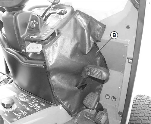

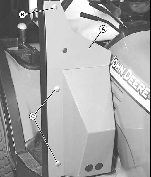

Here are a couple pics out of the manual showing your gap, and then the interior trim piece that
is supposed to cover it . they are nice cabs, but not airtight by any means....

I think I'd try some foam pipe insulation, as I assume the gap is to allow the hood to be opened.
But looks like a nice cab, just not able to remove your boots and go barefoot while blowing snow.. :D
