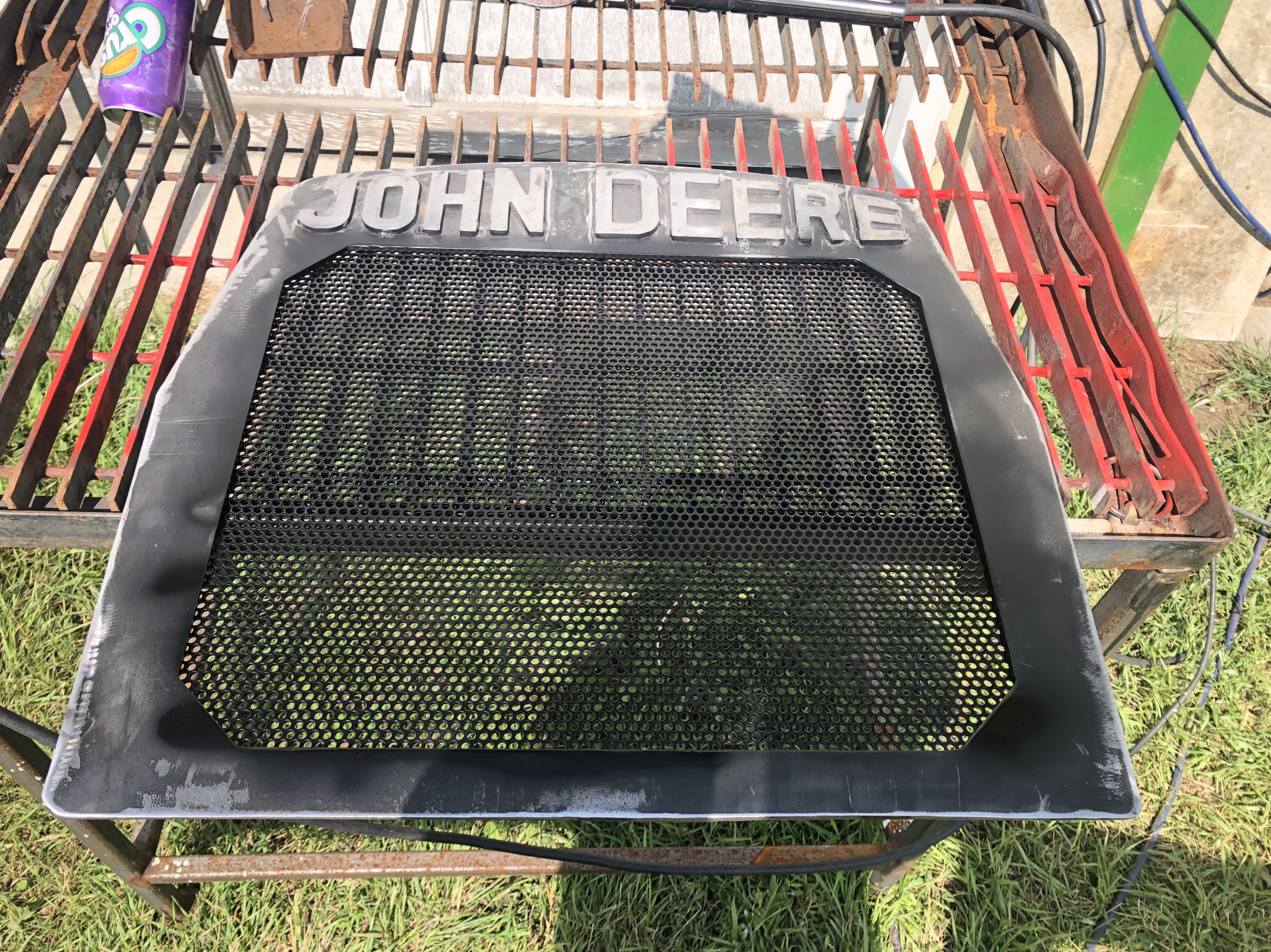

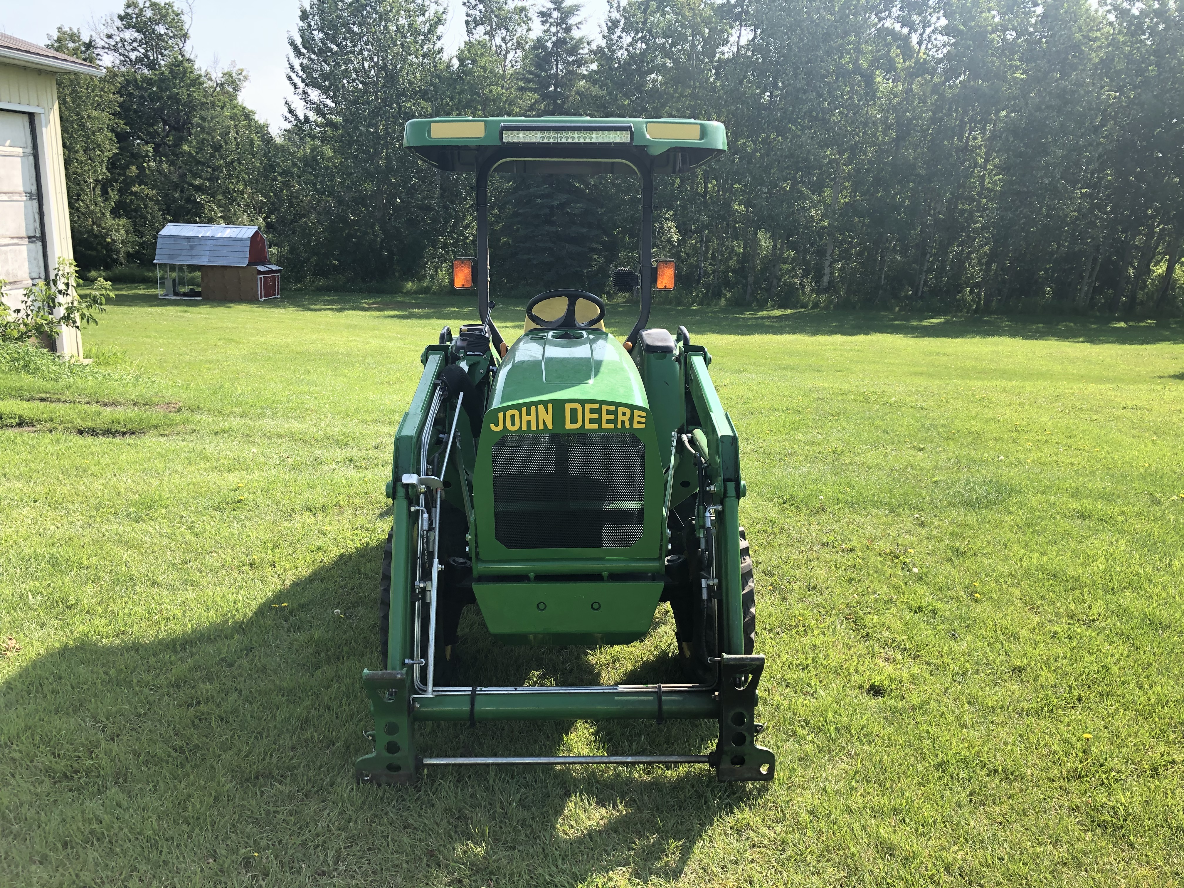

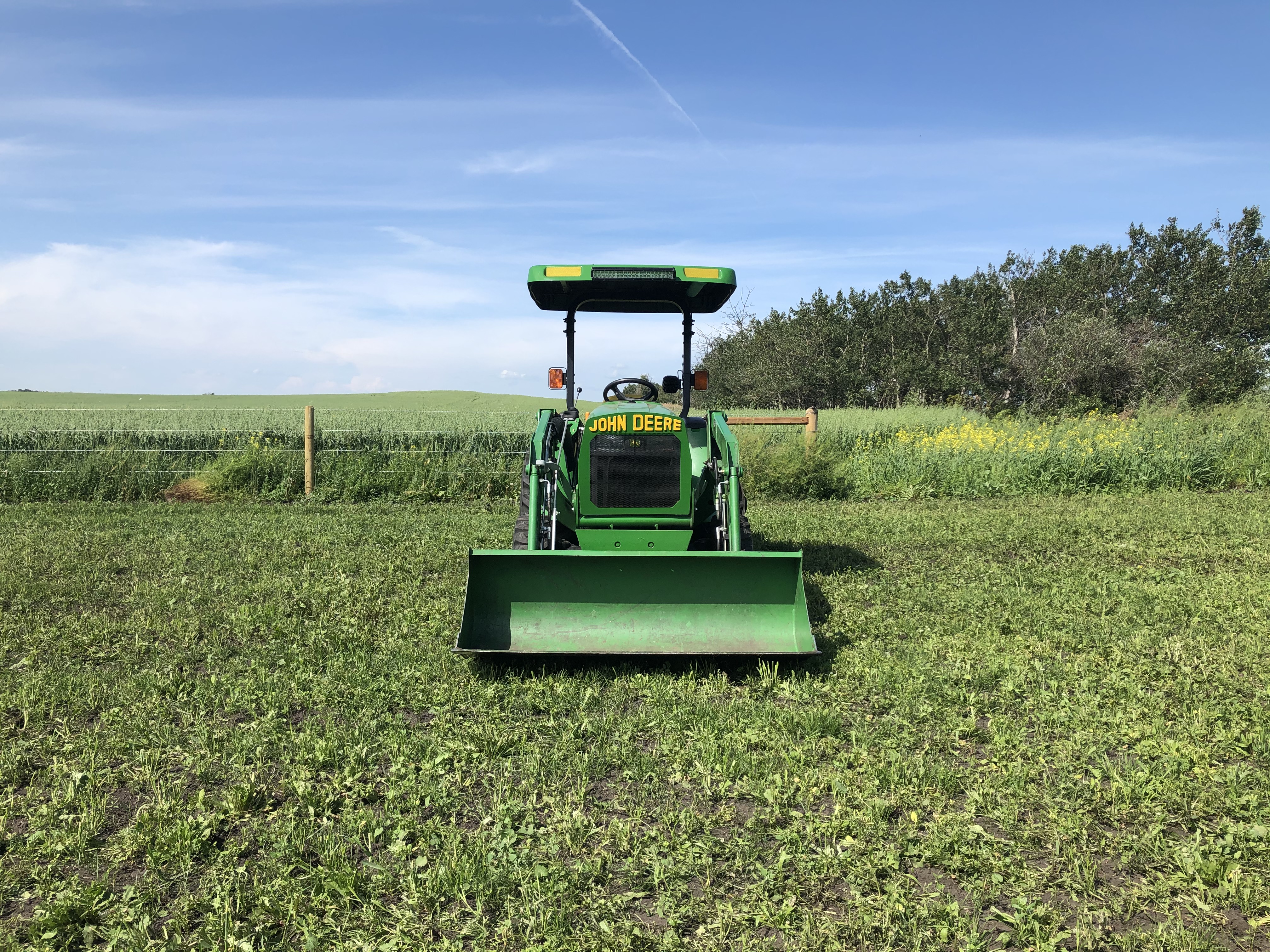

Hello, Longtime reader first time poster.
I was brushing and had a stick go through my grille. So i devised this retro grille guard to resemble an AR deere Radiator.
It sure catches a lot of attention, especially from Two Cylinder fanatics.

Looks good, welcome to TBN.
   / Deere Retro Front Brushgaurd #3
Some good ingenuity there and it looks good. Welcome.
Jim.
   / Deere Retro Front Brushgaurd #4
Too cool! And welcome.

That's nice. What did you use for lettering?
To make the lettering was quite the process. First I took a picture of the front end of my dads old AR John Deere. Then after some photo shop touch ups, imported into Autocad Fusion 360. Then traced it out, compiled a CNC file then cut it out with a plasma table.
The letters are 1/4" mild steel, the frame is 1/4" mild steel, and the radiator portion is 3/16" thick X 1/8" hole punch plate.

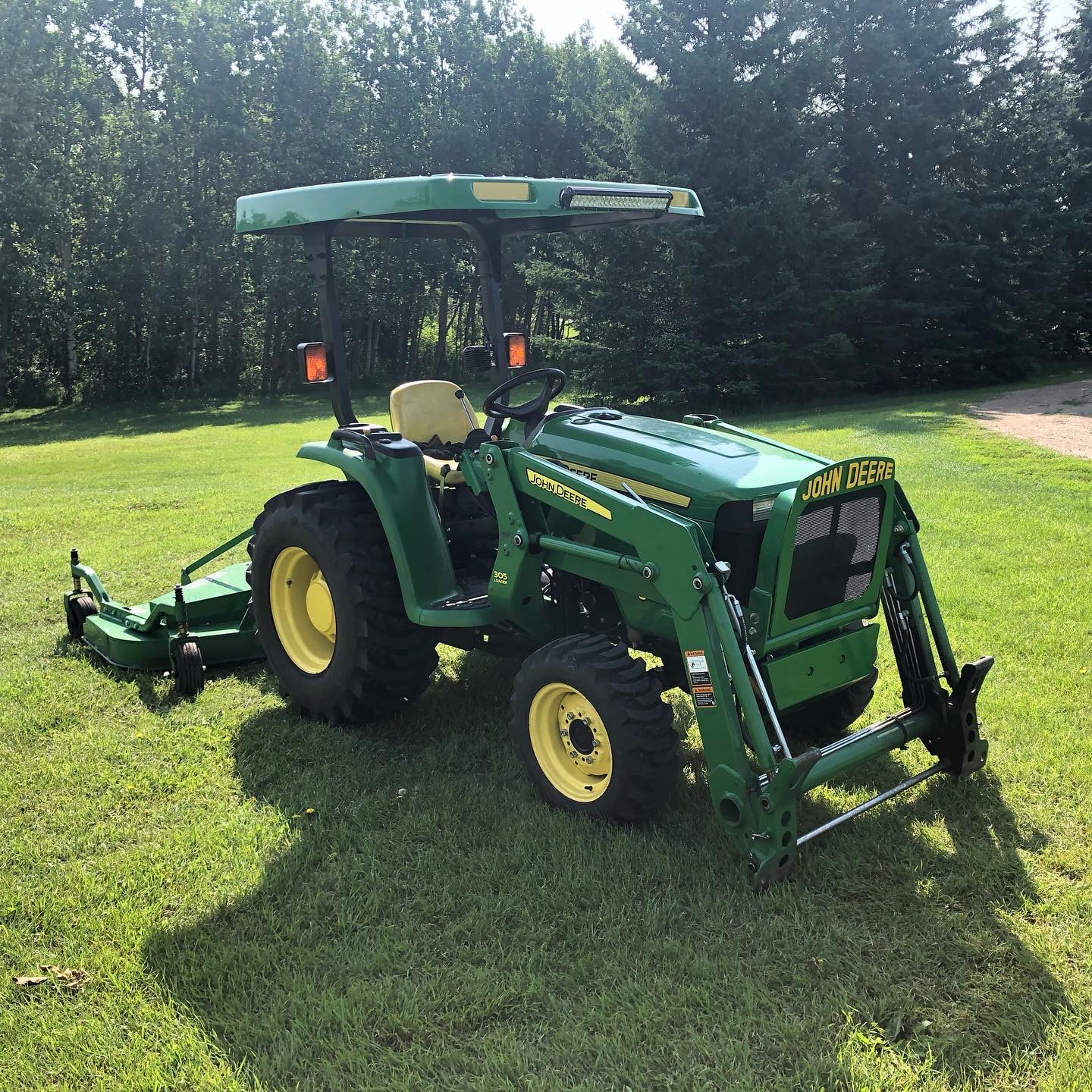

I find it funny the 3038e and the AR have comparable horsepower, but the AR was a legit farming tractor, the 3038e is a glorified hot rod lawnmower.
The 3038e has some serious ballasting conundrums. The front end is horribly light. I also built the weighted front bumper for this unit. The grille in conjunction the bumper weight is about 90lbs. really makes the tractor much more stable.
