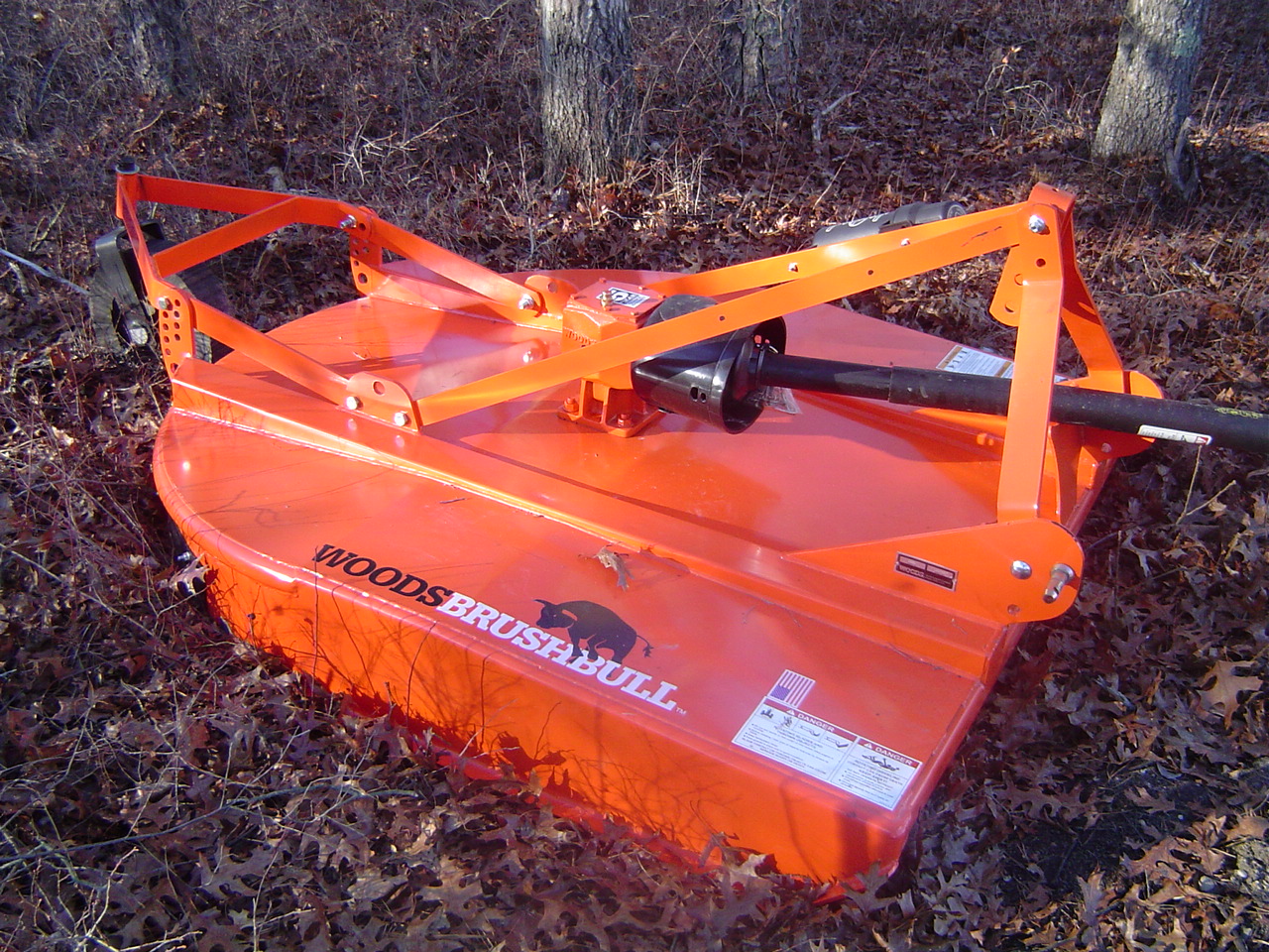

My woods bb60 is a monster in the thickest brush.
