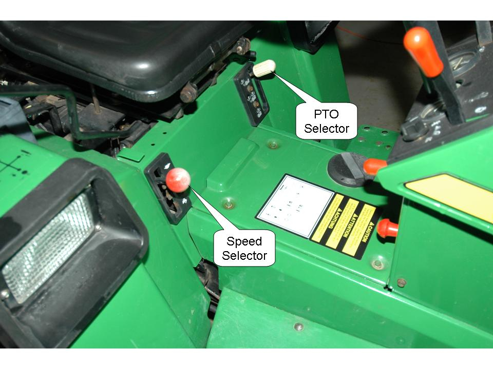

Looking for a few parts for a 955 that I recently purchased. Anyone happen to know the part numbers of the plastic placards that indicated the pto and speed positions (see attached pic).

Are you looking for the labels?
Is this a photo of what you have now?

they are molded plastic, not decals they show to be about $20 each at Deere
M91087 Quadrant plate Speed (HIGH-NEUTRAL-LOW)
M91088 Quadrant plate PTO (MID-BOTH-REAR)
