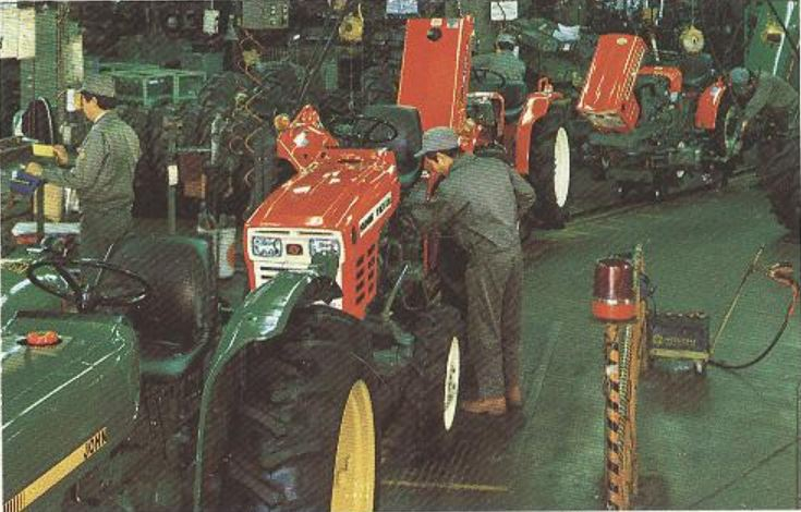

3T90 is the engine model.
Much of the 50 Series John Deere machines are made from automotive JIS parts found in the 1970s Datsuns (Nissan today). You don't have to pay JD mark up when the local autoparts store has the parts you need.
Your machine and mine came off the same Yanmar assembly line in Japan. Built to JIS standards and not SAE.
