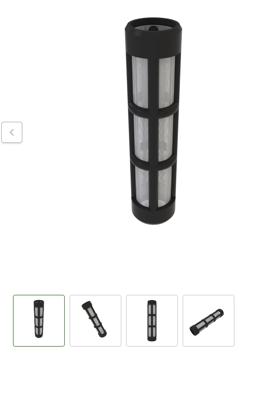

Where did you find a new screen ? I cannot find it in the parts diagrams. Although I'm told you can fabricate your own from stainless 200-mesh hardware cloth.

Try Yesterday’s Tractors for the screen. It will be located basically in the bottom of the sump. Find your suction tube, then look on the opposite side for a removable plate (Be a while but I believe mine has 3 bolts holding it in place). To control the mess somewhat drain the fluid first.

I just googled "JD 670 Transmission Filter Screen" and got a picture that looks like the one attached.
They are all much the same. Sump filters like that aren't a perfect oiltight fit - the ends of the flter slide rather loosely over a couple of locating projections in the sump. After all, they are only a safety filter for large chunks of crud and designed to be cleaned. Some are nylon and some are metal screen. I've bent them back into shape and even patched them. The problem they cause is that they get completely coated to easily, and not having a bypass valve they then starve the hydraulcs.
The disposable screw-on filter takes care of whatever the sump filter misses. And that screw-on filter does have a bypass valve.

I just googled "JD 670 Transmission Filter Screen" and got a picture that looks like the one attached ..
Yeah, that wasn't so hard :). Looks like it's $130+ though ...
