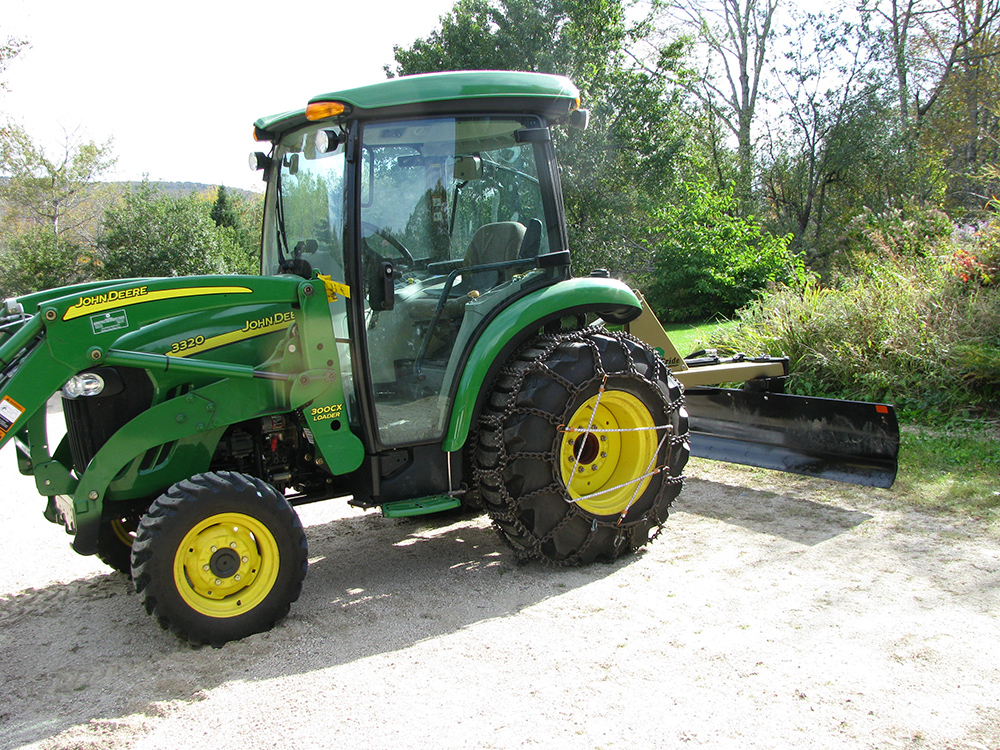

I agree with Roy on multiple counts...I do use an 84 inch blade on my 3320 (once I installed my extenders, my olde blade wasn't wide enough when angled)....I also use the convex side when moving snow...expecially handy when the ground is soft early and late into the season...when the ground is frozen solid and there is a substantial snowfall predicted I do switch to my rear mounted snowblower... tractorandgrader.jpg

BENNATTI - I noticed the chains on your tractor. We don't get quite as much snow in Ohio as you do in Maine, but in case I decide that I need a set, approximately what would a set of chains set me back?
THANKS AGAIN for the replies and advice!
   / Deere 3520 & Rear Blade #6
...but in case I decide that I need a set, approximately what would a set of chains set me back?
Try Tire Chains by TireChains.com
These folks will advise you on clearance requirements and shipping costs.. Prices are on the website.
As far as clearance....I have 41-14-20 turf tires on my Deere 4400 (which is quite close to your 3520 in size and power). These folks suggested a minimum of 2.5" clearance between the tire (sidewall and top) and the fender. I had to reverse my tires to attain the required clearance. If you have industrial or ag tires, you may need to swap side to side (to maintain the correct rolling direction) or add spacers.
