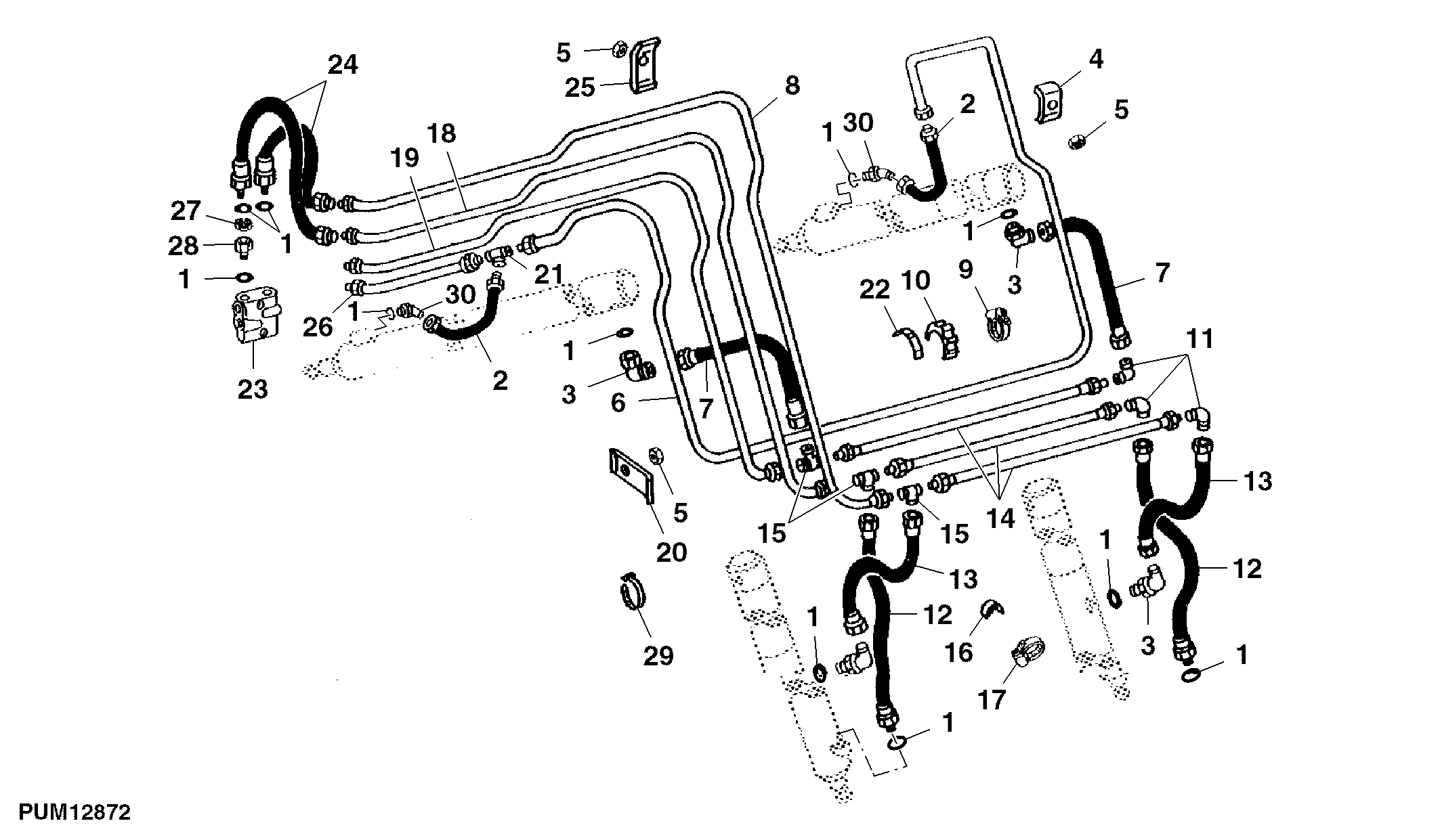

Does your 2940 have the correct mounting frames that go from side mount to rear axle?? If not you may end up with a cracked/broken clutch housing. The utility tractor hyd schematic in the 260 parts cat. shows no relief valve for self leveling that you refer to.

You do have the return line in your post, but the relief isn't visable because its mounted on the loader frame. See attachment. Item 23 is what I'm looking for.260.gif

You do have the return line in your post, but the relief isn't visable because its mounted on the loader frame. See attachment. Item 23 is what I'm looking for.View attachment 344703
My JD 245 loader has the same valve. I had trouble with the tubing (not shown) used for the return to sump line getting pulled out of the fittings so I replaced it with 1/4" hydraulic hose.

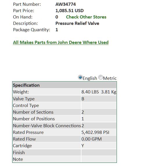

Here's parts key #23
AW34774 Pressure Relief Valve 1 (SUB FOR AW20908)
AW25329 Pressure Relief Valve 1 008001 - (USE WHEN LOADER IS EQUIPPED WITH SPECIAL ROLL-BACK LINKAGE)

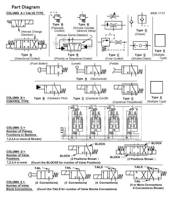

Here's the spec's on one valve
Try this schematic for plumbing using remotes..

AW20908 subs to AW34774 Pressure Relief Valve ADD 1,085.51 USD
