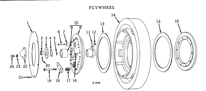

i got a new bushing for the shear bolt on the flywheel. how does it come out? press it, beat it? take the flywheel off or?? i guess i ordered a new one so might as well change it

its the bushing that the bolt goes in.the bushing is has 1/4 inch hole about 1 inch od. i was wondering if i need to pull the bushing out or just beat it through. so far im gonna use the hammer elbow grease method.
/ deere 214t baler #5
As long as the shear bolt arm that's splined to the gearbox is not blocking the travel of the bushing while attempting to remove the bushing can be driven towards the baler.

Here's you a parts breakdown. Parts key #11 is the shear pin arm I was referring to

im changing # 7
/ deere 214t baler #9
Yes #7 is the replaceable bushing that requires a big hammer.
/ deere 214t baler #10
im changing # 7
Where did you get that bushing? Or, what size is it? Does it have the hex shape in it to hold the bolt head? Mine seems to be stripped.
/ deere 214t baler #11
Your friendly JD dealer. BP14087 Bushing ADD 24.55 USD

I ordered it form aa equipment in san diego. but as jim said use that p/n and go to jd dealer
