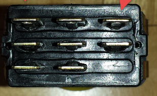

My bad.. Everything working fine after following directions.. after further investigation one of the repositioned plugs was pushed out..
Resnapped it back it & now RIO 🔌 is defeated !! 👍👊💥

I know this post is a little old, but I'm hoping someone is paying attention that knows about this, so it works, but the bracket was a little brittle and broke on me when removing these pins.. Anyone have an idea of where I can get this
thanks.
   / DEERE 2032R RIO EASY DEFEAT #36
View attachment 698876thanks.
Do you just need the part number?
   / DEERE 2032R RIO EASY DEFEAT #38
that would be awesome if you have it.
No idea what that part number is.. hope someone with the wiring schematic can help.
See first post of this thread that shows what needs to be connected.
