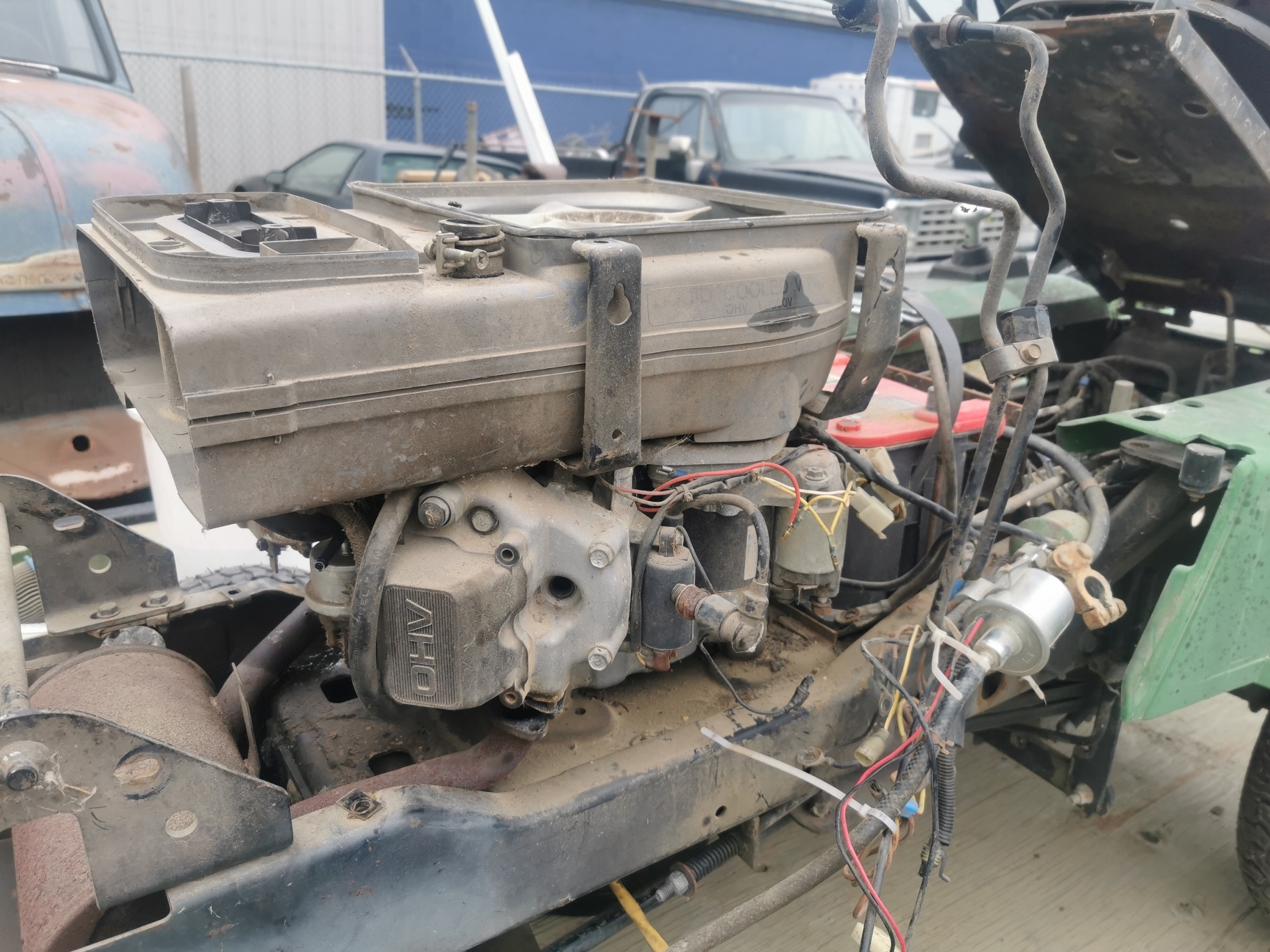

will start removing motor tomorrow then tear into it

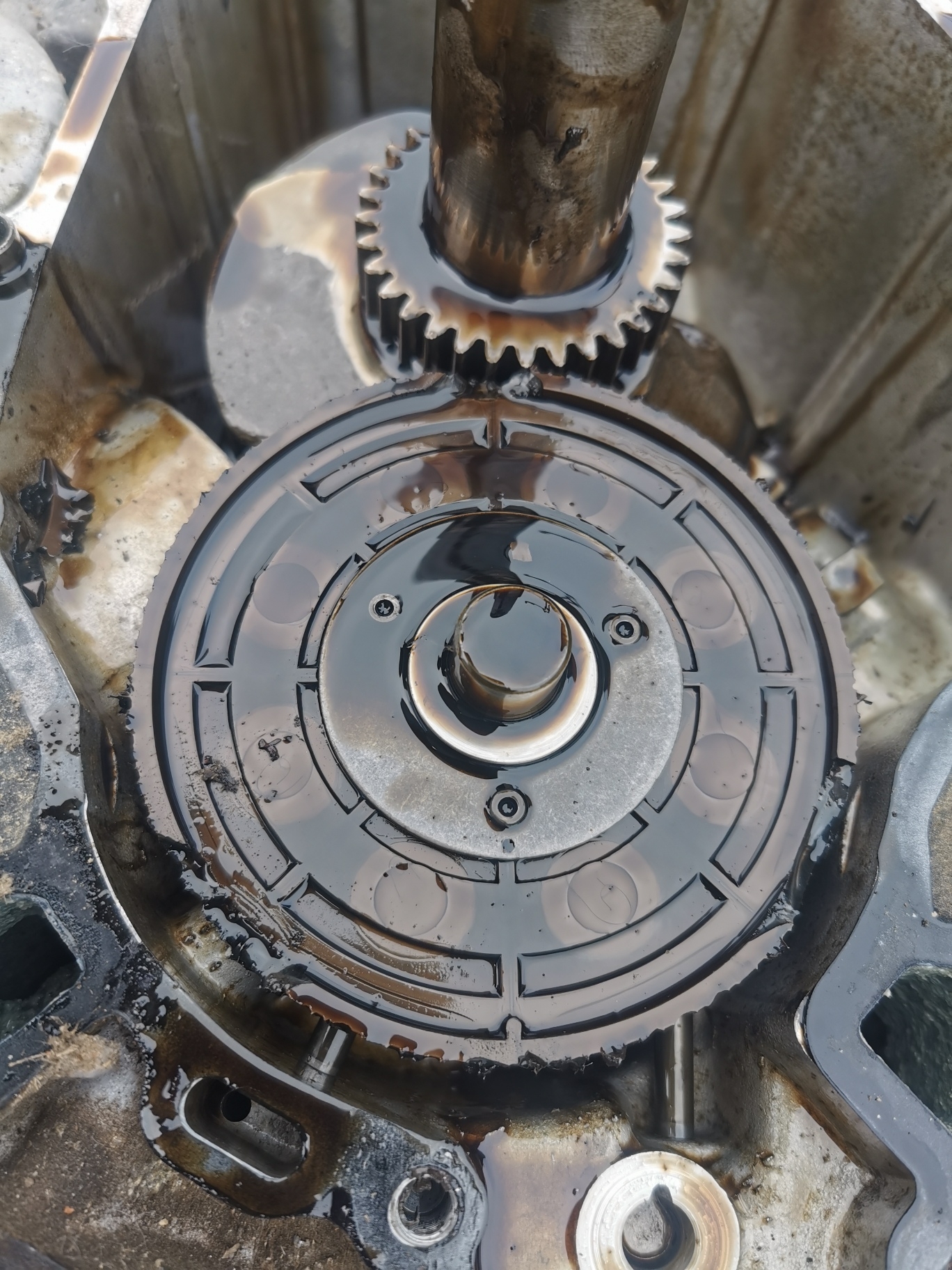

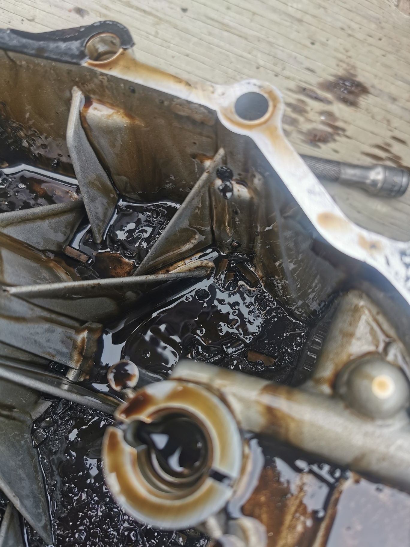

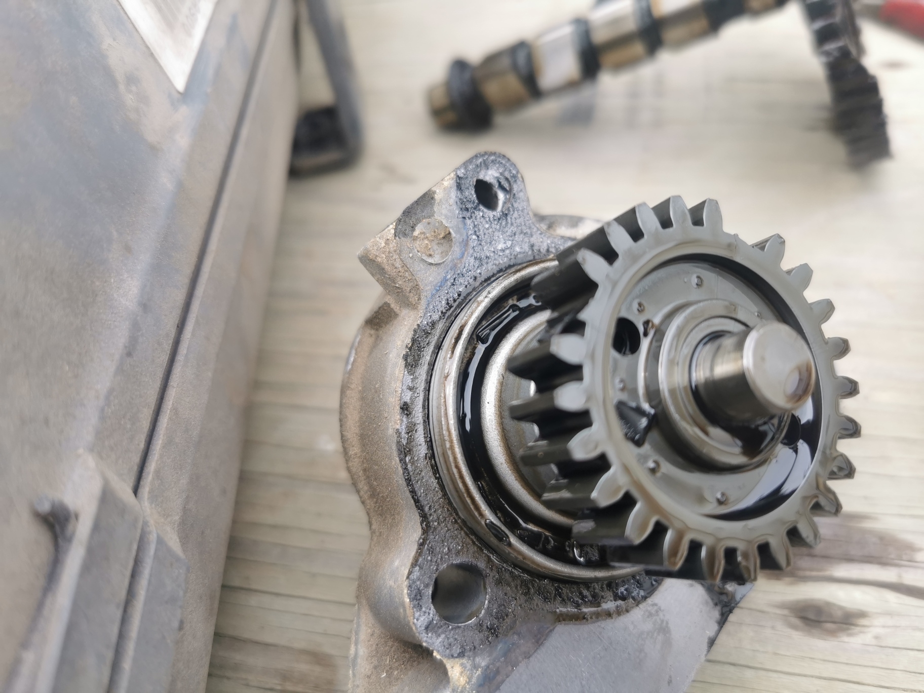

here is my findings, camshaft gear is stripped badly, next to no teeth on the gear, waterpump gear lost 2 teeth, oil pump and governor gears are OK first look, case full of teeth, have not removed heads but the pushrods are straight and the valves are not sticking of stiff to move.
all parts less the camshaft were stocked locally at the Brandt Deere dealer less the gear/camshaft it should be in tomorrow, cleaning up the housing today why the heck use a plastic gear for this application? given the load and heat cycles it sees over a few thousand hours of use.
it must have made many rotations even without teeth as most all teeth are missing, anyone know if the valves are clearance on the pistons when this happens?
here are a few pictures of the parts as they are removed,

I would have NEVER purchased the replacement parts from a Deere dealer as the markup on Deere parts is extreme. I would have went to a site like Jack's small engines and bought them there or Stens or anywhere but a JD dealer. The gears look rough to say the least and engine builders use plastic gears (or structural fiber gears) to save money as they are much cheaper to produce and most people would just install a new engine anyway. Jack's has them (new engines) as well.
