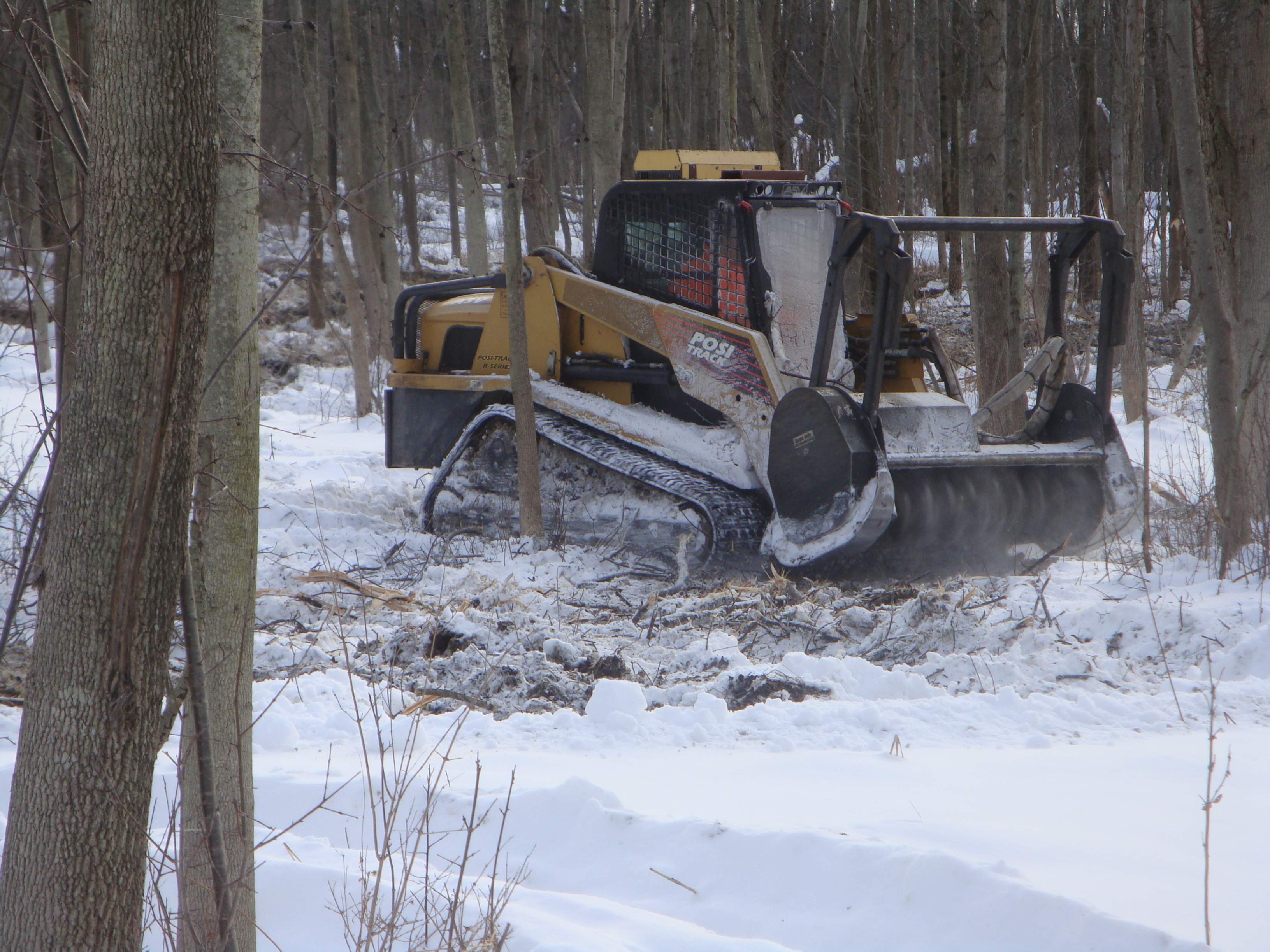

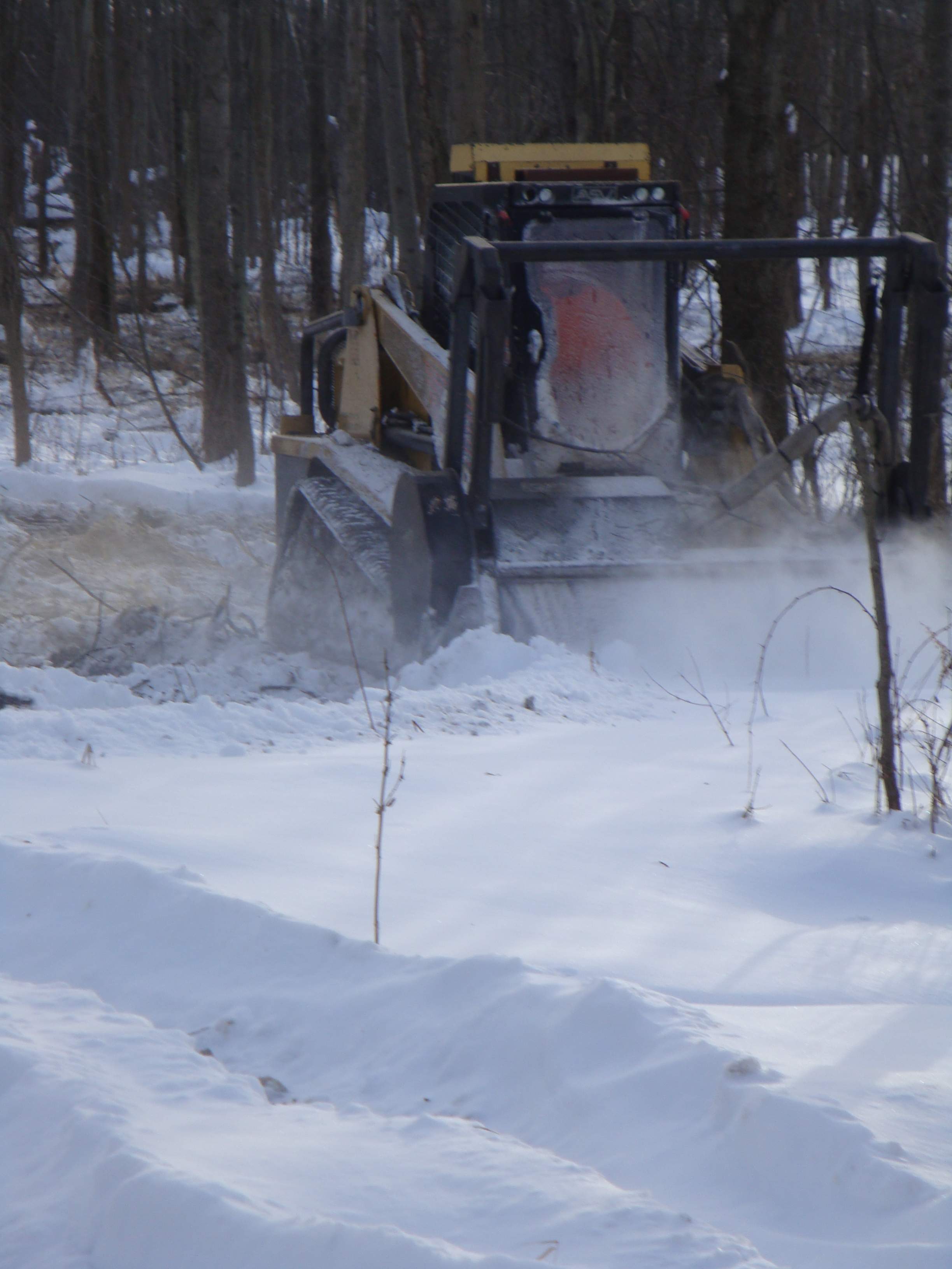

It's a great time to get those swampy areas when frozen. I'm bustin my butt right now in areas normally too wet to walk in, let alone get mulcher in there. There are advantages; machine runs cool, no dust, and snow lubricates the mulcher drum & nothing jams. I'm thinking of adding a windshield wiper to the forestry door. Snow sticks and obscures my vision. Fortunately I don't have a rocky area to avoid. In some areas, I've been working in 20" of snow without problem. Hydraulic & diesel leaks are easier to detect in the snow and I'm not complaining about the ASV AC system.
