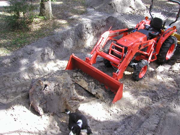

Should be not much of a problem, I dug this huge live oak stump completely out of the ground using our Kubota L-3130 with LA723 FEL without a toothbar. A toothbar would have made it a little easier though.
