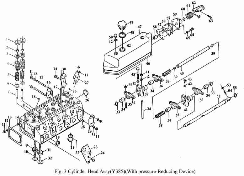

Interesting stuff on this topic. I have no idea what or where it is on my tractor. I have a hood latch knob, and the engine stop knob to the left of the steering column, a hole with nothing in it and the starter key to the right of the steering column. It's cold in North Idaho already and freezing most days in winter. Any idea where and how to hook it up?
   / decompression lever KAMA ts254 #2
Open your hood and look on the back side of the valve cover. The compression release mechanism on the Y385 engine is built into the valve cover and the linkage to activate it is connected to a lever and shaft comming out of the back of the valve cover, part #62 in the following link to Johns website.
http://www.johnstractor.homestead.com/files/CylHeadFig003.jpg
The rest of the linkage on the Jinma I own consists of a pushrod connecting the lever on the valve cover to a lever and shaft that sticks out under the dashboard in front of my left shin. Mine has a handle angeled at about 45 degrees. you twist the handle clockwise to engage the compression release.
