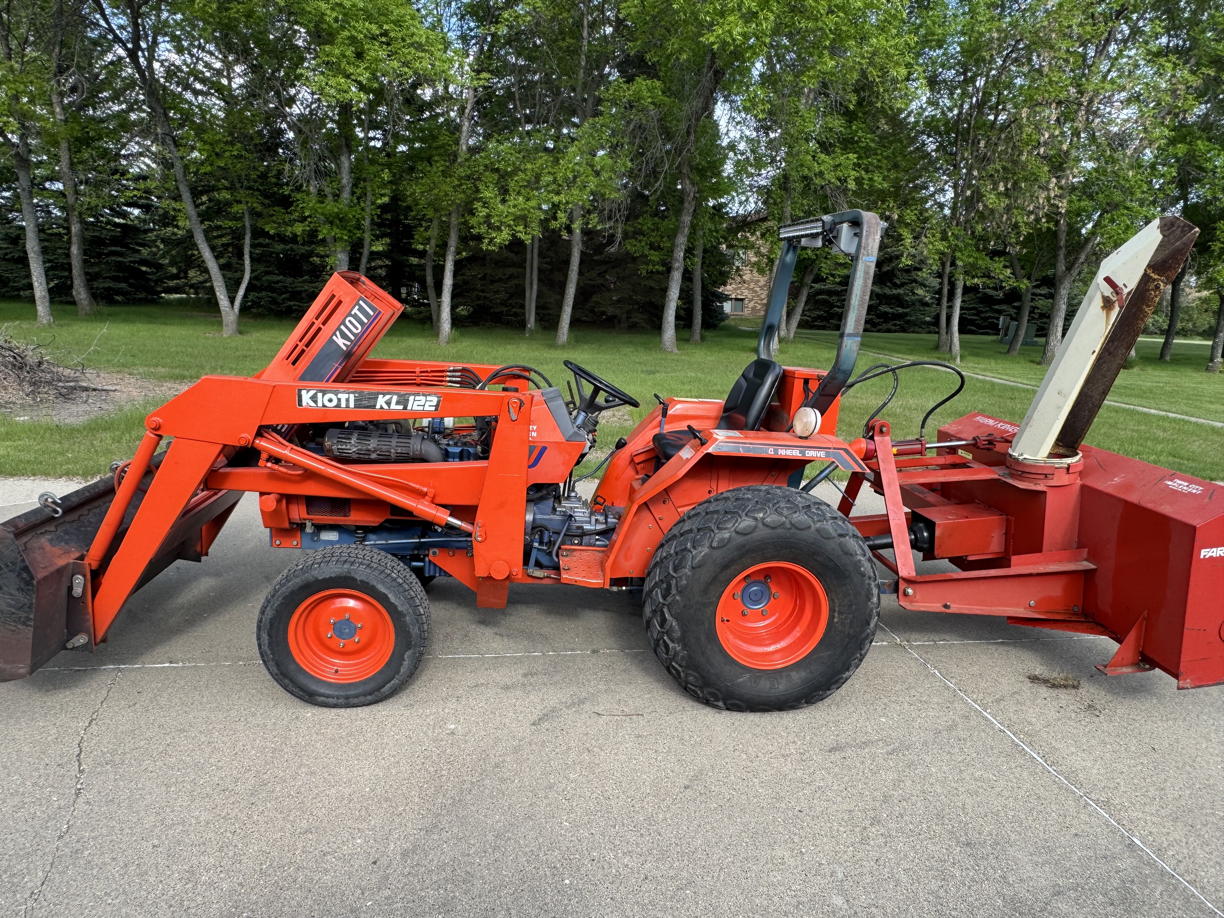

I have an older Kioti LK3054 I need to sell and I can’t find the year.
30hp
SN 26500258
THANKS

/ Decoding a Kioti Serial Number #17
I asked Grok and this is a snippet of what the response was.
For Older Kioti Tractors (Pre-2004):
  • Format: Serial numbers often consist of numerical digits without a leading letter.
  • Structure:
    • The first digit typically indicates the year of manufacture. For example, a serial number starting with "4" (e.g., 426500778) suggests the tractor was built in 1994.
    • The next few digits (often the second to fourth) represent the model code (e.g., "265" for an LK3054 or "614" for a DK35).
    • The remaining digits are the individual tractor's production sequence number, indicating its place in the production run (e.g., the 778th or 451st unit of that model).
  • Example: Serial number 361400451 for a DK35 means it’s a 2003 model (first digit "3"), model code "614" for DK35, and the 451st unit produced.
For Newer Kioti Tractors (2004 and Later):
  • Format: Serial numbers typically start with a letter followed by numbers.
  • Structure:
    • The first character (a letter) denotes the model year. Kioti uses an alphabetical sequence starting with "D" for 2004, skipping letters "I" and "O" to avoid confusion with numbers. For example:
      • D = 2004
      • E = 2005
      • F = 2006
      • J = 2009
      • P = 2014
      • S = 2017
      • U = 2019
      • V = 2020
    • The second to fourth characters indicate the model designation (e.g., specific model like CK3510 or DK45).
    • The remaining digits are the production sequence number for that specific tractor.
  • Example: A serial number starting with "UU" (e.g., UUxxx) indicates a 2018 model year, as confirmed for a CK3510SE issued to the frame in 2018.
