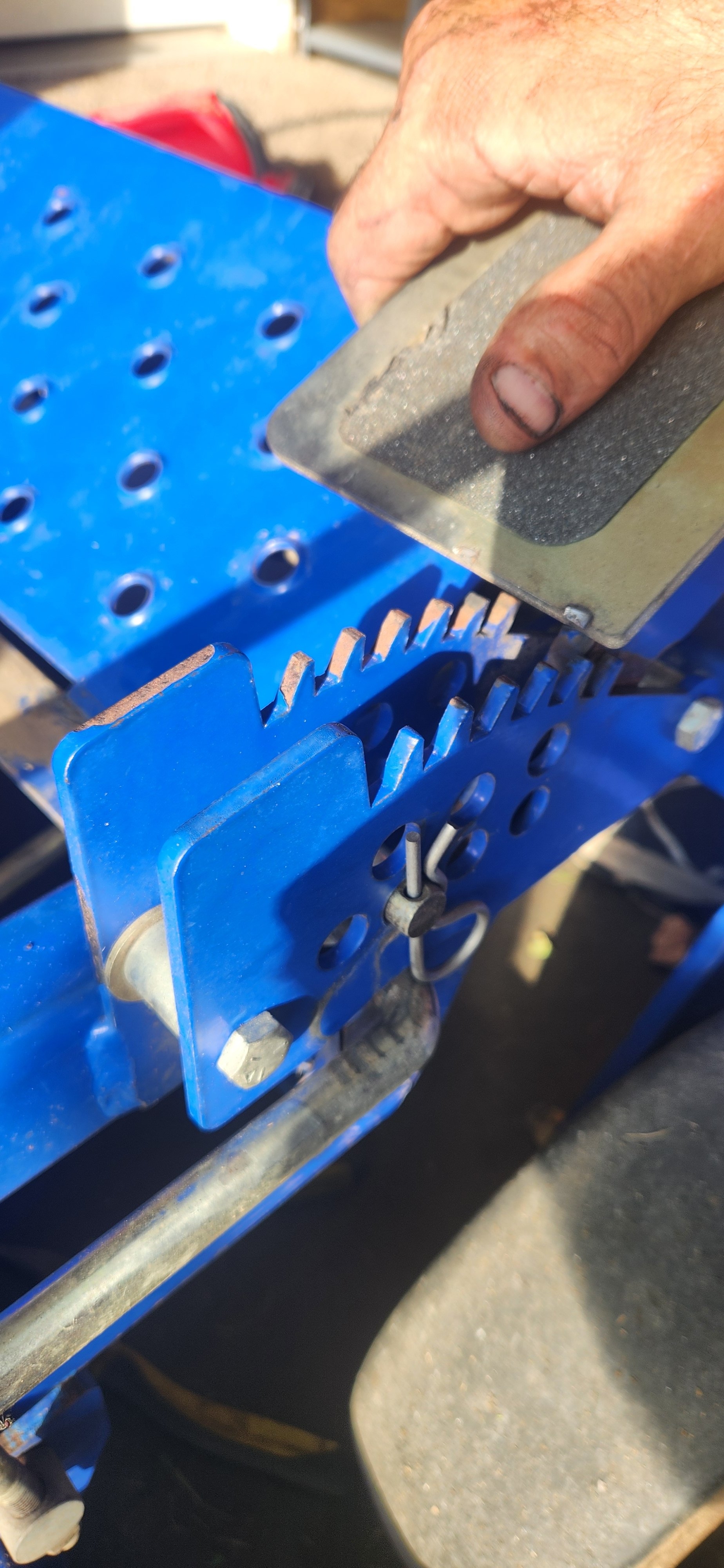

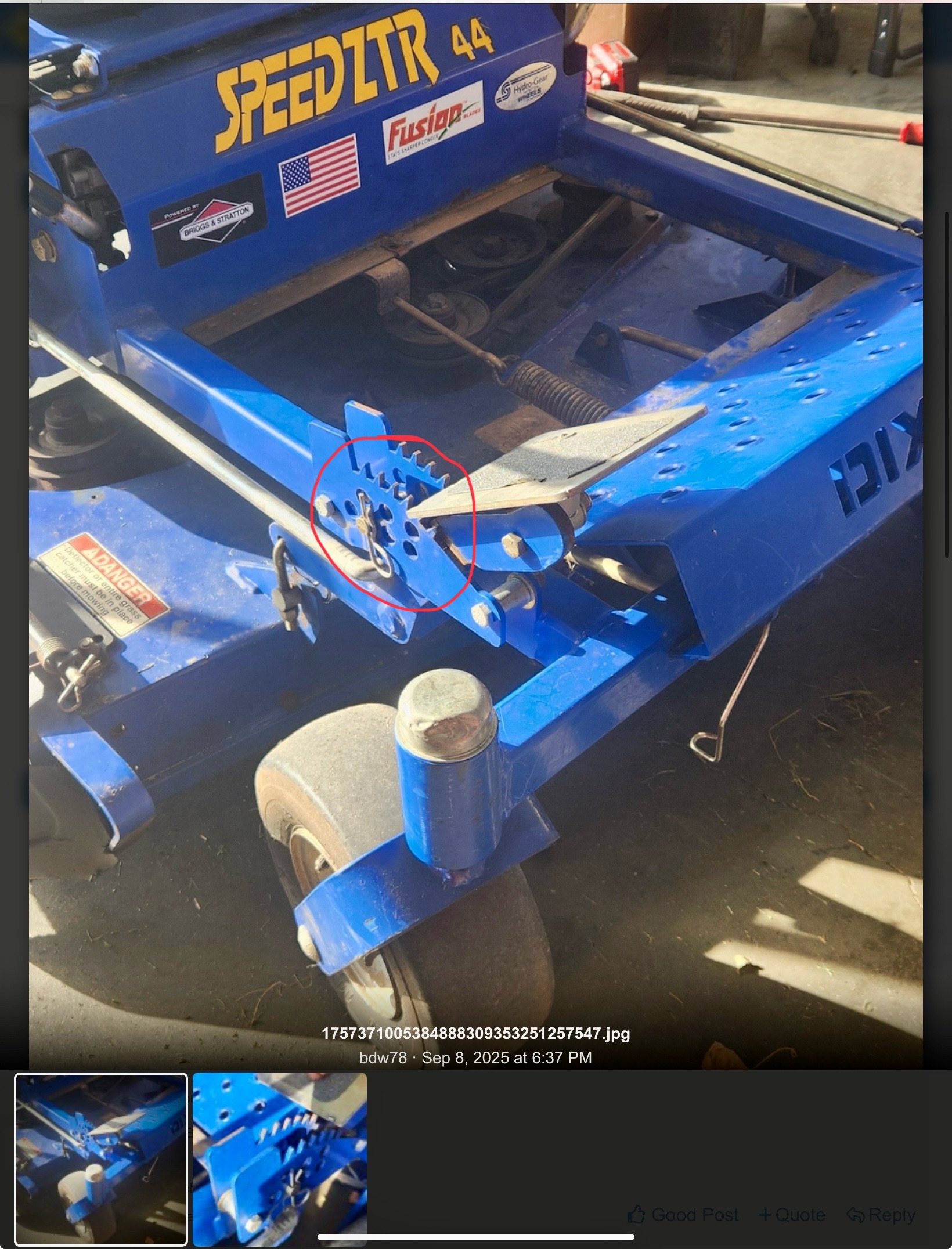

I have a dixon speedztr 44 and I can't get the deck to lower. I had this given to me. I've never used a zero turn. I can't get the deck to lower. The pedal moves but the linkages don't. Is there a safety feature on it or something? Thank you

The foot pedal part moves and nothing else

I think there is pin that can lock the deck in the highest position for belt or deck removal. Might have been pinned up for transport.
