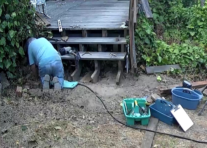

I saw the online photo of that goofy new deck after I finished repairing the deck stairs here last week. That photo made me think how non-standard design here has made repairs more complicated.
Below is a photo.
The outer edge of the first stair tread crumbled away if you stood right at the edge. And the stair rail post at the bottom stair had rotted, this explained why it didn't feel solid even after I ran an additional bolt through it recently.
Replacing the lower stair tread, I found the redwood stair stringers rested on brick pavers, but gopher dirt had buried the contact point so all the stringers were rotten along their lower edges.
I had some old full-dimension 2x12 first-growth redwood plank scraps, and made partial scab stair stringers to bear down properly on the pavers and support the stair stringers. My air framing nailer was invaluable for attaching these alongside the stringers since there was no room to swing a hammer, or drill for bolts, in the now-narrow space between stringers. I also replaced the 4x4 newell post. This bolted securely to the adjacent reinforced stair stringer and went all the way down to bear on the paver beneath. The railing now doesn't feel shaky.
With new redwood for the lowest stair tread these stairs are good as new :) .
