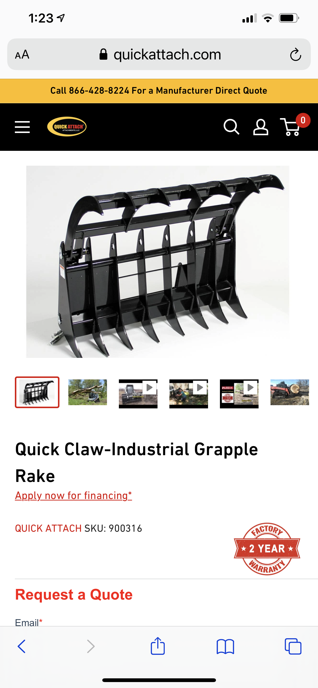

This is the style I’m thinking. The duel lid seems useful but not for raking.
But then again the longer tine bottom would allow you to see what you digging into.
I’d rather have the long bottom. The rake style would have to suffer picking up pretty much anything over a long bottom.

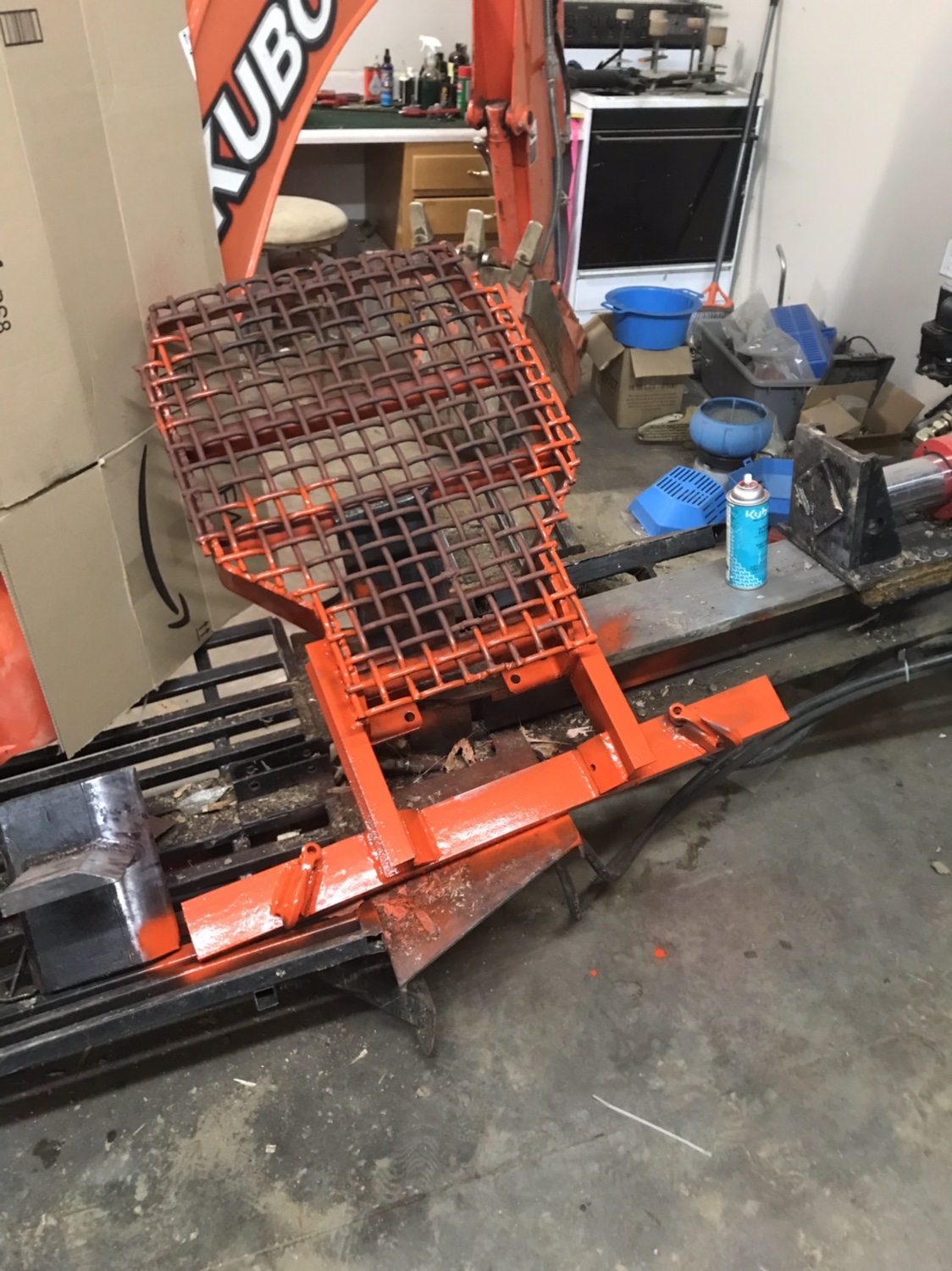

Do yourself a favor. Get your grill guard modified to protect your grill, radiator & battery from sticks, stobs, limbs etc.

He’s putting it on a skid steer but tractor brush guards definitely leave room for improvement. Here’s mine I built. IMG_8039.JPG

Nice addition to your brush guard - 4570Man. That will deflect the brush - and all elephants. WoW!!!

This is the style I知 thinking. The duel lid seems useful but not for raking.
Something to consider when using the lid for back-dragging is: does it have mechanical stops or are the hydraulic cylinders the only thing keeping the lid from over extending over the top/back of the grapple? (have seen how hydraulic cylinders/valves react to unexpected shock loads and I doubt it's a good thing for either - even with over pressure relief valves doing their thing)
....and in general I think I'd go with that style for a skid steer simply because a skid steer can twist/turn putting some pretty strong side loads on an implement.
As was said elsewhere in the thread any grapple is better than no grapple, but from what I've experienced there is no universal "best" grapple only the grapple most suitable for your applications ..... or at least that's what I tell myself in order to justify having multiple types of grapples :D ...my current ones are Danuser Intimidator which is great for removing vertical objects like trees & posts, and a single-lid EA brush/L-bottom grapple which is great for grabbing large volumes of horizontal material and some surface raking --I prefer using my box blade tines for heavier ground engagement & root removal.
However, if I was using the grapple for digging through the ground a lot I'd likely get one of that style just to minimize the surface area dragging through the ground..... and likely one that has mechanical stops built into the frame.
Anyway just my :2cents:
