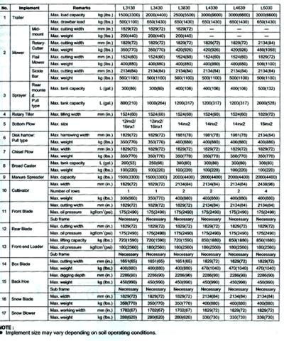

Chuck, the attachment is the Implement Limitation Table from the Kubota Owner’s Manual for your comparison. Like Rat said that is where the extra HP difference comes into the equation. Don.

I have my Kubota book out: 4330hst vs 5030hst.
Tires are Front-8.3-16 vs 9.5-16
Rear-14.9-24 vs 14.9-26
Engine displacement-134.1 vs 148.6
Implement pump-9.4gpm vs 9.8gpm
Fuel capacity- 10.6 gal vs 11.4 gal
PTO power HST-34.5 vs 42.5
Engine gross power- 43.2hp vs 52.2hp.
3 point lift capacity- 2760 vs 2980
Don't forget, the wheel offset is adjustable on the 5030. I don't actually know if the 4330 is, but I will stand corrected on that subject.
