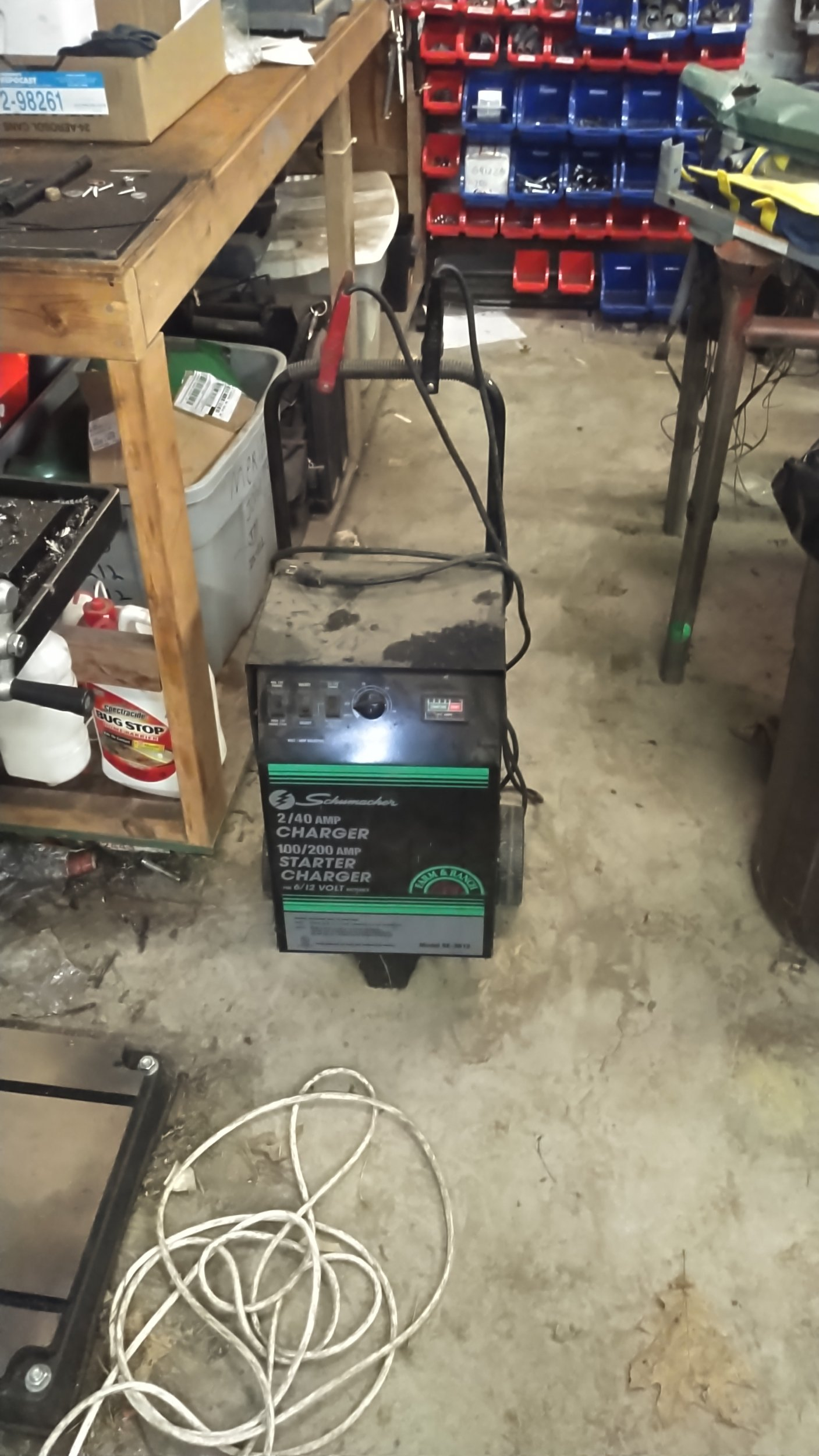

I have a quite a few battery chargers and maintainers, my best and favorite is the old school transformer type Schumacher farm and ranch model with timer with that being said I believe a diodes out on it awaiting motivation to repair, reason I think that is timer shuts off, amp gauge is still lit from battery power unless I disconnect it. One thing I don't like about modern electronic chargers is they won't charge a battery that's completely drained I believe you can't use the jumpstart feature either if it has it.
The NOCO chargers will charge a completely dead battery. They have steps to do it in manual.
