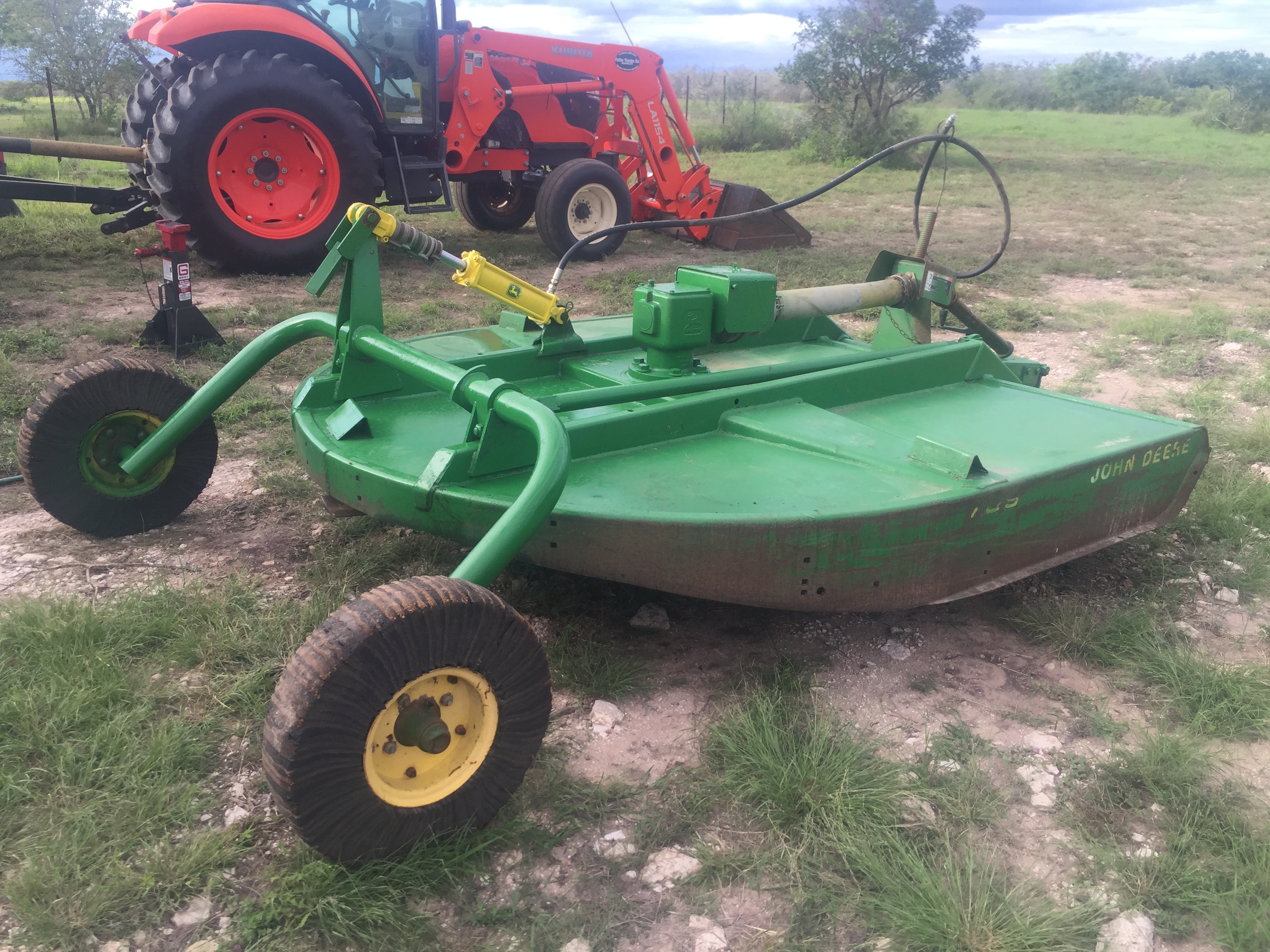

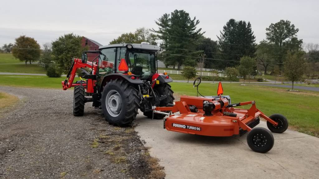

Sold this one for $3200.00 the other day..
I prolly regret selling but dont have the space to store..
Bought a Bushhog 3210 to replace..
Buy used.. Just gotta be patient
