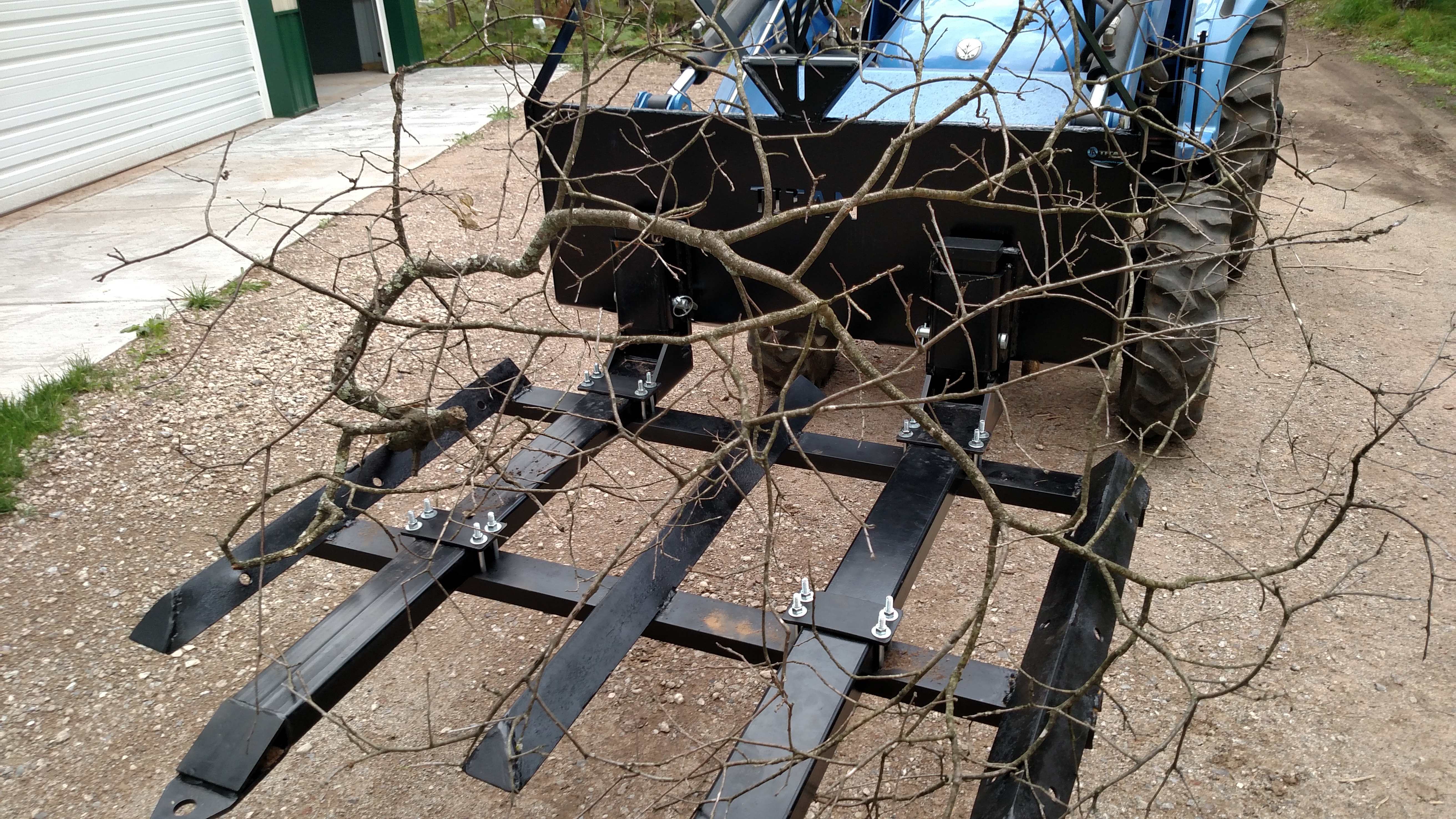

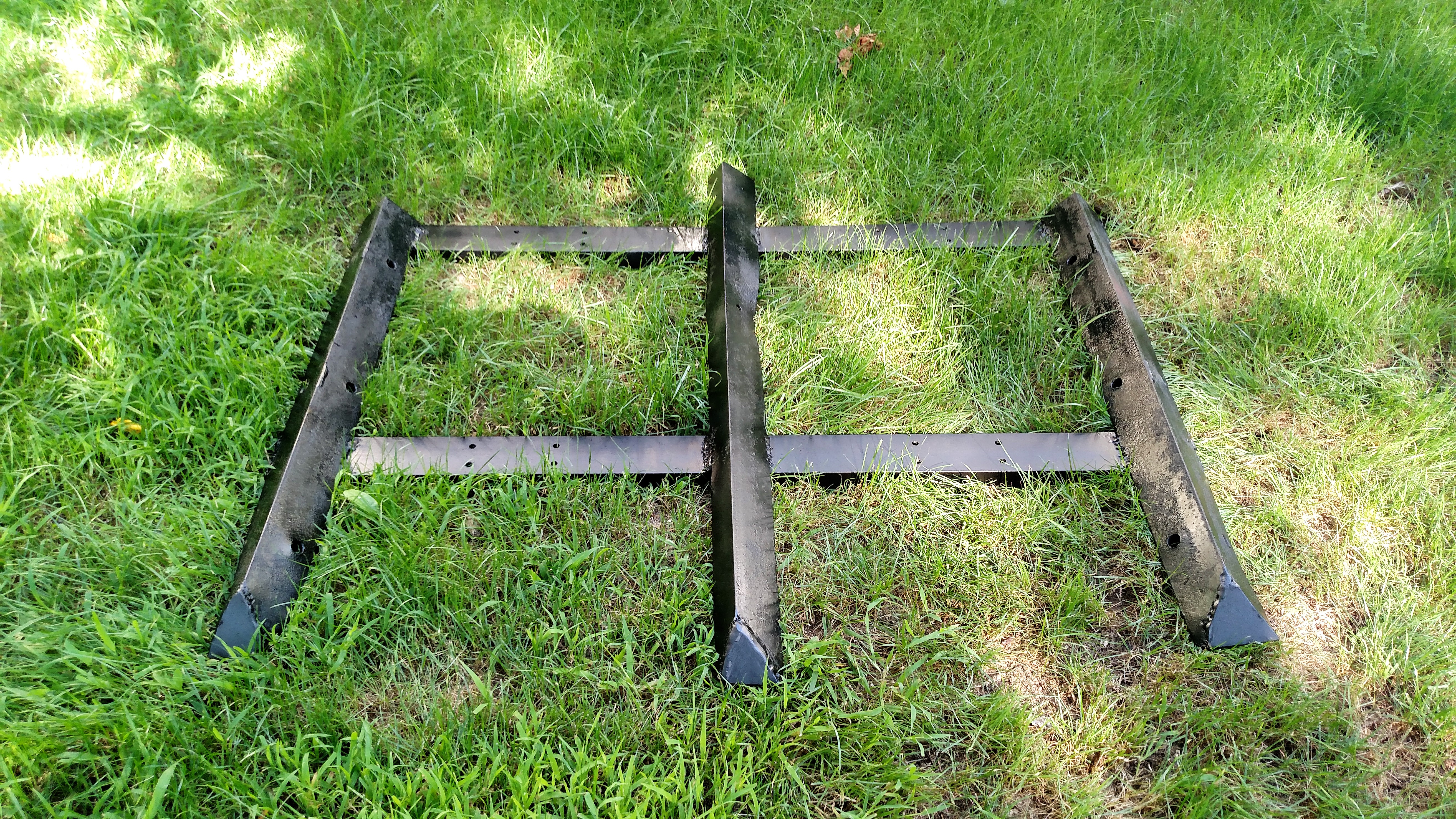

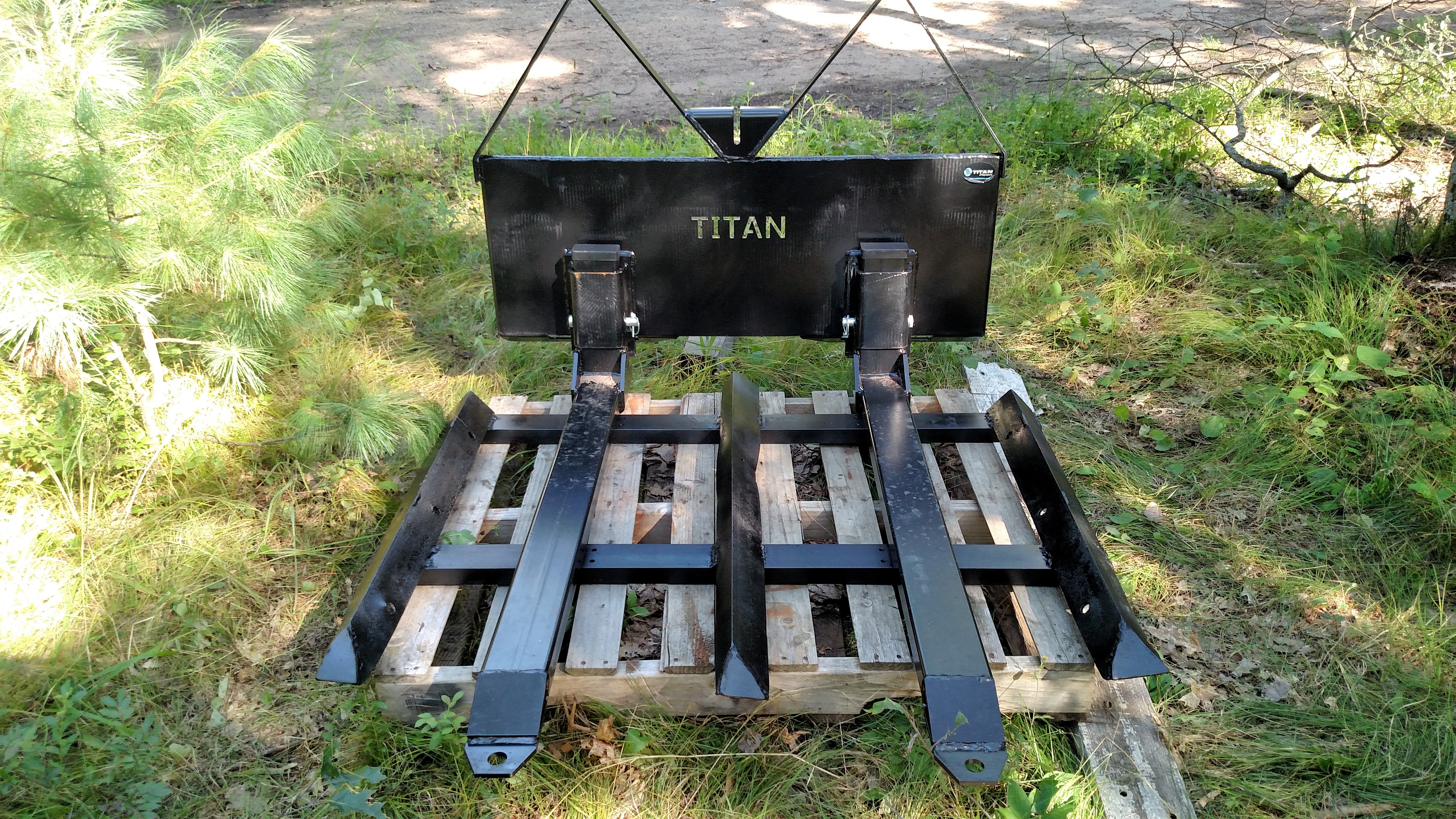

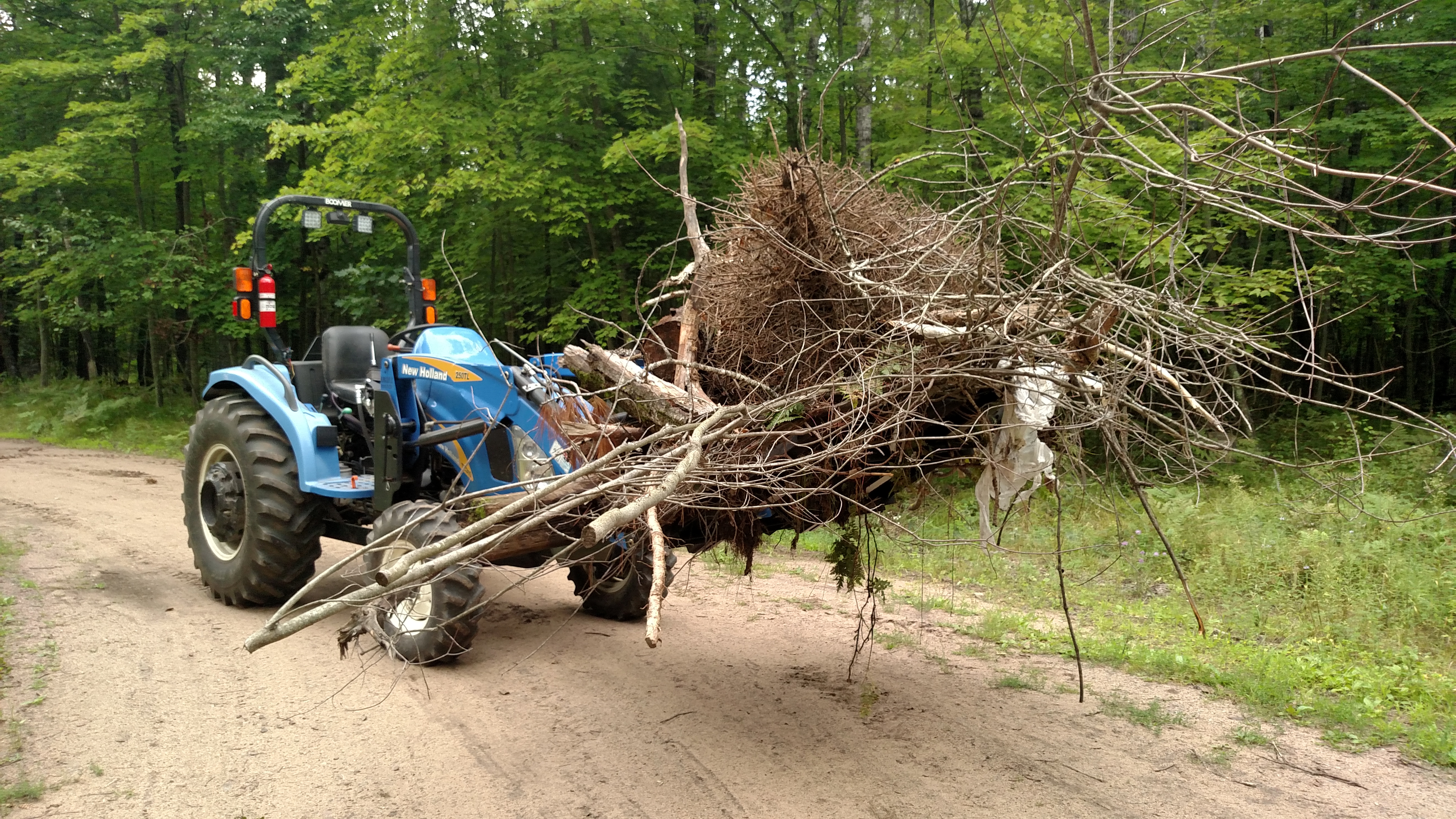

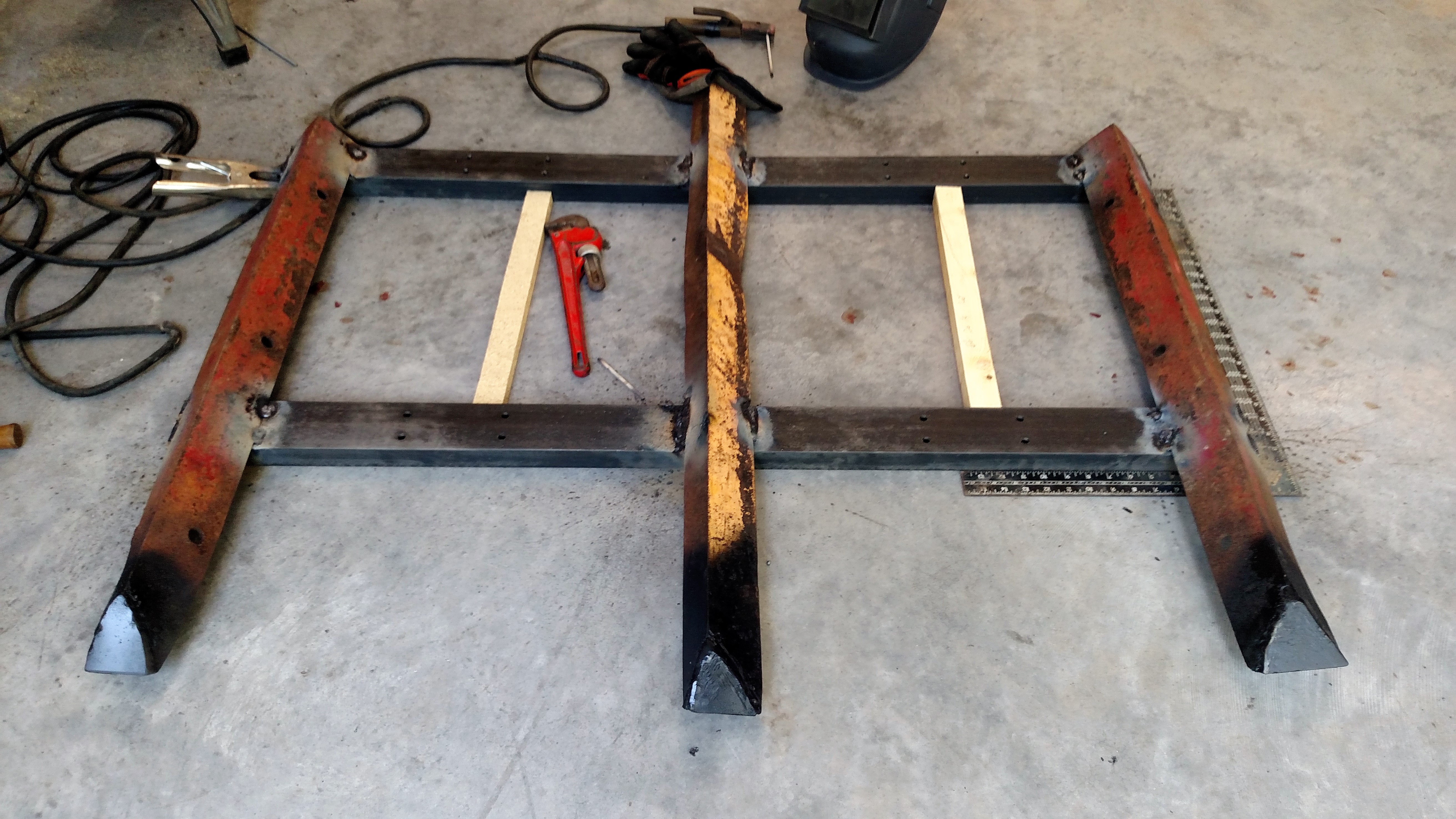

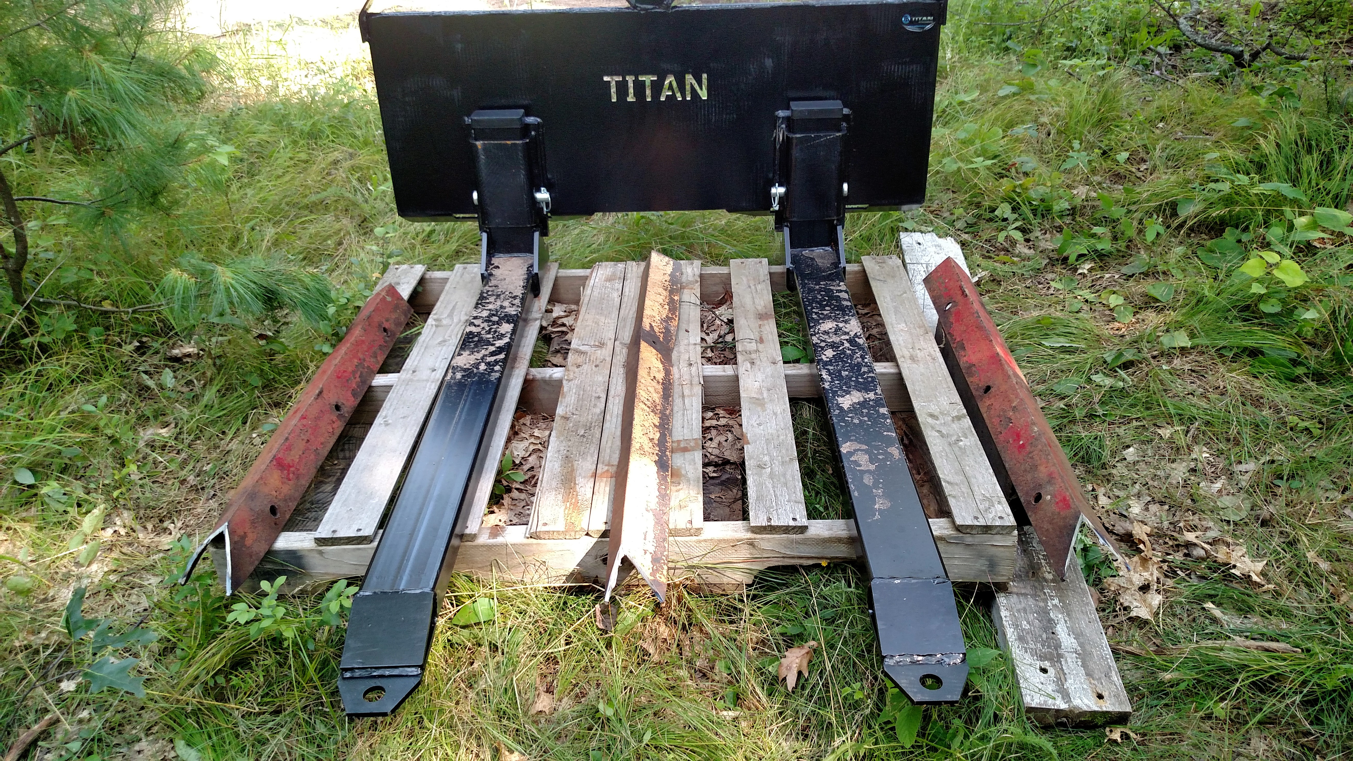

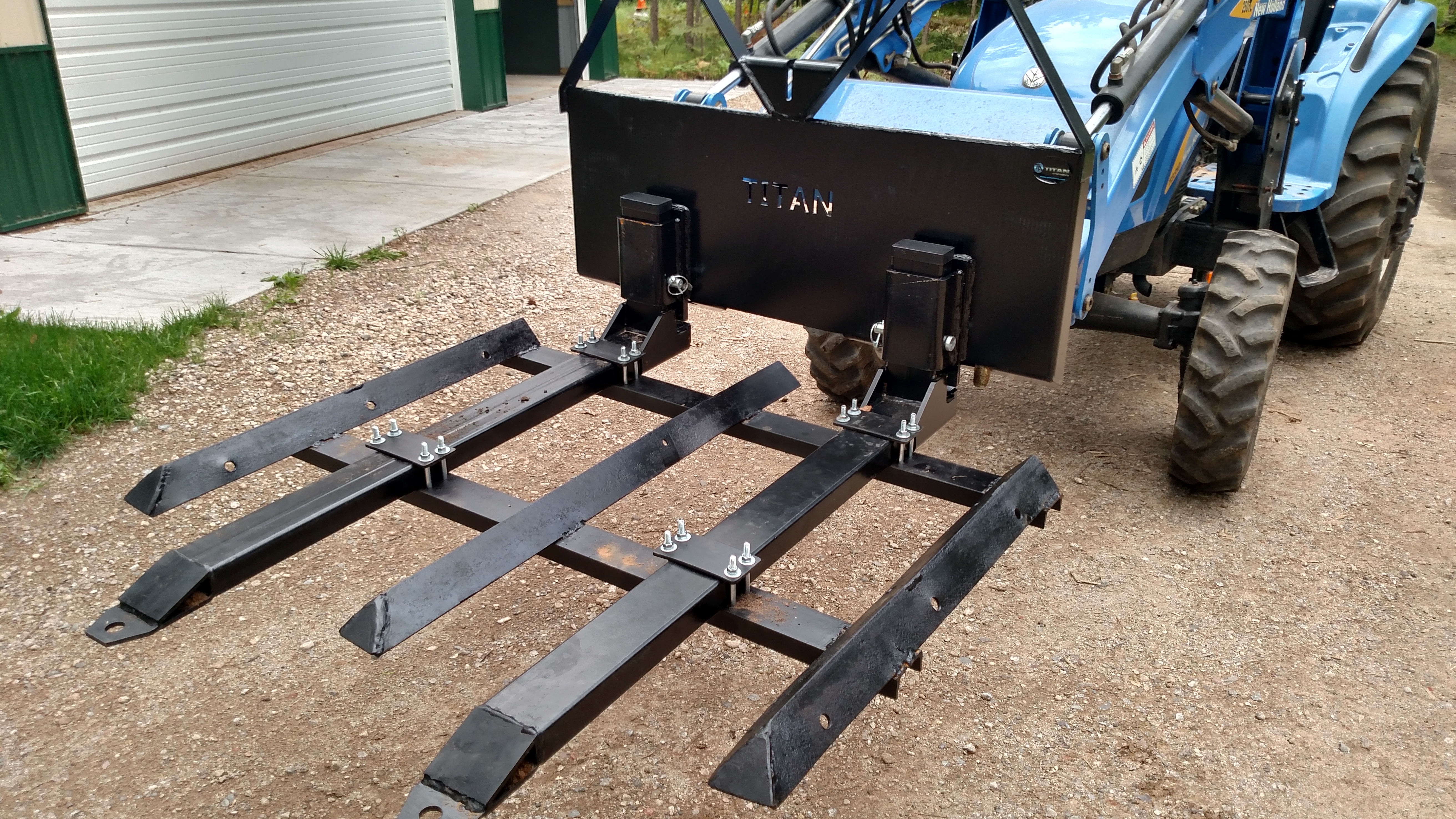

I hate dragging brush to burn piles. I have been watching for a good deal on used forks/grapple/rock bucket to no avail. On a whim I found that Titan was having a sale on forks, and got SSQA fixed width forks for $251 with free shipping! I looked around and rediscovered a couple of pieces of scrap 3" x 1/4" angle iron so I decided to build some bolt on debris forks. I bought some 3" channel iron to weld the outrigger forks to, and some 3" x 1/4" flat to be the top of the "clamps. They are 52" wide. Total cost $40 and I no longer have to drag brush!
Concept
Constrution
Painted
Done
   / Debris Forks for Ttan Pallet Forks
#2
Loaded :)
