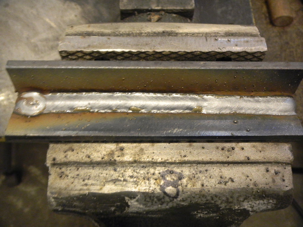

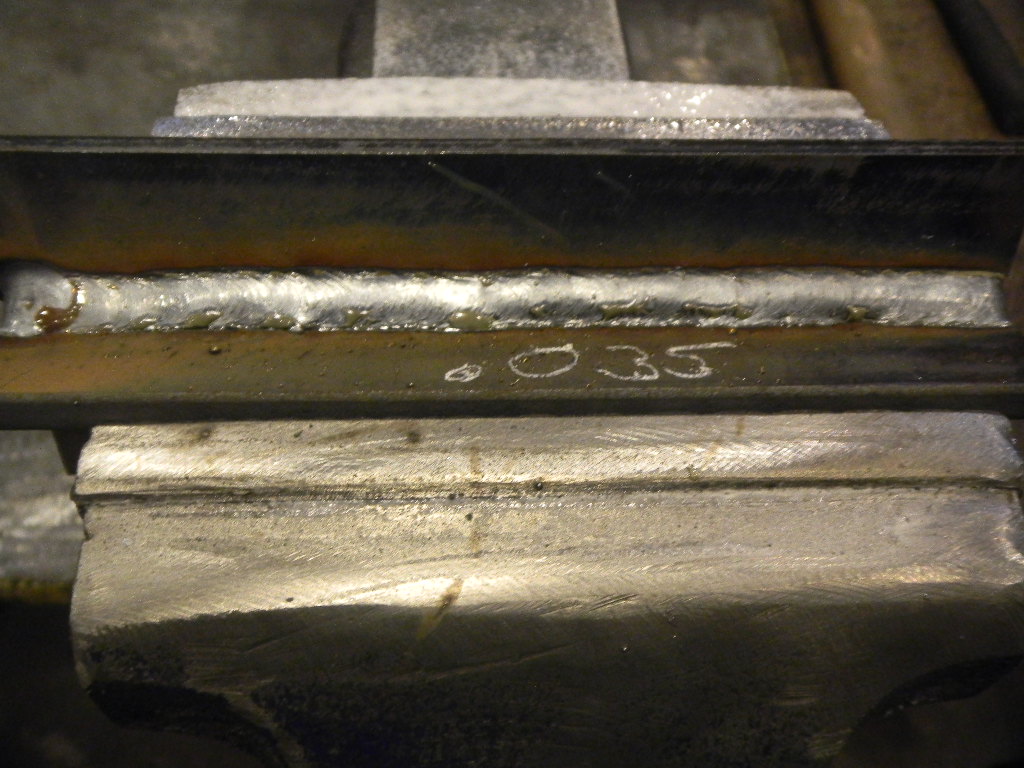

Here's some Mig welds I just did with a 46 year old SA-200, (no CV box) LN-25, and C25.
Those are nice welds. If I could find a used VS feeder CHEAP ($100 or less) I would probably pick it up. I dont really feel the need for a mig right now. I would rather have a tig rig for it. But if I found a deal that good I couldnt help buying it.
