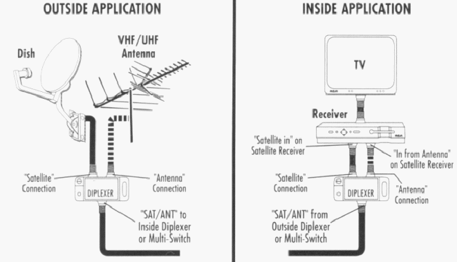

Also, if you're going to have a dish and an antenna, you can combine them onto one coax using a diplexer as in this diagram.
