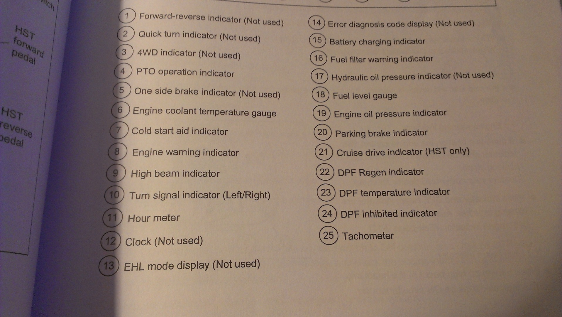

Hey guys. Today I was pushing some snow with my XR4046hc. I put an Express Steel 7ft snow box on it. Very nice quality. At one point I noticed a red indicator in lower left corner of dash display. Looked like a circle with and exclamation point in it. It went off on it's own and never came on again. Does anyone know what that symbol is? I don't have my manual yet so I can't look it up. Thanks in advance.

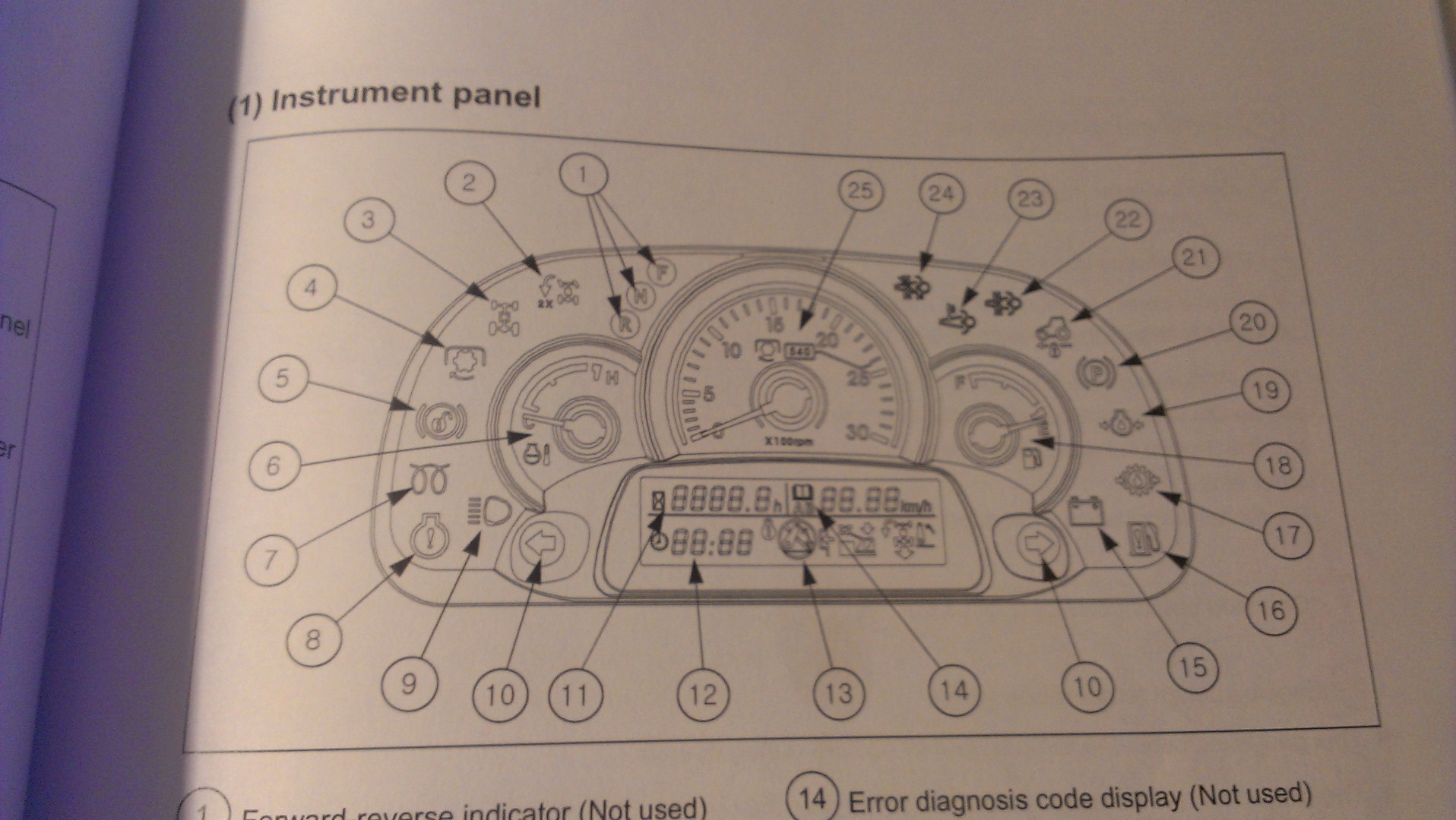

The Circle with the exclamation point is an engine warning indicator. If there is a fault on the engine control, the light could be blinking or on continuously by itself, you should contact your dealer.

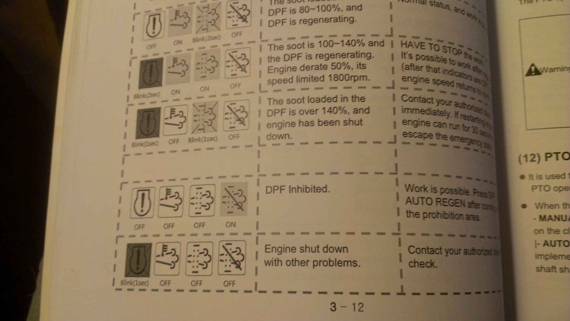

If that indicator (#8) is on at the same time as the DPF regen indicators (#22,23) is on it could mean the soot level is over 100% and the DPF is regenerating.
Took pics with phone so readable but not the best quality.

Suddenly I just remembered...(thanks to the picture George)..lol. Thats the squiggly lines that come on when you turn the key. I haven't seen my exclamation one come on yet and I hope I dont by the reading of it.

George, you're spot on. Thank you so much. Yes, that is the symbol. I think mine was solid and not blinking. Seemed like it didn't stay on too long. I think possibly the regen symbol was on also. When I was pushing snow, about 5 inches, I was running about 1600-1700 rpms. Enough power but not an overkill. I don't think I have seen it on since but I've only run it a short time.

I spoke with my dealer today in reference to the engine warning light. He said others experienced the same scenario with the light. Usually comes on with the regen. He said he had an LS tech tell him they could not come up with an explanation for it other than possibly high soot levels as the book describes. He did say if the tractor is in a regen cycle not to shut it off. Let if finish the cycle before shutting it down at any time. Normally he says power is reduced such as mjstef stated. Mine never seemed to have reduced power. Long story short, he didn't seem to think there was much concern with it.

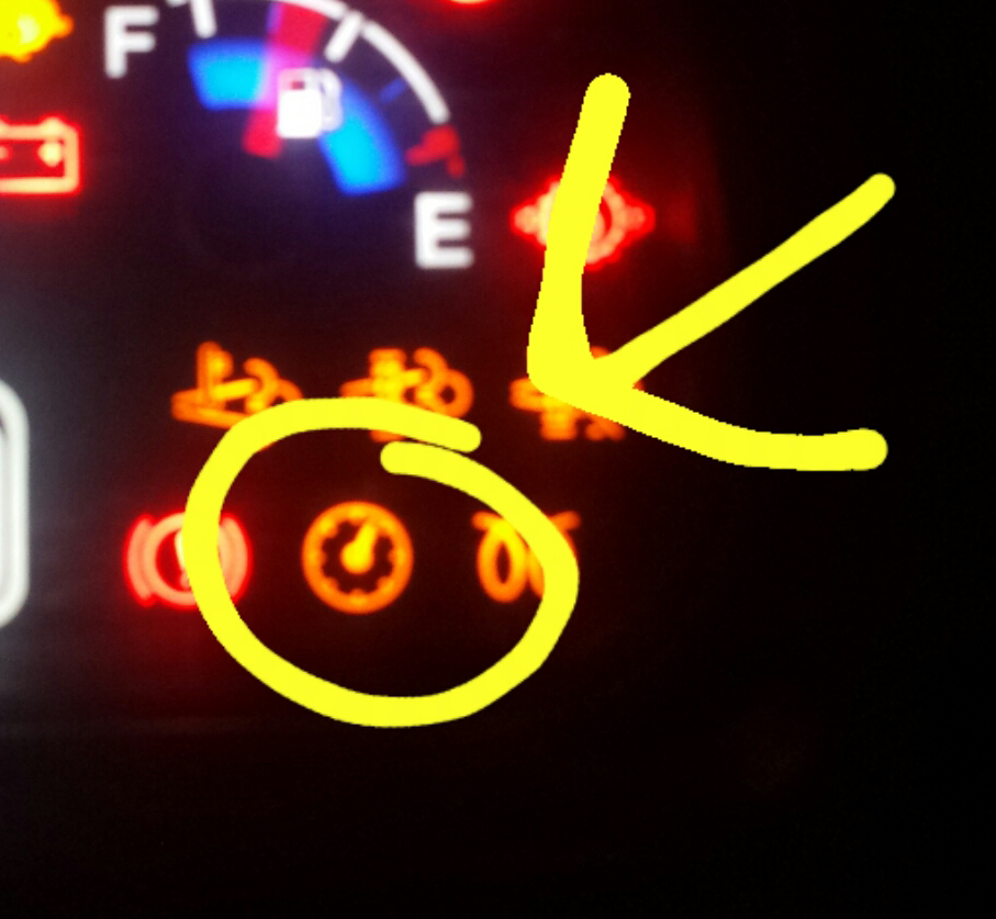

<img src="http://www.tractorbynet.com/forums/attachment.php?attachmentid=522868"/>
Anyone know what this one is? It blinks during operation
Maybe RPM too slow or too high? Not sure.
