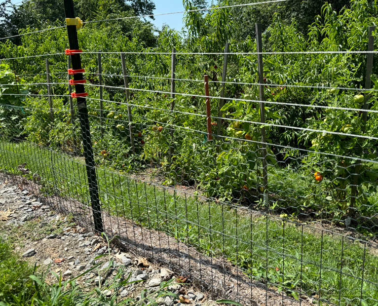

1 old man,
Here is a photo of my setup. The chicken wire is hard to see because I started with 2 x 4 inch welded wire 16 inches tall. But look at the post and you can see the chicken wire.
Note the red fiberglass bar in the center of the photo. That is my home made wire spacers. It keeps the wires very close the the grounded fence and then tight together as they go up.
I added a strip of gravel around the fence to slow the weeds. I sprayed the weeds yesterday, second and last time for the year.
The garden is maybe 40 x 70 ft, mostly peach and cherry trees (tart pie types : ) )
just inside the fence is a row of tomatoes/cukes/rhubarb. No till, a 3 ft wide mulch heap I can mow on either side.
Trenched in a pc of 3/4 pex water line, only 6 inches deep for summer water line on timer.
The electric fence runs 365 days a year, at night only. during fruiting season 24/day.
I'm so confident it works, we feed the deer just 75 ft away to veggi scraps. During peach harvest, we were dumping buckets of peachy bits.
no critters in the fence in 3 years. before I was trapping and shooting raccoons and squirrels constantly. stopped feeding the birds because the squirrels. now we are back to feeding the birds, and a bunch of dam squirrels.

That's interesting. I want to do something similar except use 4'tall, 2x4" fencing with 3 strands of wire on top. The deer are raising the devil with my new fruit trees.
Except my peach trees; one strand of parachute cord at 12 feet seems to be keeping them away.

Paddy, very nice set up and the garden looks great. (I may steal your idea!) Thanks
