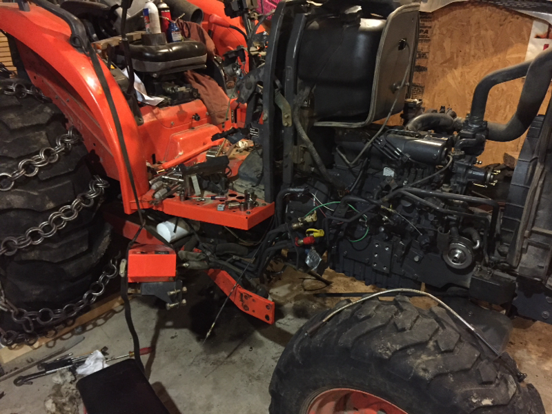

Not wasting any time at this point. Might be ready to fire by Friday.

   / Damaged block installing block heater L5240 #402
Nice, you can see the light at the end of the tunnel.
   / Damaged block installing block heater L5240 #403
Making good progress!
   / Damaged block installing block heater L5240 #404
Remembering how it all goes back together?
#405
Well, I must say there have been a few parts where it has taken me way longer than it should have to put on. The steel hydraulic lines are like a puzzle. I have those sorted out now.
Tonight I took a step backwards. The wiring harness passes through the fuel tank support. The fuel tank is hanging over the valve cover. I need to adjust the valves, so it all had to come back off tonight. I have help on the way tomorrow night to adjust the valves, then it's a marathon night to get everything else done so I can fire her Saturday evening/afternoon when I get home.
I have to pick up another gallon of oil, oil filter and fuel filter also.
Fingers crossed.
   / Damaged block installing block heater L5240 #406
Maybe I missed it, but did you get a block heater installed?
   / Damaged block installing block heater L5240 #407
Well, I must say there have been a few parts where it has taken me way longer than it should have to put on.......
Nice that you are sauntering down the home stretch toward the finish line.
This thread stands as a fine example of overcoming adversity - having the fortitude to stare down a tough situation and doing what's needed to put it right. Good for you. Thanks for the inspiration! Dick B
#408
Yes. It was much easier to install the block heater with the engine removed. I should have done that in the first place!:mur:
   / Damaged block installing block heater L5240 #409
Too funny! U mean the gas tank must be removed to adjust valves?
   / Damaged block installing block heater L5240 #410
That's good to hear. I can't imaging not having one if you need to use it on some of the really cold days. Mine does such a great job I end up using it more than I have to. It make the engine purr like it's summer, rather than taking 20 minutes to get up to temperature.
Good luck on your final steps.
