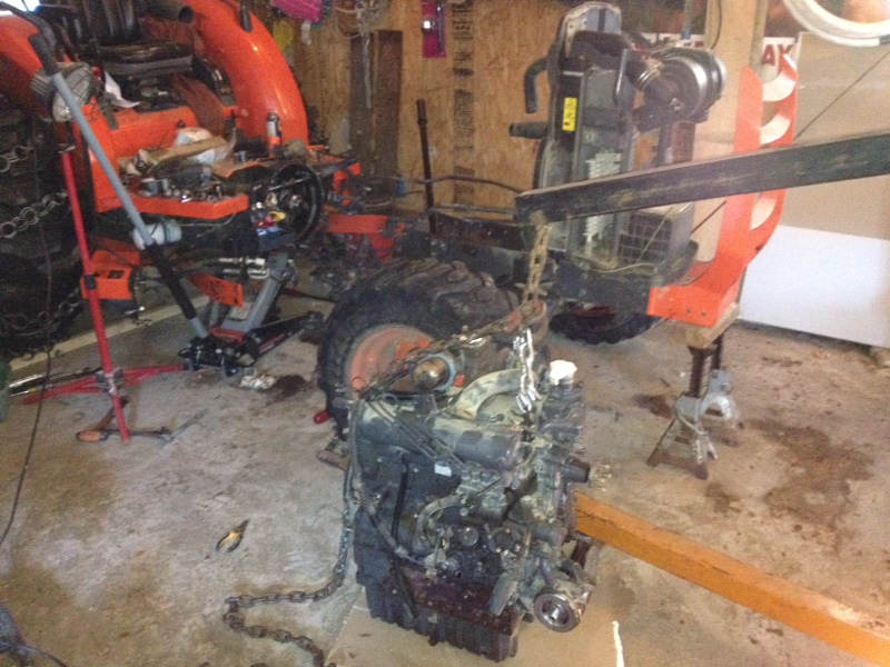

More progress.. Did this before lunch today.

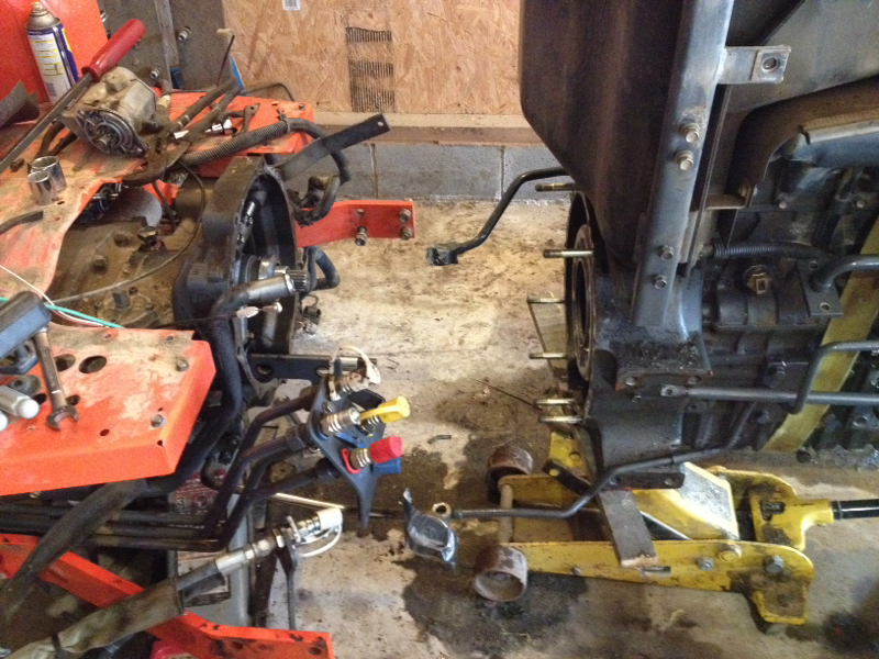

And this after lunch.. Called it quits at 3pm to take the kids bowling.
