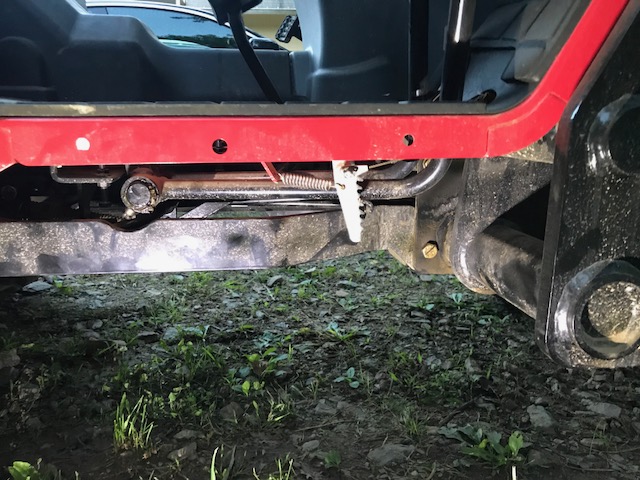

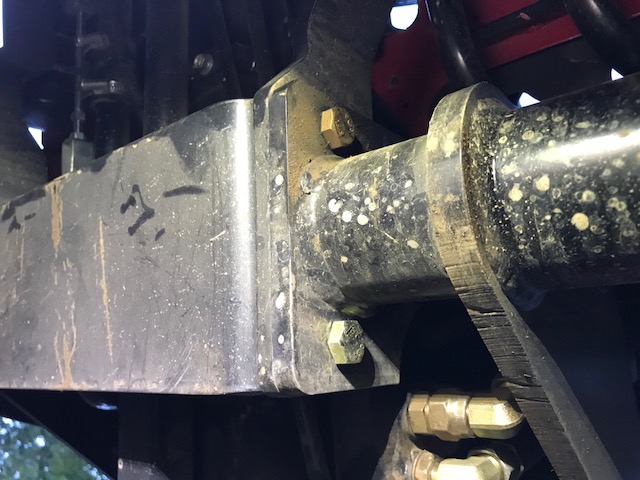

I thought all modern tractors had subframes to support the FEL (and backhoe). Otherwise, what do they mount it to? The front bumper? :laughing: Got me curious, so.....
FEL attachment on far right, showing how it attaches to a metal frame piece that runs front to back on both sides. Also supports a BH if you have one.
From the front, showing how the FEL also bolts onto a frame cross-piece that runs between the left and right FEL attachment points. (Also acts as an ad hoc skid plate.)
Closeup of the cross-wise frame piece that the FEL bolts onto.

I can understand having the subframe extending to the rear axle. I don't understand, however, the effect of the crossmember under the bell housing connecting left and right towers. I can see where it might absorb a little twisting force and maybe that is enough to justify the expense.
