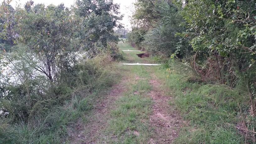

Right now the pond has an 8 inch overflow pipe. Looks like the pipe got clogged during the storm, which caused the water to surge over the dam. I know that the dam was not constructed propel now - its pretty evident based upon this failure. It was installed a long time ago by a previous owner.

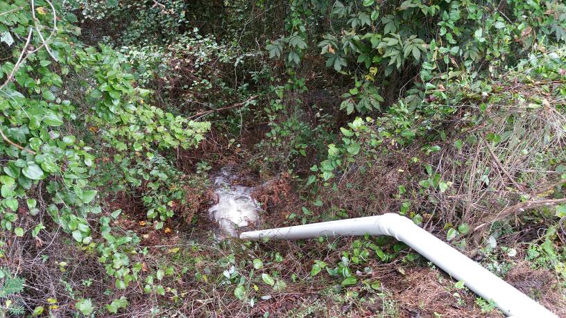

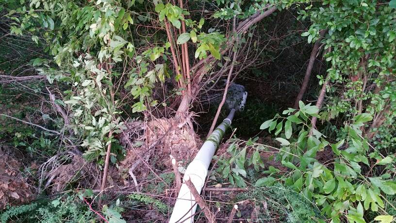

Well we were able to get the over flow pipe unplugged, which is helping quite a bit. I also got a 4 inch pvc siphon going. I'll probably end up putting together another one this afternoon. Hopefully we can get the pond safely drained in a few days.

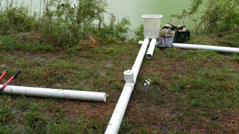

Here is the siphon pump that I built - it took about four trys, but it finally started working - quite well I might add!

Impressive!
Did you use the the clean out to start the siphon?
Later,
Dan
Yes - I capped one end and filled up the pipe using the clean out. Then I closed off the clean out and removed the cap from the out flow side. I got another one set up and working this evening...
