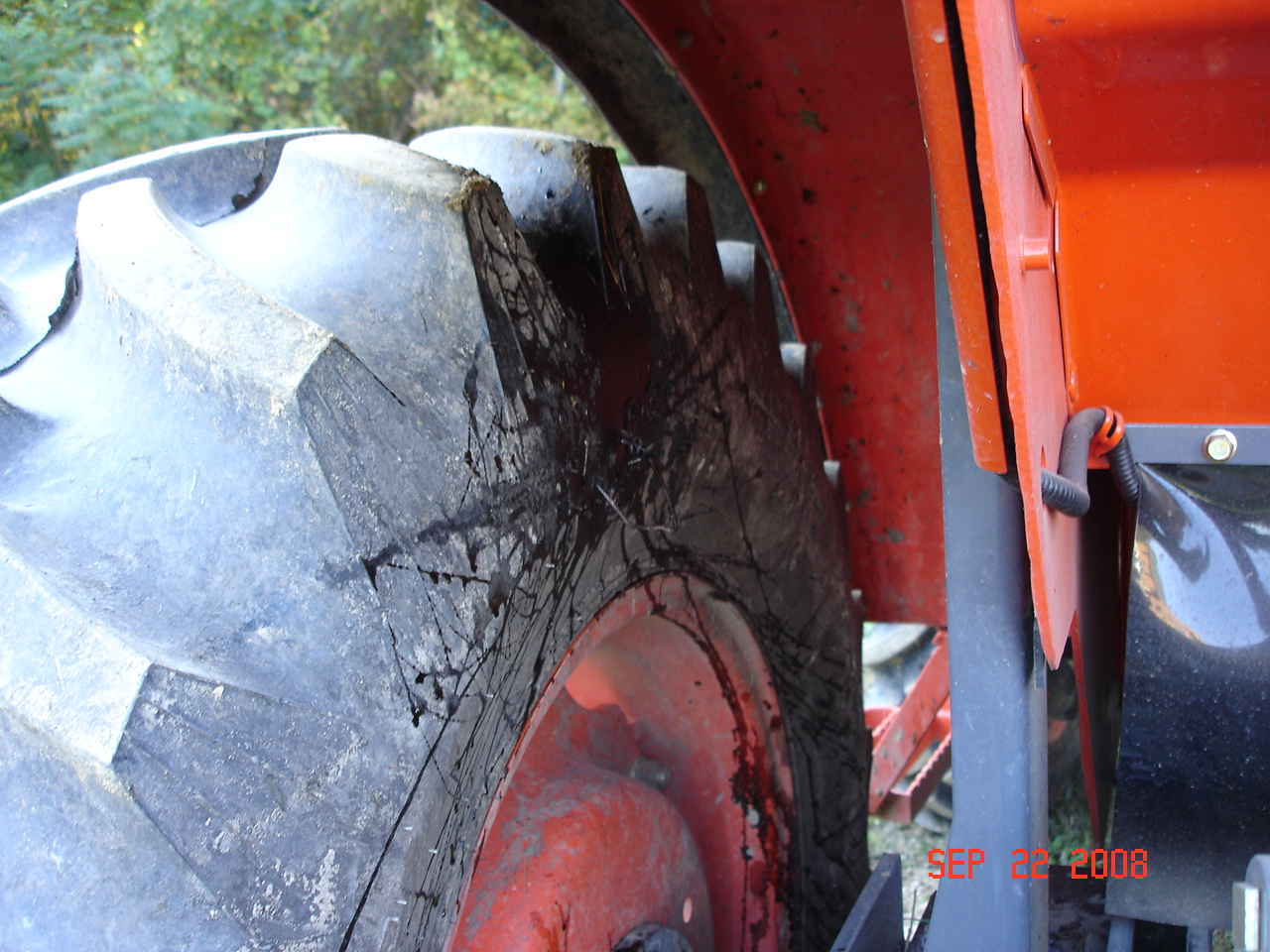

It's my wife's fault! Well....she kept bugging me to grade an area of the upper horse pasture through which the US F&WS and I created 5000 feet of new stream to move the channel back to where it used to be any moons ago. The farmers turned it into a roadside ditch which eliminated the trout population and after 80 or so years, also started sinking the farmhouse (which I sold back to the former owner). We dug a new E-type channel, and the spoil was sidecast and spread. As there is no bridge built yet (job #276), the horses were jumping over it and landing on some piles of dirt. My wife thinks they'll get injured or something.....yeah....perhaps I should make her watch them kick the snot out of each other a few more times - just for perspective. Anyway, I graded the area quickly before brunch yesterday. I came home from work today, and was ready to crank it up and move some round bales to storage - and the rear tire is flat. A small piece of barbed wire went thru the sidewall! Pic is attached. Forthunately, I unknowingly parked it with the hole at 12 o'clock, and It doesn't appear I lost much Rimguard. BTW - that stuff tastes pretty good.....
The tires are loaded, and I assume that they are tubeless....correct? If so, I also assume a plug will work, rather than a $200 trip to the industrial tire center....yes? I'm not a fan of sidewall plugs, but I am lesser so of giving up a wad of cash. One worry is that I make repeated (20+ round trips) from my farm to my neighbors farm transporting round bales, on the road at full speed. I'd hate to have a sudden air loss. Comments are always appreciated. Thanks.

That's what nice about using rim guard put a plug air it up a move on!;)

Well....yeah I tasted it....it looked good, and my tire was kinda' clean (on the inside).
Alright Captain Kioti.....I'll plug it up and go! Thanks.

Got a tire plug kit at Napa and successfully plugged the sidewall. I don't know how much Rimguard I lost, because the tire seems lighter than they did when I adjusted the wheelspan a few months ago.
Unfortunately, I buggered up one stud and lighly messed up two others takig the tire off (in the dark). The lug nuts went on and didn't strip, but they were cutting thread for sure.

Sorry to see the self inflicted wound, hate those.
I bet the plug lasts as long as the tire.
I had similar thing happen with a brand new mustang 5.0 I bought in 88, had it a week and hit a nail, plugged it and never had a problem. Took that sucker up to over 132 mph and that plugged tire ran perfect.

Must be a bit wet in the horse area. Spirit sounds as if he could use some hoof liners if the cracking is being caused by wet ground as opposed to percussion injury.Once had a horse with the same problem and the boots took care of that. This can get pretty serious so your mrs. should look into something protective if she likes the horse. Once the hooves dry out, the cracking should stop. If the ground is hard, and the horse is getting percussion cracks, it might be cheaper to shoe the beast if you're calling in the vet as much as stated. If you like beets, you'll like Rimgard. The worst fix for your tractor would be a tube if the plug works its way out. No need for a new tire at all. The most expensive part would be replacing the Rimgard so be sure to save as much as you can just incase the plug comes out.
