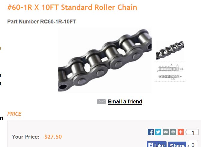

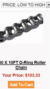

Are you implying o-ring chain will last at least 4 times longer as regular chain. O-ring seal lubrication won't keep the rollers from wearing on sprockets. Will o-ring lubrication keep chain cooler? The chains on a JD rd baler will get "HOT" even with motorcycle chain lube applied.

I don't think they would last that much longer. I don't see how they would run cooler.
