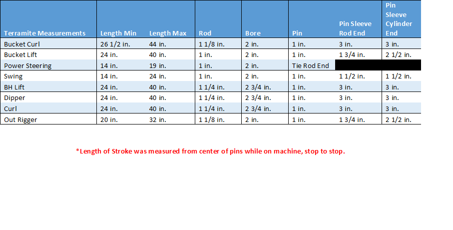

Can anyone provide a list of cylinder sizes? I can measure an see what fits from Surplus Center, but I'd really like to know what Terramite thought should be there...So if anyone has replaced cylinders, what sizes did you put where? Or anyone that could take a few minutes and measure the specs on the loader, stabilizer and boom/arm/bucket cylinders, I'd be grateful.

I got a 96 if you think there the same I'd be happy to mea sure them up for you this weekend

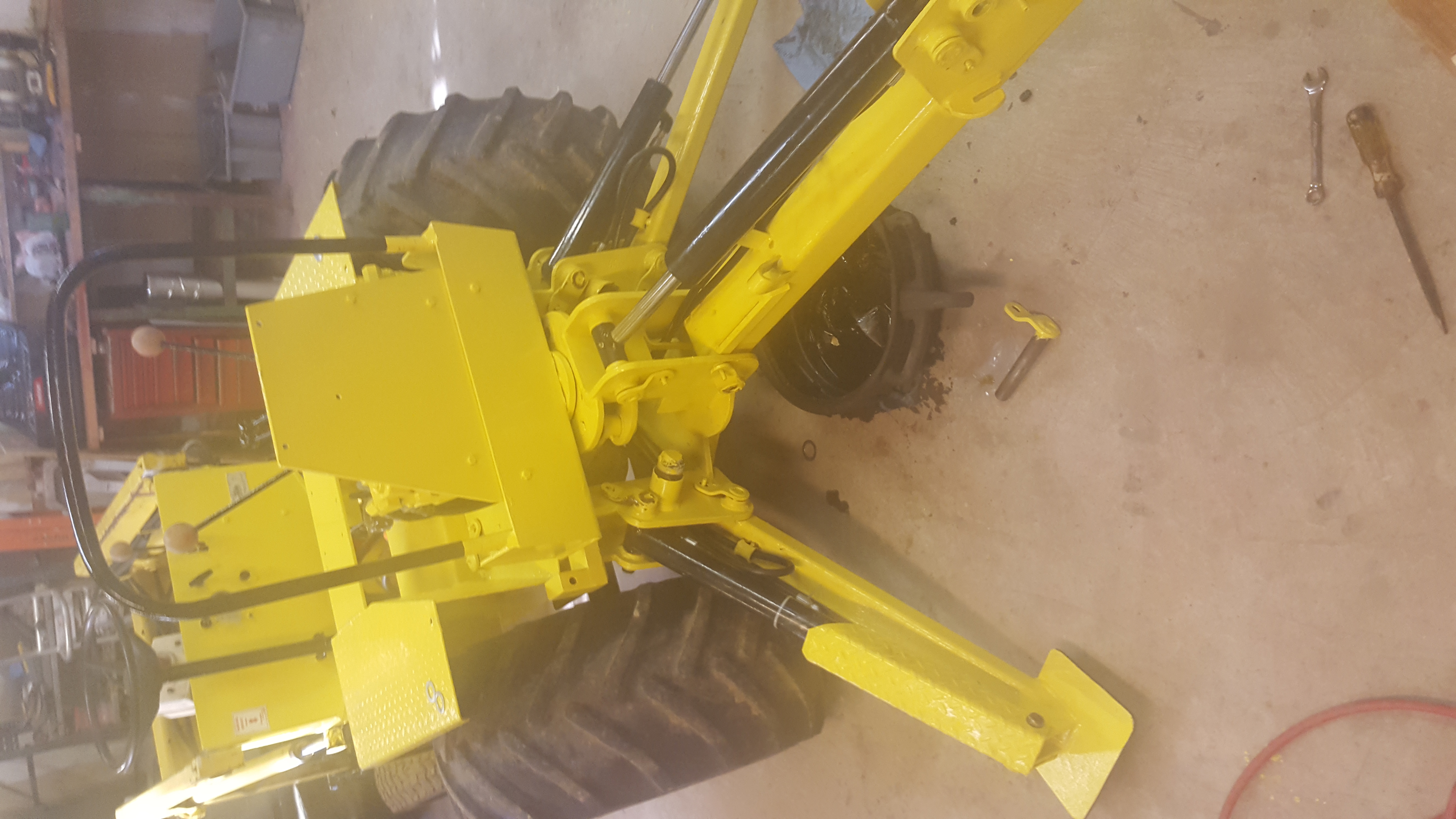

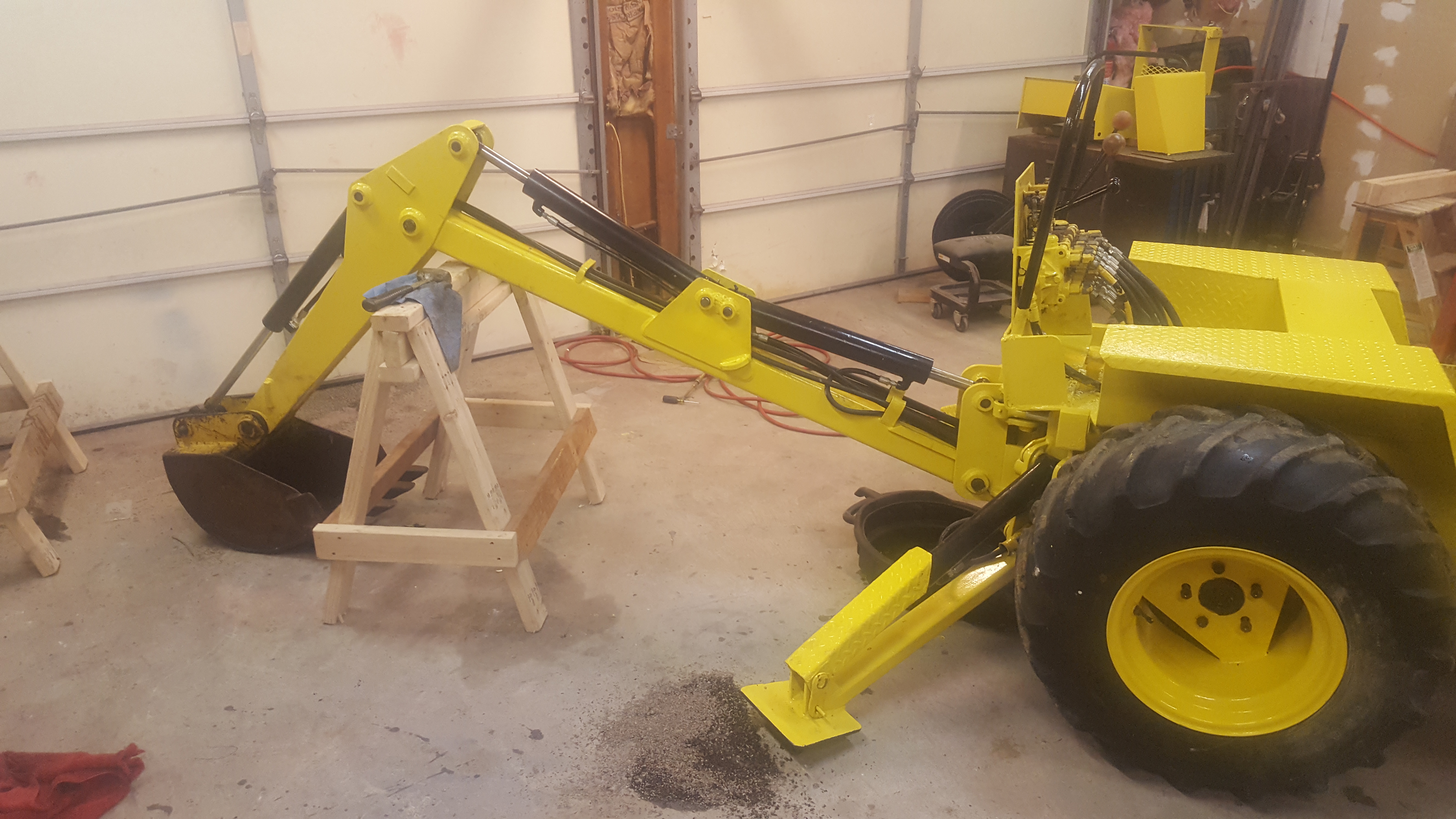

Here's a few pictures of my project. Glad you're not any closer to NY, I'd have to lock the garage!!!!Terramite_1.jpgTerramite_2.jpgTerramite_3.jpg
