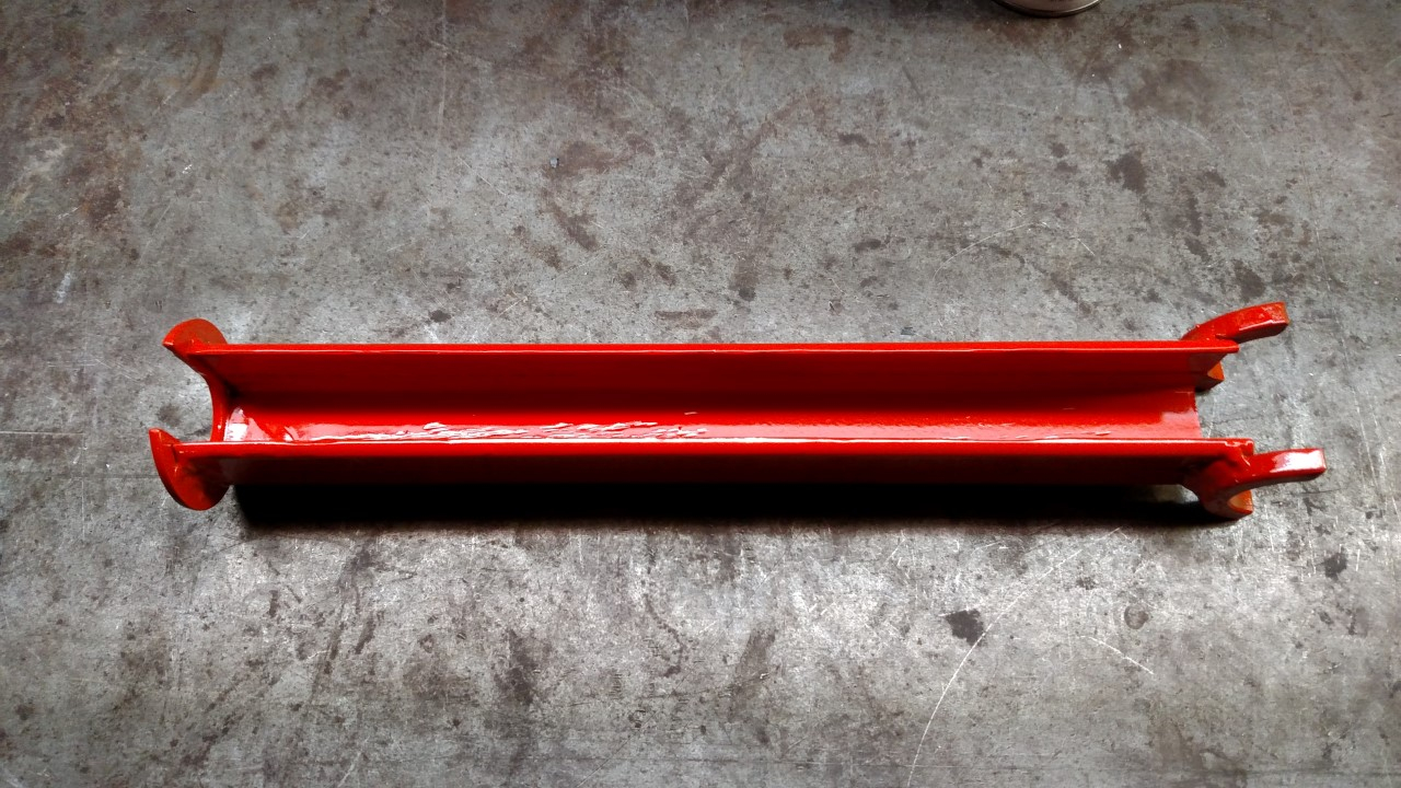

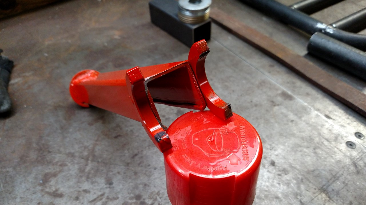

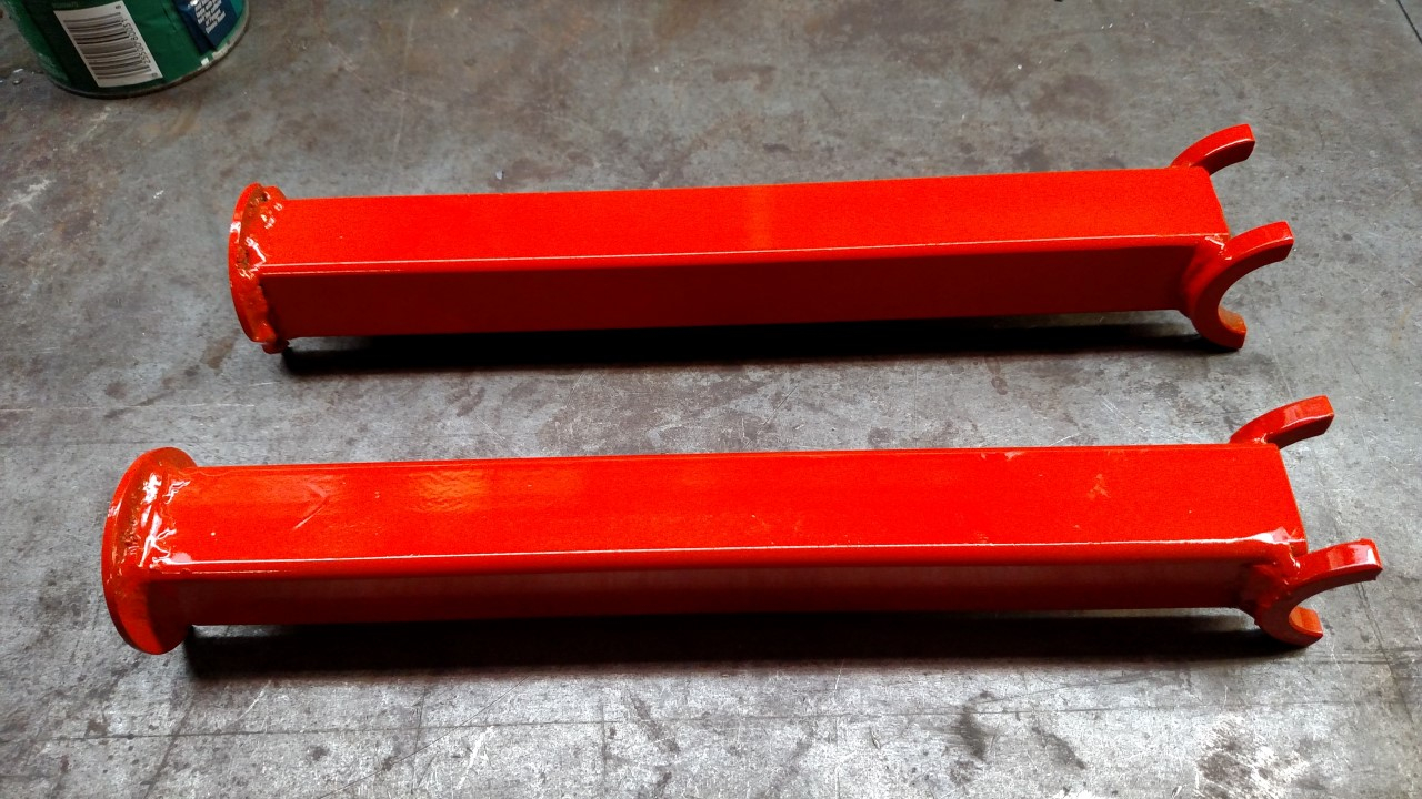

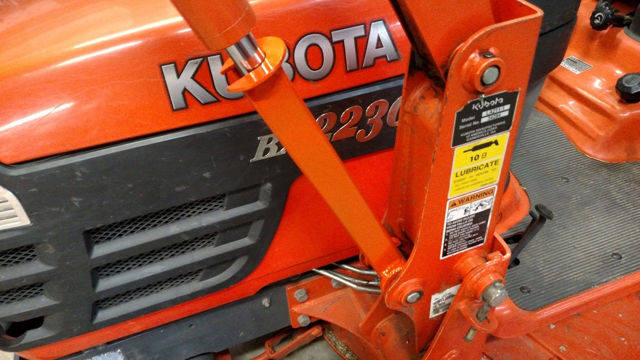

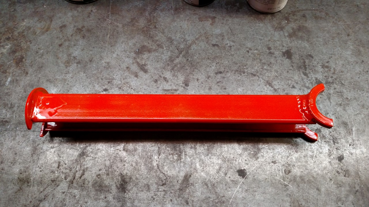

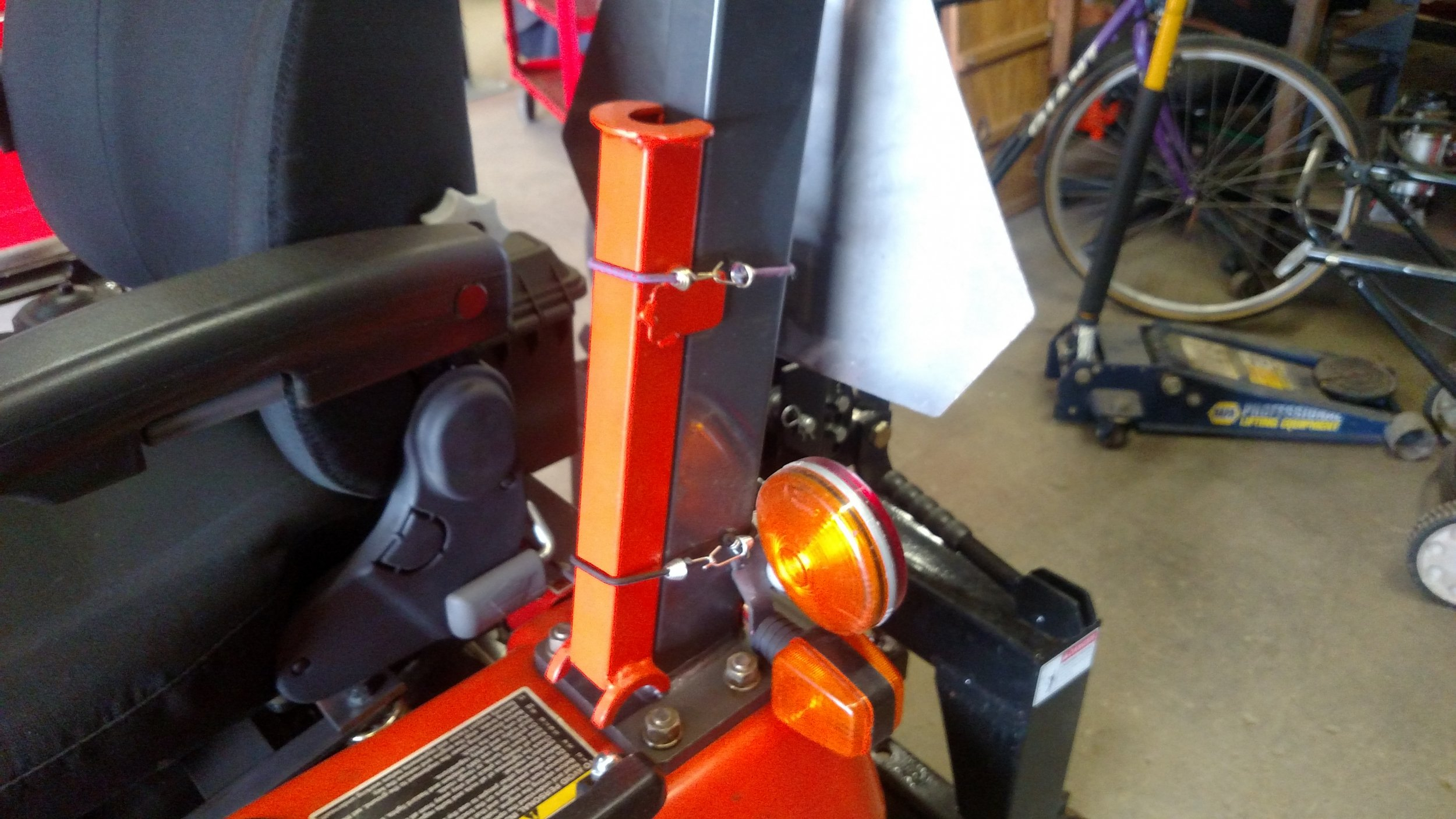

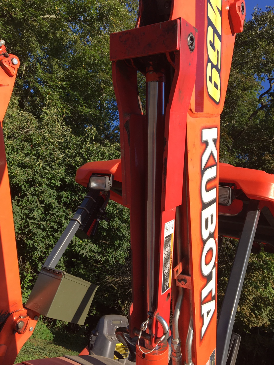

Here is what I made for a safety prop for the FEL on my BX2230.
Some 1 1/2" square tube, a 1" flat washer, and an 1 1/2" shaft collar were used, all of which I had on hand. Made two, one for myself, and one for my friend that also has a 2230.

Nice job!

OEM prop has a rubber bumper to protect the cylinder rod. Doesn’t take much to nick that chrome.
The bumper is rubber plug type that fits a drilled hole. Source might be rubber feet from discarded appliances. Or rubber strips glued.
