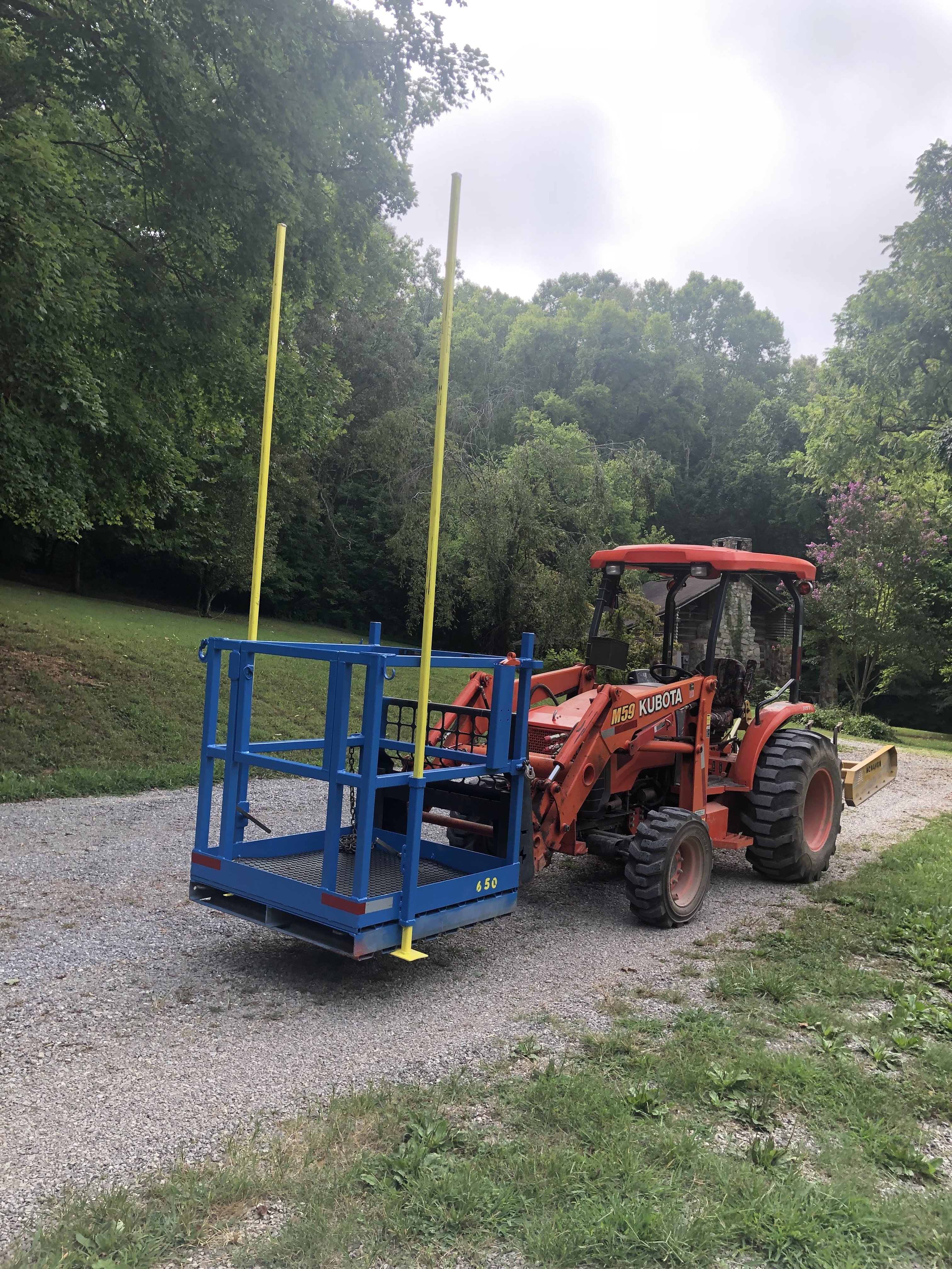

I need to use my forks to hold a work platform. I can tie in, so with the FEL arms safe, the "worst" that could happen is a complete hydraulic failure and the platform would go from horizontal to "dumped" and I'd be hanging. No where near as bad as getting crushed outright - but still not good.

A chain would work, but it does not let you adjust the angle when raising it. There is no simple answer to this that will meet your requirements involving stops that I am seeing. The simplest solution would be to put three or 4 legs on the work platform and lower them once the platform is at height. The platform is then not affected by any hydraulic drift.

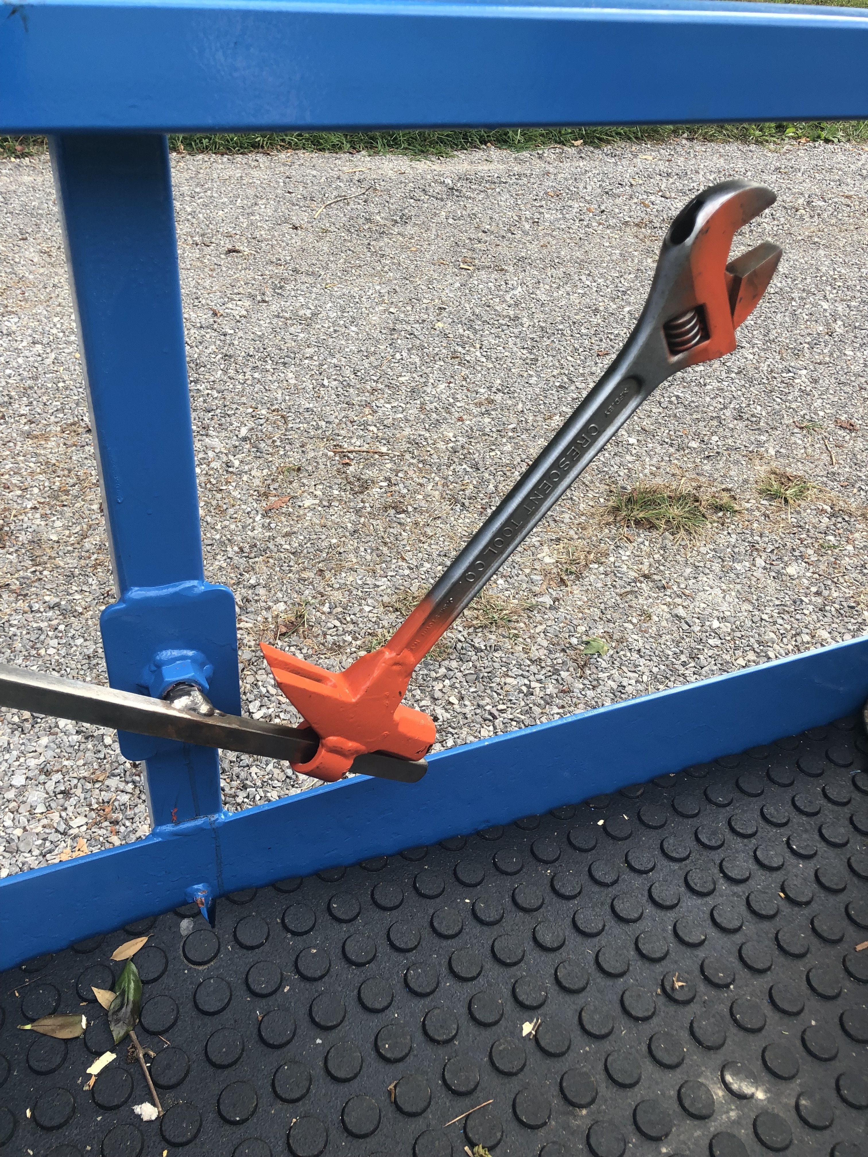

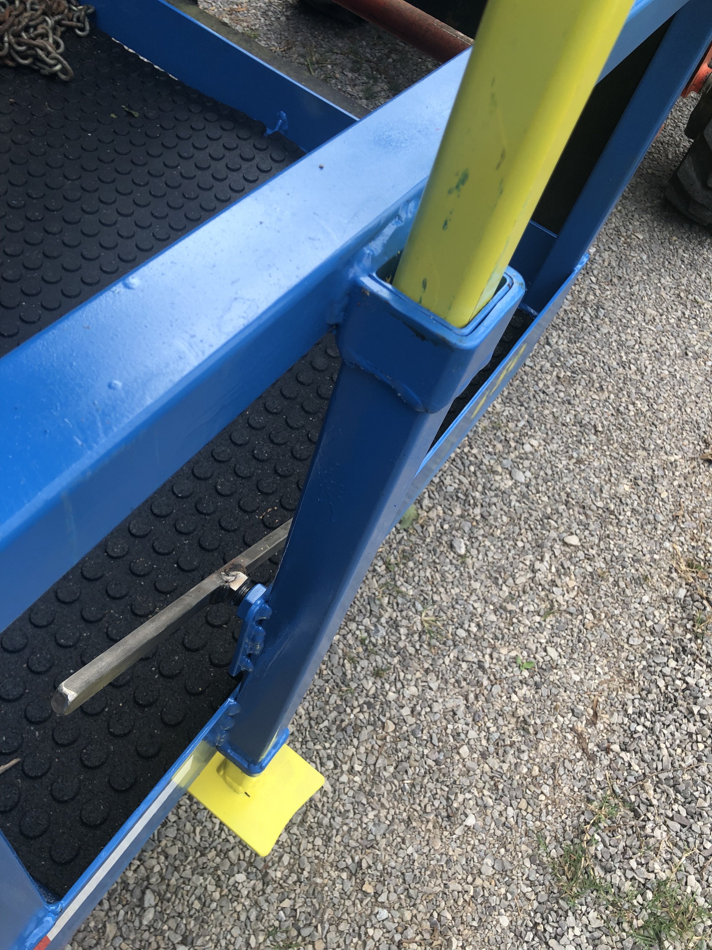

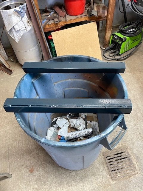

Wanted to test an idea and made these adjustable safety stands. Tested with 600# weight plus me with complete relief of pressure. One can support the load but a little bouncy. Admittedly don’t always use them but nice option depending on the job.
