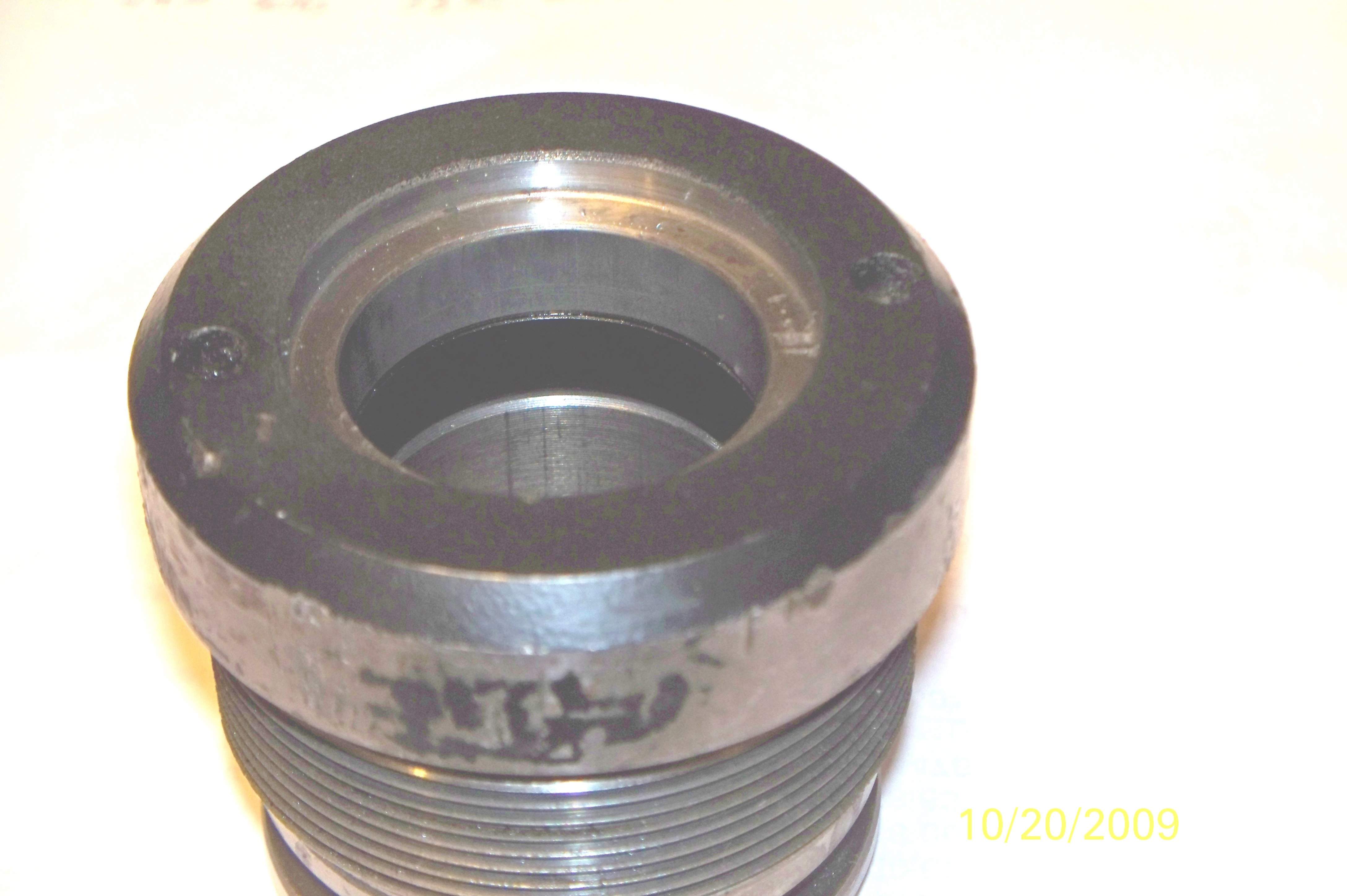

I am repairing cylinder on fel . It is an allied loader. Have seal kit on hand. My question is how do you replace the U-cup in the head plate. Any help appreciated.

here is a picture of head plate with old u-cup inside. need to remove old one and install new.View attachment 143164

You should be able to use a pic or small screwdriver to pry that one out, the new one will prob be stiff and you have to fold it to almost look like a C shape to get it down inside and then keep working it around till it fits in correctly. Lube it up with some STP or oil to help it slide in. I redid a couple of mine and they were really tight getting that thing down inside that hole, just takes some time and when you get everything right and have your tongue in just the right position it'll slid in....... hopefully.

Like Top said-just pick-pry the old one out...then I boil the new ones in water to soften them up before folding into the C shape to get them in there.

thanks everyone , i was thinking something like that or take to a machine shop. kept looking for a place to seperate the head thanks again
i did like you said and it was a snap, i was afraid it would break the seal to fold it that much. thanks
