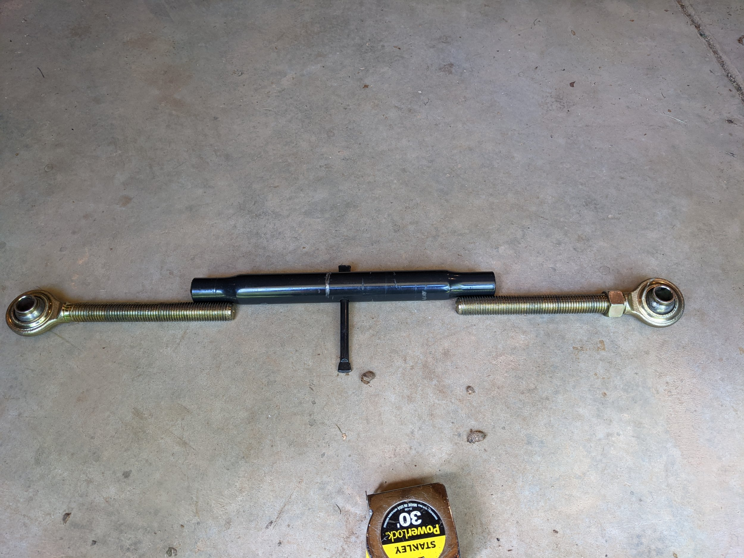

CX2510 top lengths?
   / CX2510 top lengths? #2
I can get you the closed measurements tomorrow. I'm looking to do the same but will order it from Fit Right Hydraulics. @MtnViewRanch
   / CX2510 top lengths? #3
Closed, center eye to center eye it's right at 19 inches.
What I would consider fully open (pic) is 29 inches.
   / CX2510 top lengths? #4
Based on the info supplied, I would say either a 19 1/2"- 27 1/2" or a 20"-29".
It is actually better to get the asked for dimension of the following link and base the best possible working length off of that dimension.
   / CX2510 top lengths? #6
"The best way to do this is to have your tractor hitched up to your box blade (as an example) have the implement level with the ground front-back and side-side. Have the implement on the ground, measure the pin-pin distance."
So would this distance ideally fall right in the middle of the closed/open spread?
   / CX2510 top lengths? #7
Typically for tractors with a 7" stroke or less, centered generally works the best. For 8" and longer strokes, 1/4"- 1/2" more retraction than extension seems to work well.
