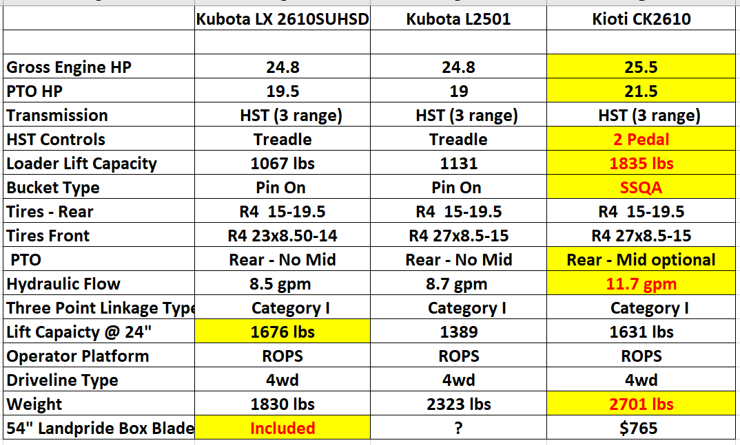

OP - I just went through this decision process (with great help from this forum) and settled on the Kioti CK2610, which arrives this Friday!
Compared to the Kubota L2501, which seemed to be the most comparable model, it seemed to have similar quality, more features and was $4400 less. Easy decision for me.
Note: I am not a tractor expert, just a newbie....
