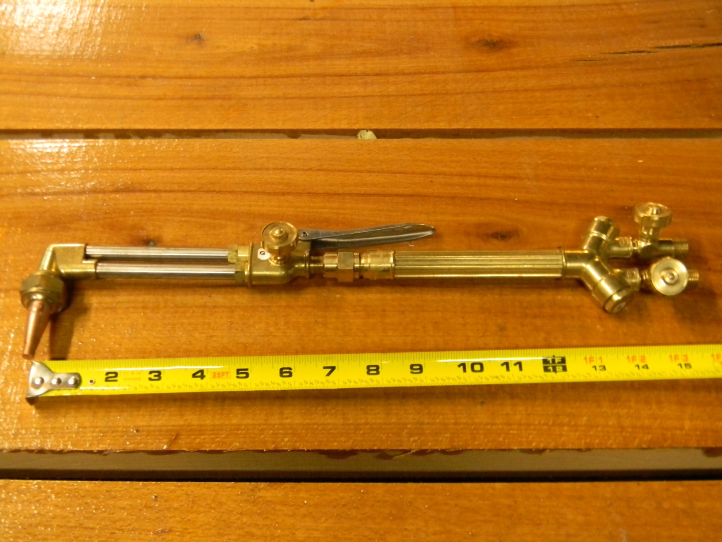

I have several Victor cutting torches. The smallest is this WH270FC=V with a CA270-V cutting attachment and #0 0-3-101 tip (I have different size tips). It is about 16" long. I see a similar new one on Ebay for $125.
I bought this one in new condition at a flea market for $50. Its a good size for homeowner use.

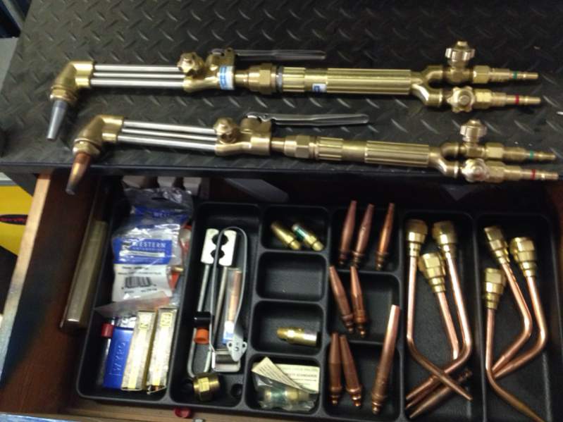

I have a bunch of victor 101 torches they are small enough and can cut through 1/8"- 12" of steel with the right regular and tips.
I had a HF ripoff for a few years before some one decided to steal it from me, the finish was poor but it worked as good if you used victor tips.
The smith we have has issues with the style seal they use. The handyauto torches are very nice if you have a job that suits them. The other ones I use are more "wreaking" torches to me.
