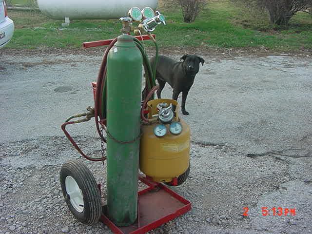

I also took a couple of pics of my torch and added some labels to show what I'm talking about... The pics aren't the best, since I couldn't get the camera's light metering mechanism to cooperate and get a good detailed image of the flame. I shot 1 pic through my welding goggles, it is a little better. But, I think this illustrates what I'm trying to explain...:)
If you take your oxy-propane torch, and preheat with the flame tips on the edge of your workpiece, you'll see that it is fairly slow to heat up to cutting temperature. But if you raise your torch so that the edge of your workpiece is in about the middle of the "zone" in the picture, you'll see that it comes up to temp very quickly. The drawback with propane is that the heat is not as "focused" as it is with acetylene. But, it still works quite well. Like I said earlier, it's just "different".

I went propane when I bought my own outfit. Its safer, way cheaper, and not that much worse for getting started. It cuts just about the same once started. The same rules apply, clean tip equals clean cut.

Like propylene, most propane tips are of a two piece design. Propane often gets unfair criticism because it really needs changing your torch (from an equal pressure torch to an injector torch) and not just changing your tip to get the best performance. Most torches are equal pressure and designed for gases such as acetylene which are lighter than oxygen. Propane is a great deal heavier and runs much better through a low-pressure injector torch with a setting from a few ounces to about two pounds per square inch when cutting.
