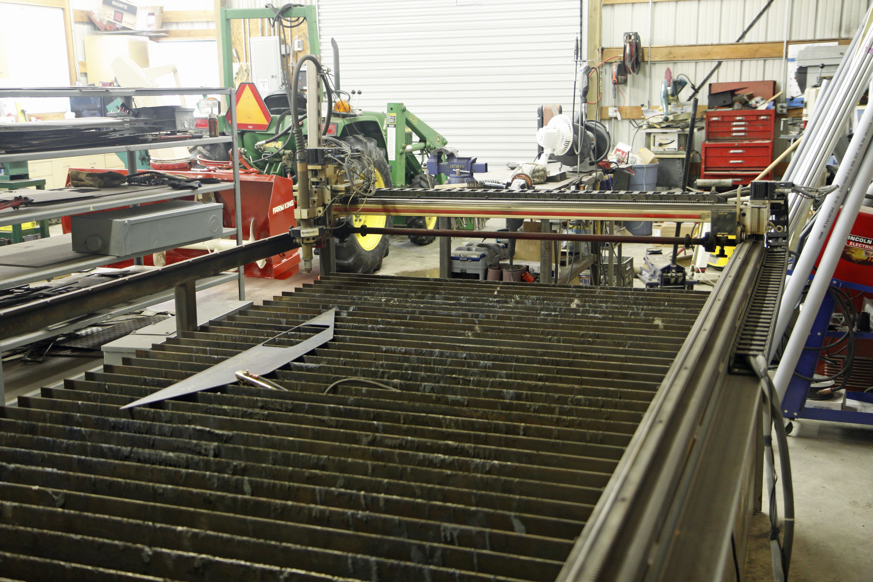

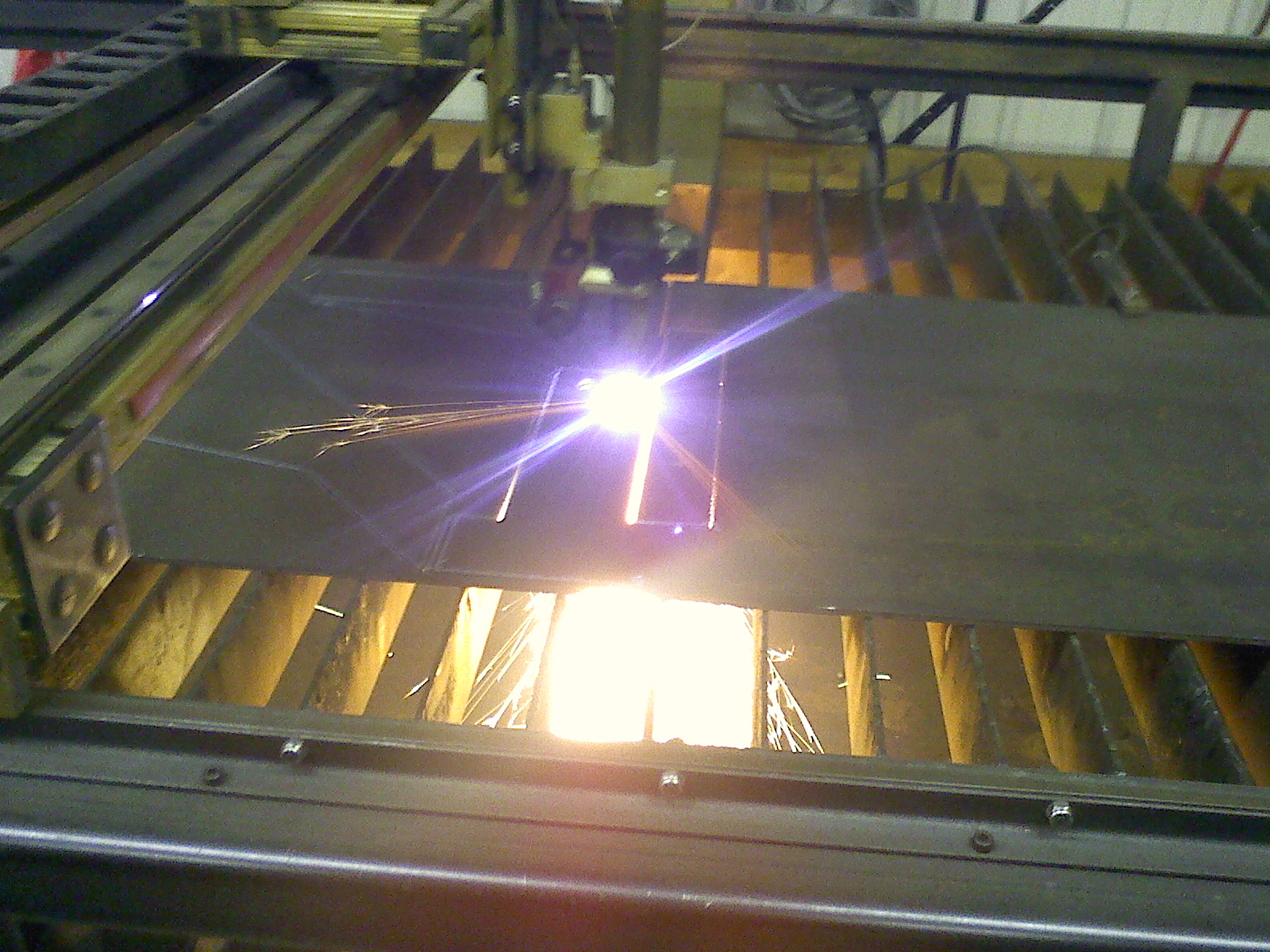

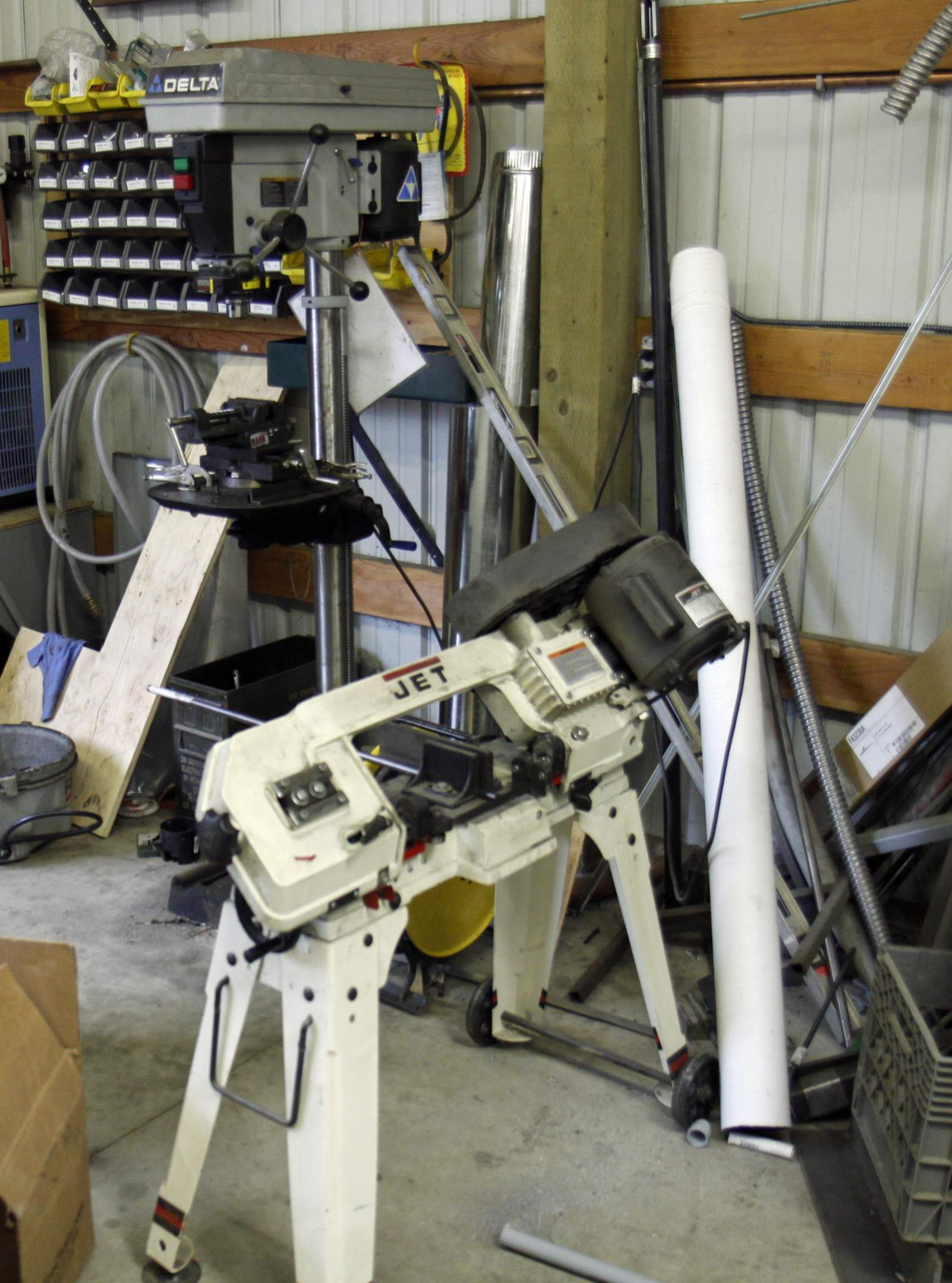

I have a Jet dry bandsaw, and use it regularly. Ive been thry 3 blades in the past 8 years. id say thats pretty economical. Machine is worth every cent it cost, and that wasnt much.
I also have a portable hand bandsaw (a rigid portaband) and use it at work. Its a great little machine also, cost around $300.
For the big projects i have a 4' x 10' CNC plasma cutter machine.....now thats styling.
