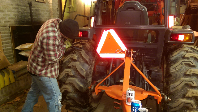

That is a beautiful fireplace! Now, how did you get the tractor in your living room? :eek::eek:
You know what's funny? I've never even used that fireplace! Bought the place 4 years ago but the fire place looks a little shaky so I've been too afraid to use it. Plus, that side of the barn is about 20 feet high, so it would take quite a while for that fireplace to heat the barn up enough to make it worth my while. Been saving up used oil because I'm hoping to get a waste oil furnace sooner than later.

Hi, OP here. Since I first grooved my tires ~4 years ago and have put ~200 or so hours on since then I wanted to comment on the impact on tire durability once again. In the past 4 years, I've used my heavily loaded tractor to its limits in dirt, gravel and snow. I say heavily loaded trator because the tractor itself is only 2300 pounds but add 600 (filled tires), 700 (rear weight) 300 (steel cage) 800 (loader with tooth bar) and that weight doubles to ~4700. Put my butt in the seat and we're at nearly 5000 pounds on a little 20 hp LB1914. I've experienced great snow / ice traction since grooving the tires and this traction has not seemed to fade with time. I did not experience a noticable difference in mud, hard packed dirt or gravel.
The primary reason for this post is to report that despite my best efforts to destroy my tires by spinning them in gravel and dirt while pushing into piles or while skidding logs, I have not had any chunking or tearing of any lugs. None. Considering the relatively high weight for the little tires I have, I think I've given them a good trial. However, I want to note that some on here have grooved much more agressively than I did and I'd be interested to hear their experience after a few years of operating.
