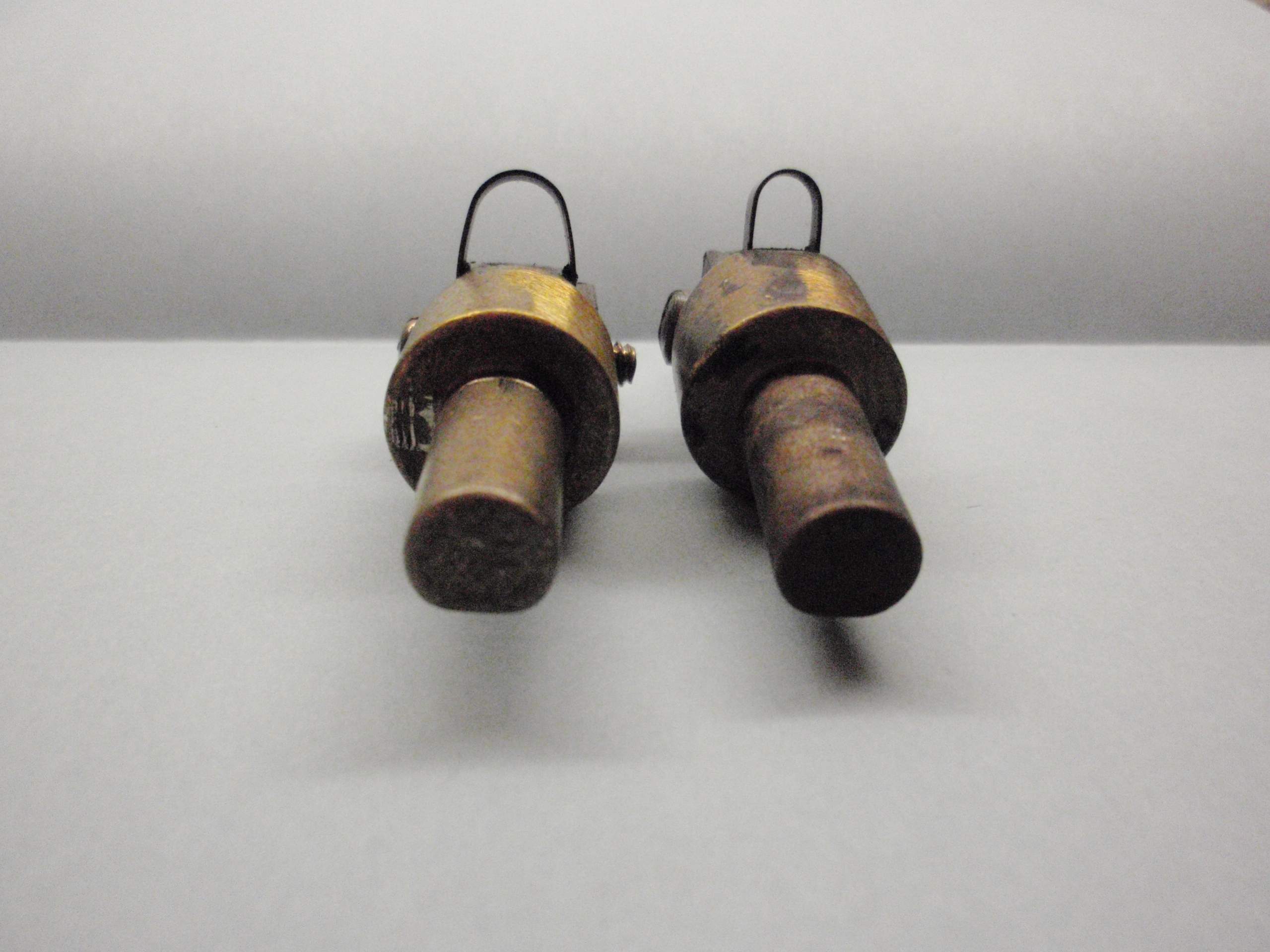

OK, my Ideal heated Kinfe came on Friday. I ordered #4, #5, and #6 heads and blades. I started thinking about it and decided to wait till I ran this idea past you experienced guys before I started cutting rubber. Waking up on Sunday morning I had a brainstorm and went out to the shop to try it. I assembled a #5 cutter on a #6 head. Below I have attached a photo showing the weird combo #5 cutter on a #6 head on the left, and a standard #4 head and #4 cutter on the right. Hopefully the picture is clear enough so you can see the result. The weird setup gives non-parallel cut lines. I am thinking this will allow the mud to eject more readily. I cut some grooves in a rubber mudflap, and the grooves are still very sharp at the edge, so I am pretty sure the edges will still cut and grip. And of course regardless of the shape cut, the knobs will gain in flexibility, which gives grip too. Any thoughts? Thanks.

I like the looks of the #6 head.....I would definately consider using that on the rear tires. I wish I had one of them available when I did mine.
My problem is I usually have too many thoughts and nobody wants to hear them :laughing:
Agree mud should eject faster - but in any real mud they will still pack up. Down side is they wont hold snow as well so less snow traction. Just my thoughts. I could be way off.
Speeking of snow, I noticed that my 1/4 inch deep #4 head grooves don't hold snow nearly as well as my 3/8 inch deep #4 grooves. So I suspect I'm getting a lot better snow traction out of my rear tires than the fronts. I can't go any deeper on the fronts, only 1/4 inch of tread left. I'll go deep on them when I get new tires.
   / Cutting / Groving / Siping R-4 for snow #120
I would just use the right blade with the right head. For whatever reason, the directions say to be sure to only use the right blade and head together......Not sure why.....
I think you would want the cuts more open on the opening edge, and if anything they could be narrower on the side twords the core of the tire. Your combo does the opposite of this.
I would personally just decide on a size and be sure to cut them nice and deep right away. I wish I had cut mine just a little deeper (if anything, but I am 100% happy with them for sure).
