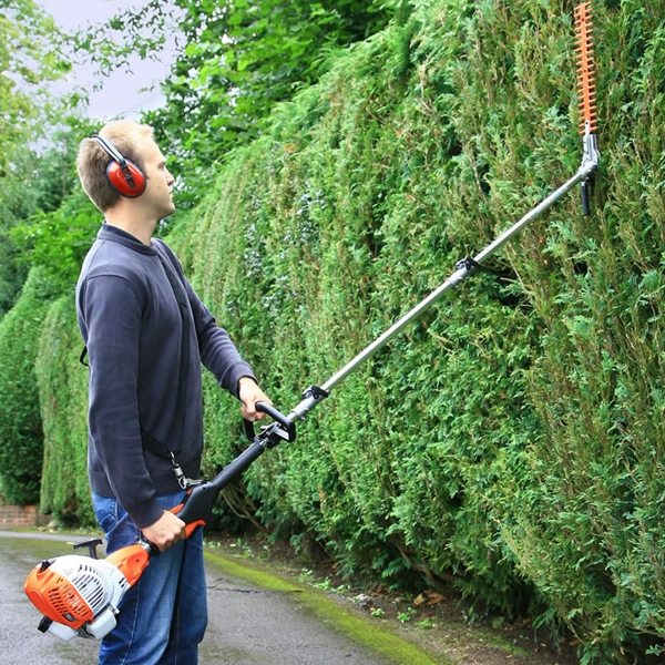

I've spent quite some time searching for an efficient way to trim my pond bank and I haven't heard about anything that works really well with minimal effort. The levee end of my pond is about 250' long and has a non mowable bank about 3' wide on about a 45 degree angle. After reading about the use of hanging push mowers, DR mowers, sickle bar mowers and weed wackers I started thinking about adjustable angle pole hedge trimmers. Unfortunately no one has mentioned one of these so I'm not sure about how well one would work. In theory and given my pond bank angle I think this approach would work well. Advantages would be that the weeds would lay where cut and not fly into the pond. This should also reduce erosion as the thatch would provide protection from rain induced washing. Any ideas or suggestions? Do you guys think this would work? I'd prefer to not invest in a sickle bar mower for 250' foot of levee and I certainly would prefer a save approach verses hanging a rotating piece of equipment. See attached link...
Thanks for any and all advice...

I think you will break that unit real quick.

I edited the original post with the correct picture.
JJ, I considered that attachment but I just couldn't justify it for 250' of bank that would be trimmed once a month or so. Otherwise that is a great attachment.

So here I put a pretty much unused lawn mower to use and for the $105 price for 2 tires off www including shipping tax and all, I got a machine that does the trick. You can't buy a hedge trimmer like shown in your picture for that. I put them on the stock wheels that were on the mower which were slightly wider (rim) than the tires. A real bear to get installed by myself, but having the wheel wider and them being 4 ply bias there isn't much sidewall flexing even at the 10 psig where I run them for riding comfort.......and I don't have to walk!

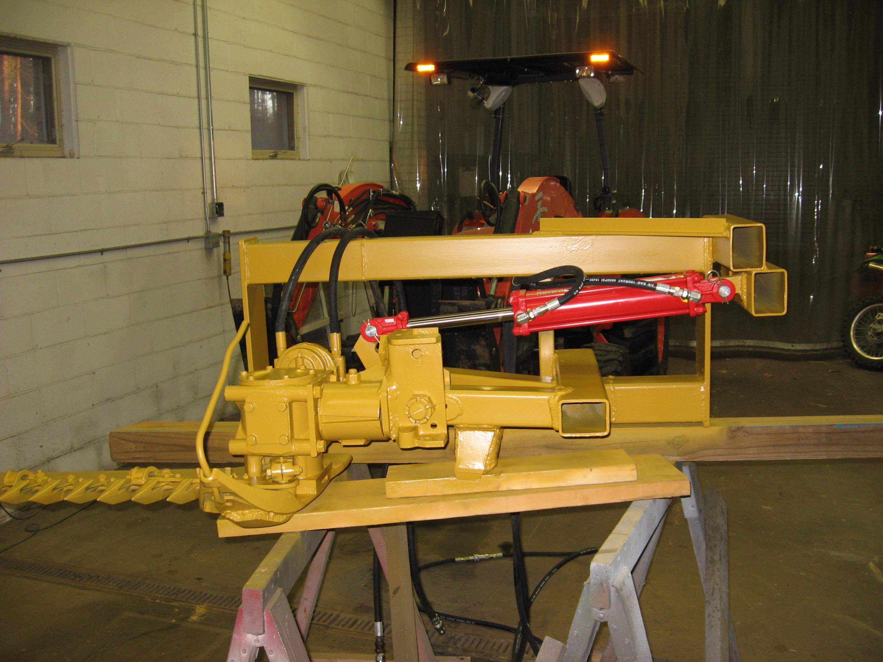

I have the same situation around my pond, it takes a good $10.00 per hour man 8 hours to cut pond **** and twice a year. I ended up making this.
I have about $ 400.00 in it and more hours than I want to count. It also trims trees and bushes up to 20 feet. I have a video off it in action on my phone but it will not transfer says file is to large. It is by far the best attachment I own.

Man that is a nice rig. If I had more levee to cut I would definitely be in the market for one of those.

Very nice and seems to be well thought out. I really like your putting in on the loader where it is up front and easy to see what you are doing......but you knew that. Grin
The hydraulic pump to drive the wobble box ought to make the drive nice and smooth. Did you use a regular length sickle or shorten one? How far does it stick out from the tractor's wheels? I assume the slope is locket to and set by the cylinder, and the height by the loader. Do you have a float on your loader valve and if so how does it work.....aka does is slide across the ground as hoped or try to dig in due to weight? Where are the remotes located that power the unit? Using the ones on the rear of the tractor and just plumbing forward?
