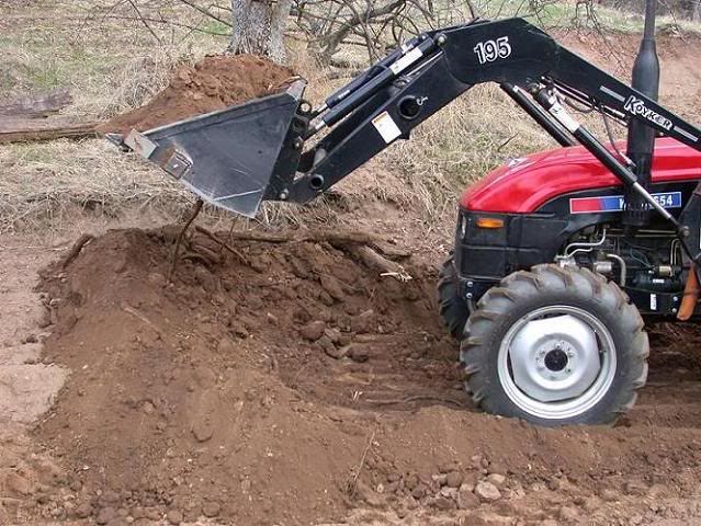

I have a 14LA FEL bucket 68" Q/A
Am looking to strenghten the bucket so I was leaning to the cutting edge for $250. Don't know how much the tooth bar goes for any ideas?
currently using the loader for clearing --would this be a concern for the tooth bar --taking large trees out with stumps by force of FEL -would the teeth break?
Which one would you reccomend?
Thanks

A toothbar would be the hands down favorite. It is just so much more versitle when it comes to digging and clearing types of operations. They cost anywhere from $250 to $350. Your FEL and or bucket will bend/break long before any tooth on a toothbar would if you are attempting to take out stumps with a smallish 14A FEL.
There have been literally zillions of posts here debating the goodness of toothbars with plenty of good points and almost no bad points. You might want to do some searching and reading.
