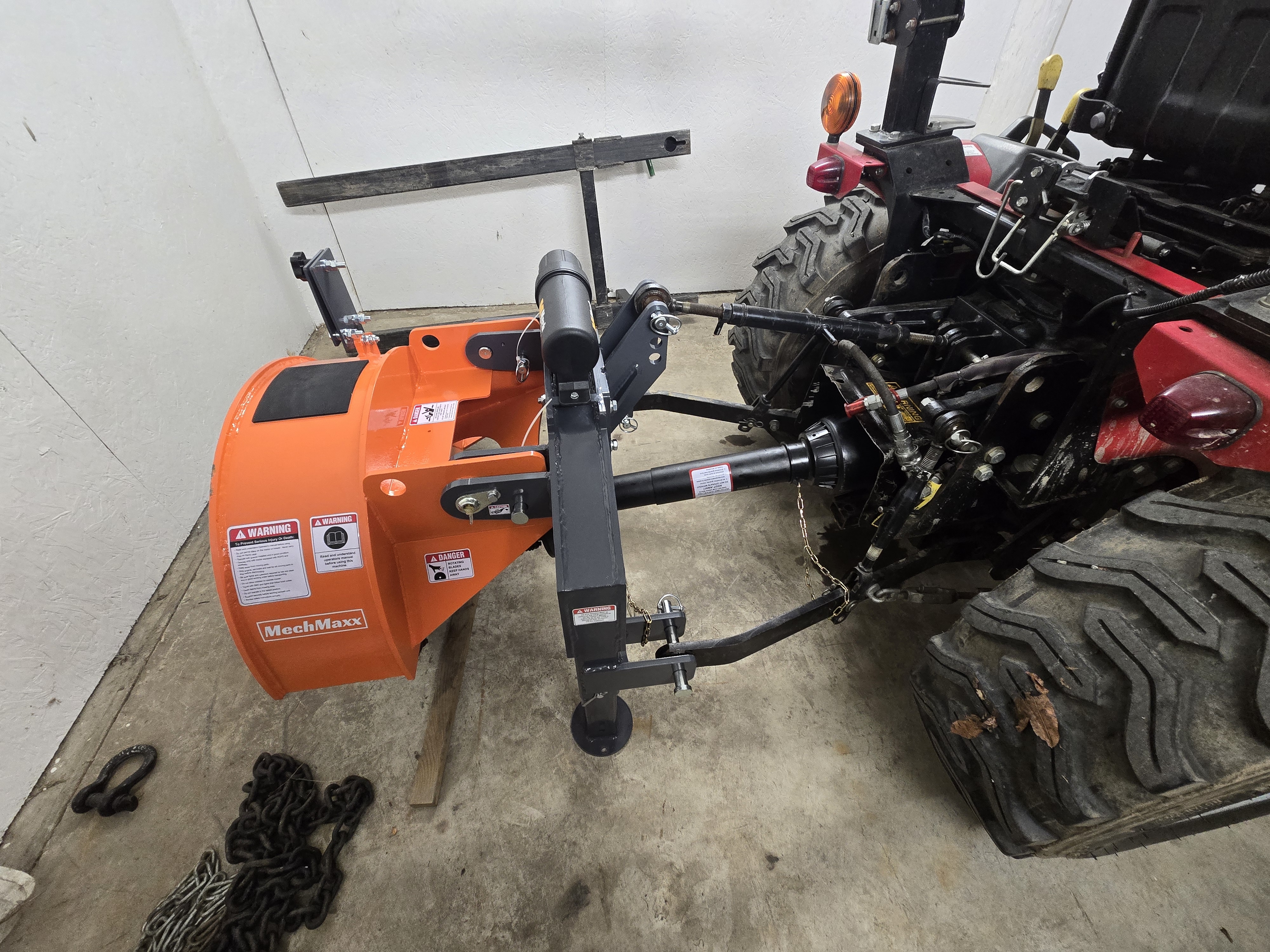

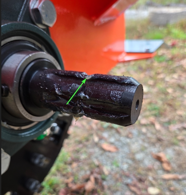

I bought a stump grinder, need to cut pto. I want to double check my numbers.
pto lock to stump grinder pto lock is 33 inches. the shaft does appear to be 34 inches.
Based on this. I should cut 2 inches off both shafts and shields is this correct.
and is the lock, the indented part of the pto shaft? green arrow area.

   / Cutting a PTO shaft. I am a virgin. #3
Line the two halves up side by side & see the overlap. Recheck the overlap At full up & full down (side) extensions (you're looking for the longest & shortest distances). You don't want it coming apart (too short) nor do you want it binding (too long). More overlap is fine, as long as there is no binding when the shaft distance is at its shortest.

   / Cutting a PTO shaft. I am a virgin. #6
There are a lot of methods for determining how to trim a PTO shaft. Regardless of the method used, do some very careful, slow, testing to make sure you got the length right. You may have to remove the safety covers, but SLOWLY raise the three point as you watch the length of the PTO shaft. You do not want the length of the shaft to bottom out before you reach full height with the three point. If the shaft bottoms out before you reach full height you have the likely potential to cause major damage to the rear of the tractor.
I realize that you may never need or intend to fully raise the stump grinder, but no sense in having a potential accident waiting to happen.

Thanks doug.
I successfully did it. (Installing it on the actually grinder was more work then expected).
