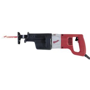

These work good for that, a lot more money tho. :eek:

For a tractor owner, a Oxy Fuel torch is the most versatile tool. From cutting metal to being able to heat and bend or loosen rusted fasteners.
For purely cutting, the sawzall or the milwaulkee metal circ saw would work.

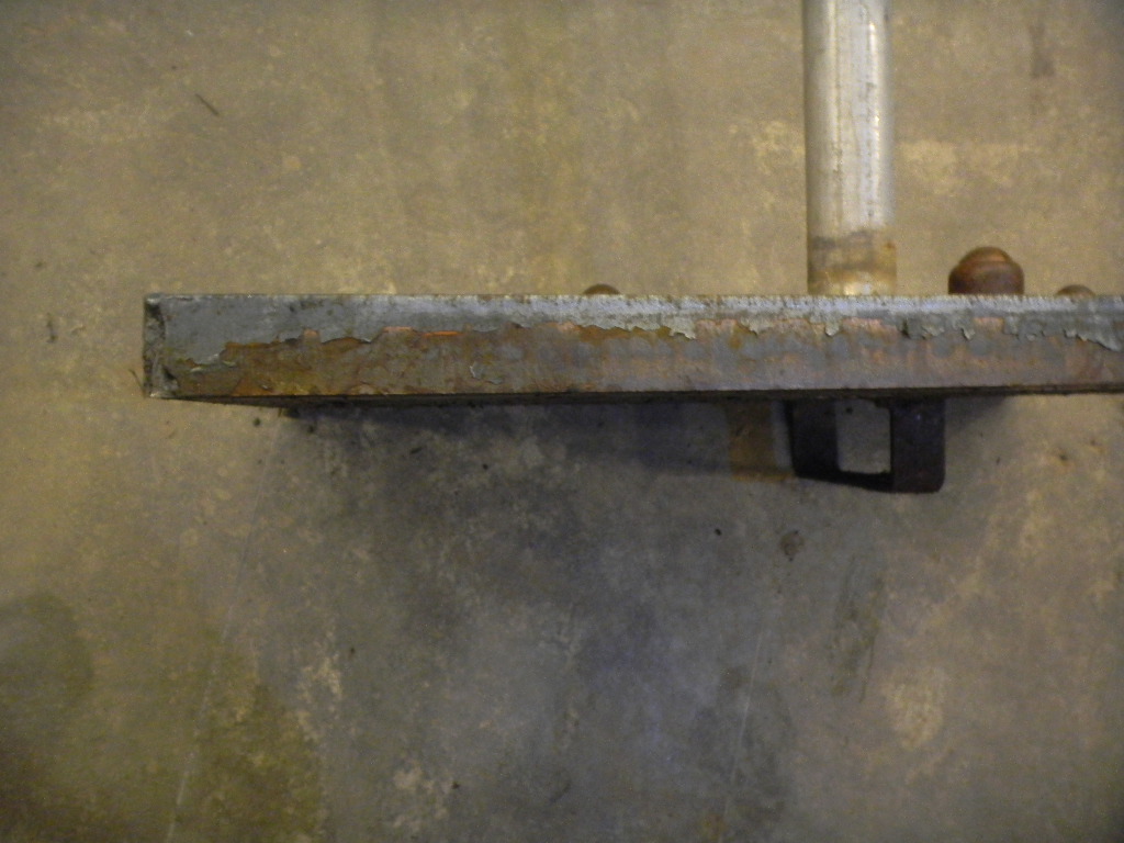

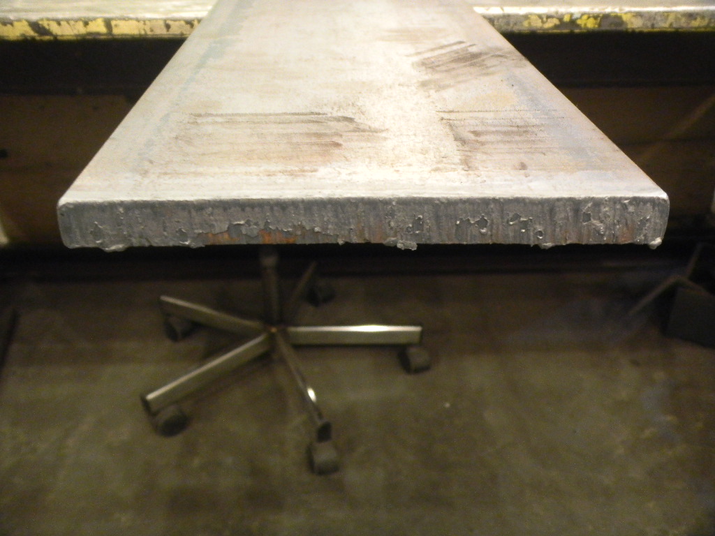

If you go with a torch, use propane to save some money. Takes a little longer on the preheat, but does make some nice cuts.
   / cutting a little steel #10
I've heard of using propane, but never done it. What pressure do you set the regulator at for something like 1/4" mild steel? Same pressure on Oxygen as the acetylene set up? Same tip?
