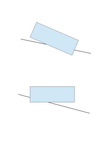

I have some sloping land I want to cut ditches across to help with water runoff.
All I have to use is a box scrape.
Assume I’m driving left to right.
My question is should I drive on the high side and tilt it to the right or drive on low side and tilt the left side?
   / Cutting a ditch #2
Regardless of travel direction,low end (digging corner) of blade should be up-hill. Reason being that front of tractor will be pulled in same direction as resistance created by blade.
   / Cutting a ditch #3
That will depend on the profile you wish for your ditch, especially using a box blade;
with the cutting corner on the uphill side you will have a flat ditch,
with the cutting corner on the lower side more of a sharp containing ditch.

May need to be on downhill side to remove dirt easier at first. Then uphill side to get the ditch bottoms grade the way you want it.
Thanks.
Just what I needed.
