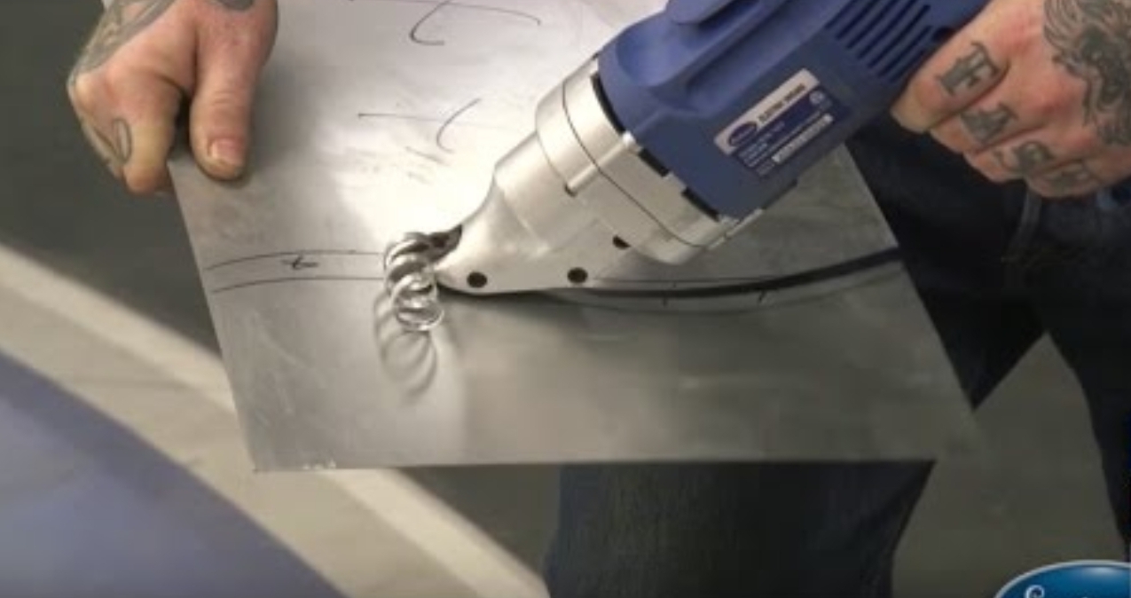

But again, it's all about the length of each cut. I can make a 12-18" (maybe up to 36") straight, clean cut with those shears in less time than it would take to set up for a circular saw cut. I got to where I only used the saw when I wanted to cut longer (up to 13') panels lengthwise.
Another option you'd have to test on some scrap ... You can score (with a razor knife), then bend and snap 29G roof panels. I don't know if you can do that with 20G Galvanized.
One more thought. With a circular saw blade, you lose 1/8" minimum with each cut. Shears mean no loss of material at all.

For 20ga, the Harbor Freight shear would be nice. I use a DeWalt shear 18V Cordless 18 Gauge Swivel Head and Shear Kit - DC49KA | DEWALT for some things like that. If you're figuring closely on the material, be aware that each cut costs about 1/4" of material to make the "Spam can strip" of waste. The shears Diggin It used can cut on the line and require no extra material. Cutoff discs, circular saws and plasma do use a little.
Also use a cutoff disc in an angle grinder sometimes. Works best if the disc isn't plunged full depth.
Jig saw works OK, but 20ga is a little thin and the metal needs good support. Works better than a sawzall.
I've had better results using my plasma cutter on black metal. It needs more cleaning / attention when used on galvanized. Plus you shouldn't breathe the smoke.

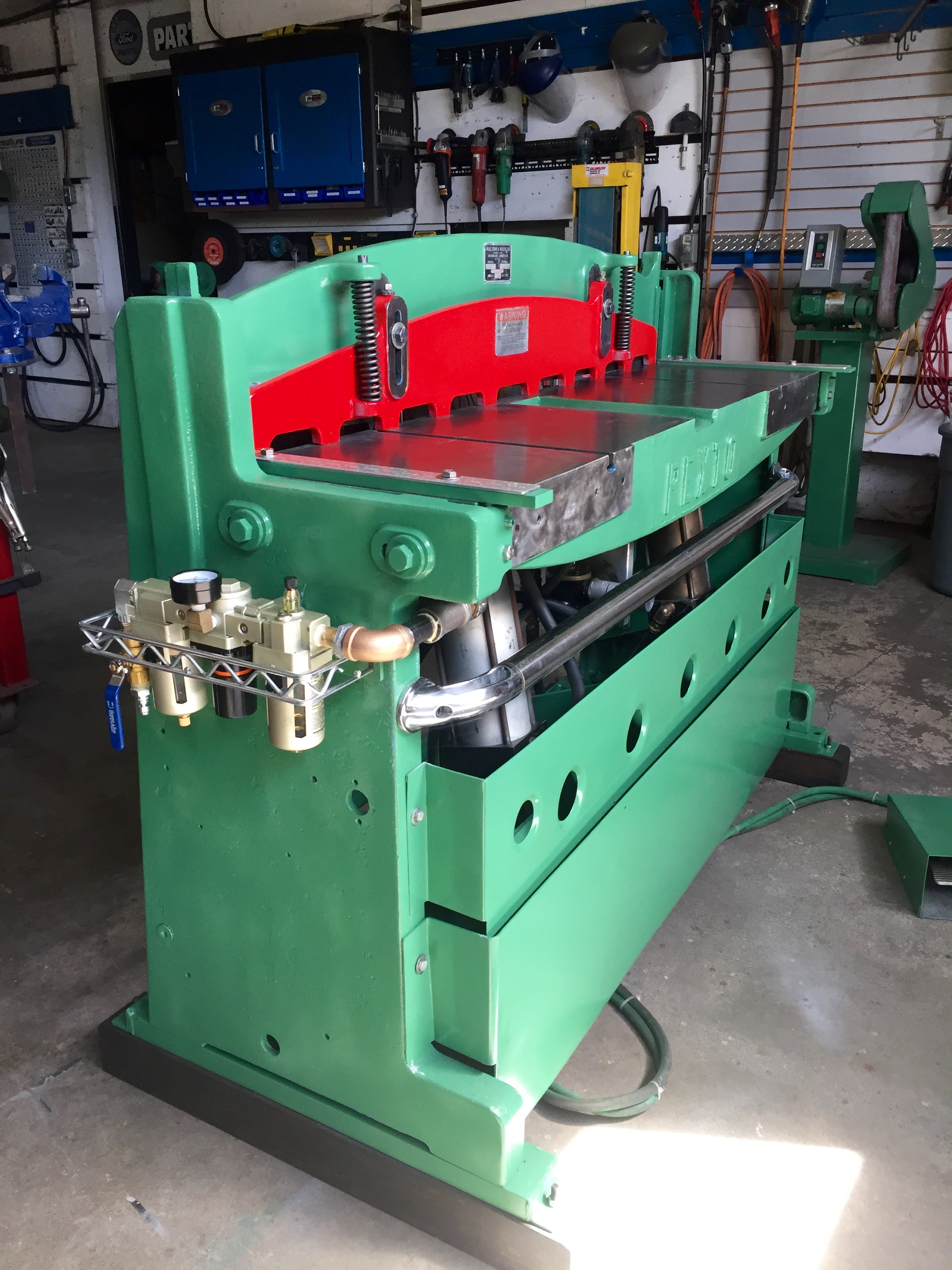

Well, you are about 3 hrs away to Brighton, but I have a Niagara stomp shear That I'm pretty sure goes 4'
But my message is really that you should try to locate a stomp shear either for sale or rent. Or, buy a used one, use it, sell it after you are done ! I cut windmill blades with one to restore old water pumpers.
