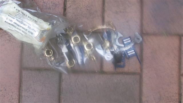

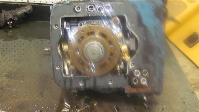

Well I found why the pump was rattling.:smiley_aafz: Its the 4th 140 thats done this that I know about and all near the same hrs

Hard to tell, but looks like a roller bearing failure. How many hours are on your 140?
/ Cutter pump C140/FTX140
#9
I would be pure speculation to the cause, the rotating group is so smashed up we cannot pin point to any one thing.:(
It's the 4th one of these to do this in Australia that I know about ,all about the same hours
/ Cutter pump C140/FTX140 #10
Have you ever changed the filters on this unit? I presume their are charge pump filters and if they start to plug it can cause this type of damage. Suspect one of the slippers failed and scrapped the rest of the unit.
You will also have to inspect and probably replace all of the hydraulic motors on this unit also. All that debris went somewhere.

Tony,Glad to hear the ret of the machine is OK. All to often one unit fails and it wipes out all of them.
Hard to tell from the pictures but do the slippers have rolled edges Vs being smooth wear they contact the swash plate.
Do the slippers have wear on the underside where they contact the slipper retaining plate.
If yes to the above it sounds like you may be experiencing slipper lift under certain conditions. This can be from excessive speed, cold oil, weakening load springs, or a combination of factors. This will cause the slippers to wear unevenly, puts extra stress on the retaining plate.
I f you know of 4 machines that have failed with similar hours and the same exact failure, I would looking at trying to determine why.
Out of curiosity do you know what brand of pump this is? I.e. Sauer Danfoss, Rexroth, Parker, etc.
Model number of pump:
what the operating conditions are? Operating speed in RPM, Operating pressure, Oil type and weight.
is this closed loop hydrostatic drive to cutter head.
With this info, someone might be able to provide you with a possible cause of failure.
Roy

It is an Eaton 6422, max RPM 2500,oil Castrol AWH68,pressure was reset to 3800psi down form 5800psi on delivery, and closed loop to cutter head.
/ Cutter pump C140/FTX140 #17
Tony,
I looked at the specs on this pump and the only thing that is even borderline is the pressure setting. The catalog spec is 240 bar (3480 PSI) continuos. Input speed and oil are both fine.
Without putting transducers on your machine while in service, it would be pure guess work as to what is causing the failures.
best of luck
Roy

Intermittent pressure rating on that pump is 5000 PSI or more. I am not saying the pump was incorrectly applied I am saying some operating feature seems to be causing premature failure. The fact that four of these have failed with similar hours makes me question what is causing this. Most pumps use 10,000 hours as a design point for their bearing life. So if you are only getting 3000, this again points to some application or operation feature that is causing premature failures.
I suspect Eaton has 1,000's of these units in the field so if they where junk there would more than four failures being reported.
Roy
